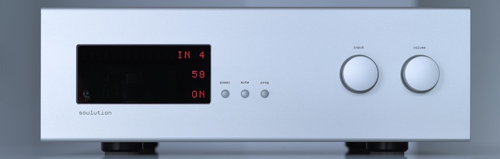

I see 3 inductors, 3 ICs (two with heatsinks as mentioned), two relays, and a bunch of R and C. This does not look like it could be all that wideband as is alleged.

I see 3 inductors
The inductors are also in each of the input stages after the three inputs, so six times total for stereo, part CM types.
The Burr Brown without a heatsink could be a servo.
(the coil addition referred to both the number of inductors, plus the ample use of Hamlin reed & NAIS relays, plenty of the both of them residing under the 720 boards i posted )

btw : the 720 phono boards are used in both the 720 preamp and the 750 phono stage. At $25K/€34.9K retail i'd expected at least a separate batch with 750 print.

I see I lifted the wrong spec for slew rate: it's claimed as 400V/ns for the phono preamp (330V/ns was for the power amp). I would also suppose from the specifications in Valin's text that the cited 100dB S/N ratio is with the input shorted. I'd like to know what it measures open.
So, are there enough reed relays in other parts of the circuit to make them the plausible switches for gain control?
