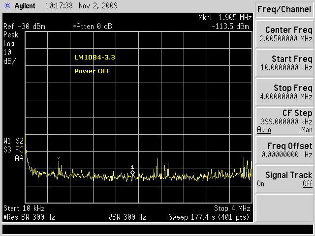

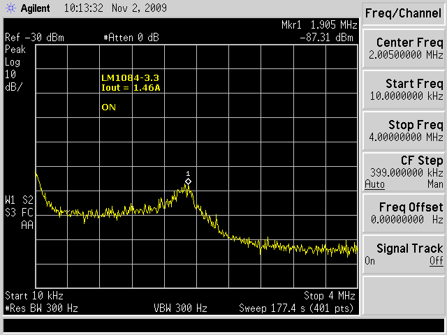

Spectrum measured at power supply board output teminals. 10kHz - 4MHz. PSU loaded by 1.46A output current, and with input mains voltage switched off.

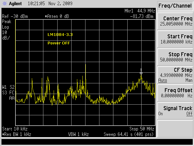

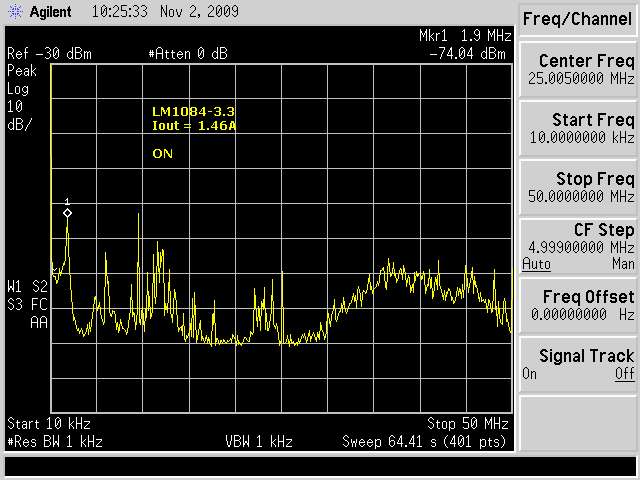

Same for BW 10kHz - 50MHz. We can see a lot of RF pickup even for the PSU switched off.
0dBm means 1mW into 50 ohm, i.e. 224mV approx.
As expected, so I must ask: so what's your point? What are the conclusions of your measurements?
That's before even asking about what and how this was measured, etc...
My point is to show that 'clean' power supply is an issue. It needs careful design, both circuit and box/shielding.
The PSU is pretty conventional, EI 30VA transformer + SB260 bridge + 2200uF + 100nF + LT1084-3.3 + 220uF + 100nF.
The signal is analyzed at PSU PCB DC output terminals. There is no shielding enclosure for the PCB. 3.3V PSU output is loaded by 2.26 ohm.
The output PSU terminal is also connected to RG-58 analyzer cable, this cable terminated by 50ohm analyzer input impedance.
