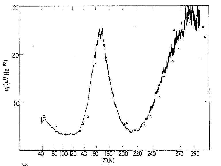

That graph, in NO WAY looks like the graph in Buckingham's book.
From your statements, that's quite certain. So I'm not exactly sure what you are talking about. Their test results appear to be quite smooth and continuous.
They show a minima at about 210K, a peak at about 165K, another dip at 110K, seemingly consistent with your verbage. But H and K's graph of the individual frequencies vs temperature I posted previously doesn't match your verbage with respect to weird behaviour..so I certainly have to question the odd hypothesizings you provided.
Did Buckingham massage data from two sources?
Can you produce the graph you speak of?

I do not understand your "not smooth" comments. The graphs in Haslett and Kendall are quite smooth and continuous.
What exactly did Buckingham print??

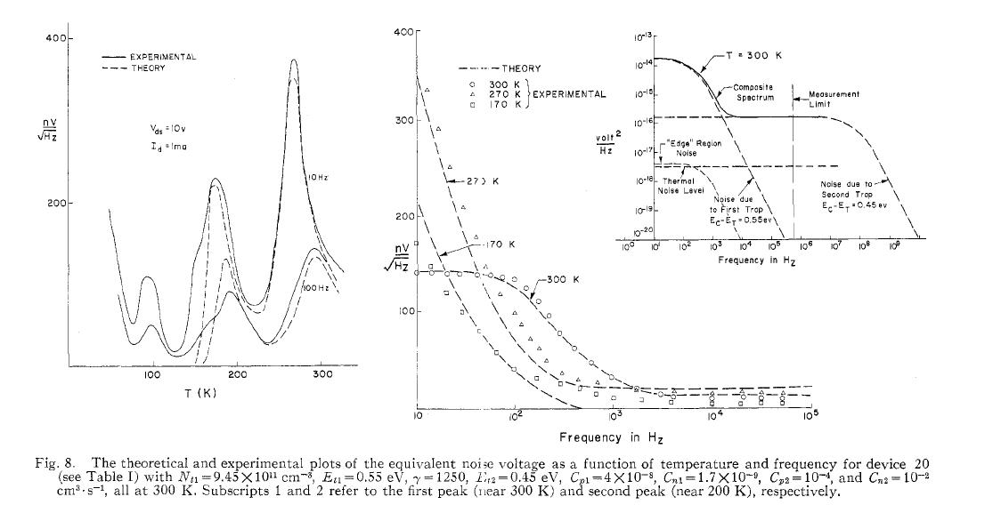

This is the classic generation-recombination noise behavior, if you want I can post dozens of plots from many vendors. It is not per se 1/f noise but a special case of a dominant type of recombination center with a time constant that has an activation energy. You can literally change some devices 10 degrees and get 100X the noise. It's spectrum is Lorentzian with a time domain apperance of a random telegraph signal.

I have dozens of these plots too, it does not always require cryo temperatures. I just checked Buckingham and his plot is spot frequencies with a temperature sweep taken from H&K. Mine are .1-10Hz noise with a slow temperature sweep, different ways of looking at the same thing. BTW I posted a plot in the Pass forum of a beloved 2SK170 with GR noise. These contaminations and defects are something that folks try to eliminate and we have been getting better at it, there are many JFET's with little or none of this.
Looking at graphs in the 'Siliconix FET design catalog' July 1983 of various Nchannel jfets that I have used over the decades, most are 'smoothed' graphs, some are somewhat irregular, which says that something is going on that is not smooth, and my own Quantech measurements have shown this problem with different devices and geometries.
However, H&K's graph on p. 130, of Buckingham's book is spectacular, and was put there to be so, in order to show the mechanisms that can make excess noise greater in some devices, and at some temperatures, that some predicted average. Still, it appears to be a real and direct measurement of an Nch jfet considered 'low noise' at the time. This is stated in the text.
Please look up the references for further clarification.

So I actually did go to the source of the information, only to find the normal nice graphs expected, not some weird discontinuity thingy. That is why your statements were confusing, as they were inconsistent with the base data being referred to.

Jneutron, the graph put into Buckingham's book was chosen to show problems with temperature in predicting 1/f noise. If your Brookhaven library does not have a copy, will why not rely on Scott's input? IF you have a fax, I might even send you a copy of the graph that I cited. It looks like the Alps, not any gentle slope.
Why you quibble with me on THIS thread, when low noise jfet electronics is continually cited here, is beyond my understanding.

Here is one of their plots with several ways of looking at it. Buckingham's plot is like the one on the left. This stuff has been worked on since 1964 (Sah) gold is not a contaminant of importance anymore, it's known as learning how to do stuff right. Note the 300K plot on right, just like a recent 2SK170.
