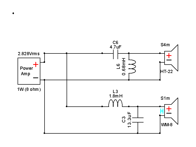

But we need a takeaway from all this. I went on record as saying I thought this Marco_Gea design was very nice indeed.
http://www.diyaudio.com/forums/multi-way/147632-classic-monitor-designs-25.html#post4428857
Marco reckoned this 91dB PA bass speaker with a Monacor HT-22 cone tweeter was very nice, particularly at the price. I built something similar myself, just to try out his ideas.
The only criticism I have of it was the slightly mushy and fatigueging or TBH, "harsh" top end. I thought this was due to the lowly second-order filter. But I now know it was the rising impedance on the tweeter. Marco_Gea's filter needs a 7.5R plus 1.5uF Zobel to win a cigar. My own filter needs some shunt resistance, aka an attenuator, on the tweeter. I shall try this, because LR2 can sound extremely good and involving.

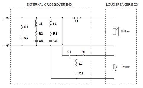

Quite so.
Ps. Many crossovers have a second option/version for a flatten impedance, is it the same as in your thread?
Not quite, if I understand your question correctly. In my approach (philosophy) I make the amplifier see the conjugate part first and directly, and before the component(s) that is the filter. Note that L1 does not have a Zobel.
With the tweeter high-pass, it is a little harder to see that C1, R1 and the tweeter's VC are all in series when in-band. The LC of C2 and L2 are tuned several octaves below and at the tweeter's Fs. So what constitutes the low and high passes elements are all kept in series and things like parallel Zobel are avoided.
I can recommend reading Esa Merilainen's book on Current Driving Loudspeakers and although I suspect he won't see it completely my way (and that's OK, we get on well) he does go into why Zobels should be avoided, keeping all elements in series.

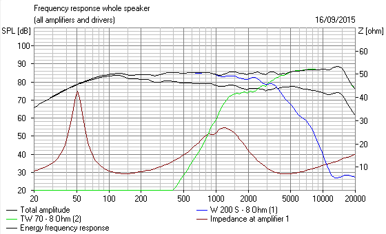

I've been thinking about your ideas today, Joe. As ever, interesting. And we must thank you for sharing them so freely. :cool:
I'm a bit muddled here, because I get the feeling you have modified the polycone bass Usher S-520 core crossover to your own taste? :confused:
I'm also slightly unconvinced by your notion of speaker voicecoil damping being irrelevant, but clearly you are building the damping into the crossover, which seems valid to me.
I also don't buy your dislike of shunt components. A series filter is nothing but shunt components, and seems Norton-Thevenin equivalent to me!
I've modelled your crossovers before. It's got to be a very well-behaved bass to get away with a single bass coil, hasn't it? Most of them tend to bad cone-breakup with no resistive or RC shunt IMO. Maybe you get away with it with a polycone bass. KEF did in the ancient KEF B110 Cresta.
And TBH, I've had some bad experiences with Fs tweeter notches in the past, especially KEF acoustic butterworth, but see their strengths in a near ideal 12 or 18dB slope.

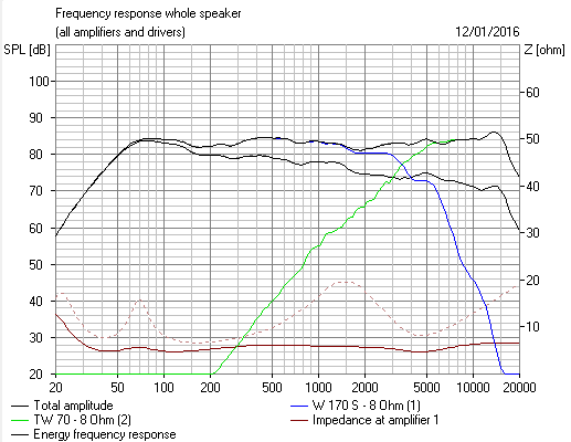

Anyway, here's where I have got to in the (rough and ready) modelling. The dotted line is the fairly benign impedance of the core filter for a 6" paper bass. The solid line is your flattened impedance. Very nice 12dB/octave slope on the tweeter. Flattening a reflex is actaully quite hard, being a double peak, but Joachim Gerhard explained how to do it in one of his interviews.
SpeakerBuilding.com - Interview with Joachim Gerhard of Audio Physic, Page 1
My own feeling is the high frequency impedance flattening is going to be the most audible part. I'd do it with a 7.5R shunt resistor after the tweeter filter, you'd do it with a 8.2R/2.2uF Zobel before. It gets to the same place, IMO.

Your CORE FILTER here is quite straightforward:
524613d1452648525-joe-rasmussen-usher-s520-current-compatible-crossover-joe-rasmussen-usher-s520.jpg
Simple bass coil and second order Fs notched tweeter. 1st order/ 6dB bass and second order/12dB, but maybe 4th order/24dB tweeter acoustically. That has a good pedigree in "sounds good" audio.
The fly in the ointment is that (voltage) amps don't really behave as a straight wire with gain. In fact they are more like this:
So while I like what you do a great deal, it's the high frequency effects which interest me most. Because the open-loop transistor gain falls dramatically as you get near the top of the band, so voltage feedback doesn't work as well. I suspect that most amps behave as advertised in the bass and 2KHz midrange.
