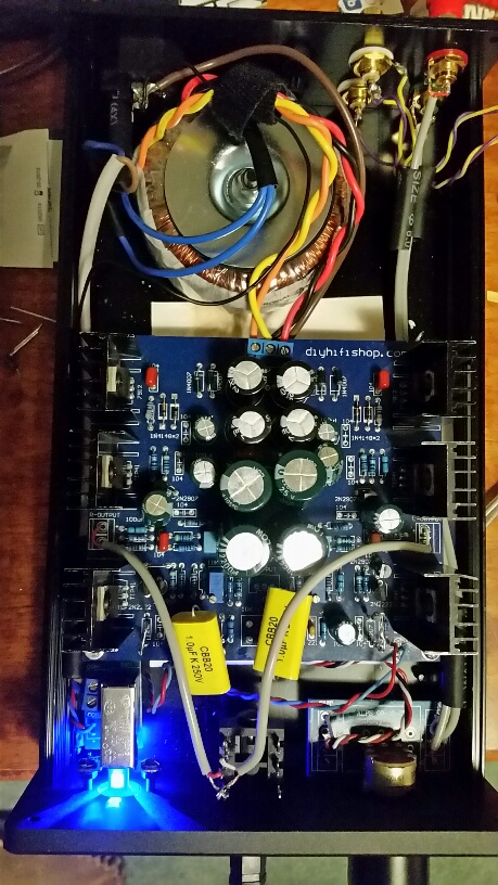

I'm building the JLH amplifier based on ebay PCB at the time (see following photos).
Note: I use a separate power supply and a separate input stage (loudness control). Therefore, the bridges on the JLH-PCB.
I also have some problems with the dc offset. :(
My idea was the two power transistors (Q3 and Q9 / Q4 and Q10) (all TIP41) thermally couple. Furthermore, the 2.7 volt zener diode have replaced with 4x 1N4148. These four diodes are also thermally connected with the heatsink. The temperature dependence of diodes and transistors counteract, so that actually a more stable (smallest possible) DC offset should occur. But my measurements show a not so good performance. I ask myself why. :confused:

As I've stated before, these amps are NOTORIOUS for constantly fluctuating and high DC-offset.
You can go to the trouble of thermal coupling different components and you're still going to have high and fluctuating offset.
A simple servo will take care of it. My examples stay within a couple of millivolts.
