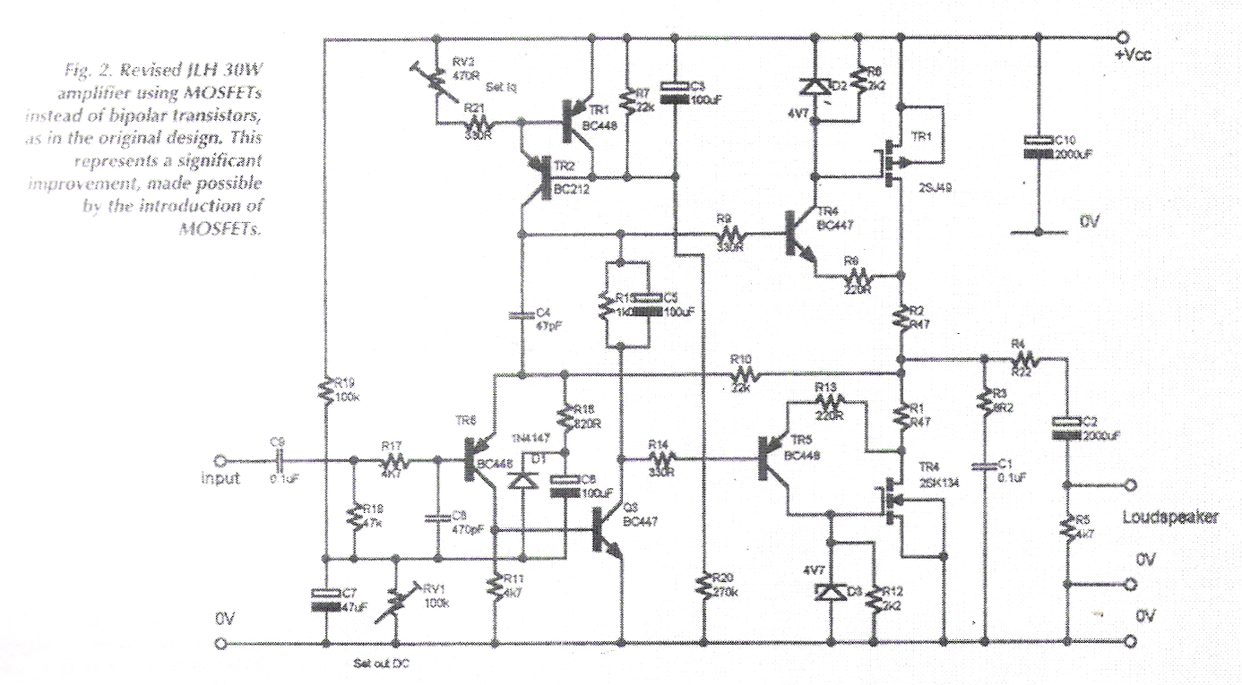

Folks,
to first answer the questions you implied, then those you asked.
I agree.
I bought Bob Cordell´s book and wanted to go through my design in analogy to the way he describes. Unfortunately I stumbled over the first stage, which I now know at least the name of. Reading an endless thread on matters that are 98% nothing to do with this subject did not promise anything. The class-A business is about an entirely different subject and has with the simple 30W amp just the first stage in common and the author.
Absolutely. Please appreciate that I never planned to have my problems with this amp solved by others, taking a shortcut. This was never my question. But now you offer specific help and I gladly accept.
Please appreciate that I just asked one question regarding the first stage. That is not related to any observations.
> What is your 'reactive load'?
As specified by JLH this is 8Ohm/2µF. The amp was stable BTW with 0.1µF
>What active devices are you using?
Compound transistor/ lateral mosfet pair, these days allegedly called "sziklai pair". Pls. see schematic for more.
>What is the frequency of the oscillation, and the amplitude?
Powering the amp up with a variac and a bulb current limiter I noticed HF fuzz riding on top of the sinewave. From memory, this was not as high frequent as I expected (MHz), rather below 100 kHz on a 1kHz wave.
>What quiescent are you using?
I adjusted the quiescent current to 100mA as recommended by JLH for lateral mosfets, but then forgot to plug the bulb limiter in again and on the next power-up the output devices blew. I now wait for new ones.
>What are your compensation values, and where?
Typical JLH compensation directly on the input device. JLH claimed total stabilty with 47pF and perfect square wave behavior.
>Can you show us a picture of both your schematic and your implementation?
attached. I used the 2S type transistors for the preamp stages and the 2N types for the output pair. In case you wonder about the funny transistor sockets. These are my "universal" footprints that let me accomodate any transistor during evaluation.
>And to add, measure all the base/emitter voltages on all active devices.
Currently not possible. Waiting for new output devices.
The amp ran for hours with an actual speaker, just failed the reactive test and thus is not unconditionally stable and reliable.
Reading in Bob´s Book I immediately detected a few possible layout shortcomings like insufficient local decoupling.

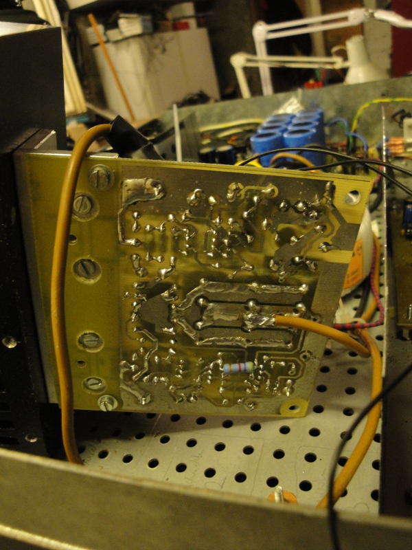

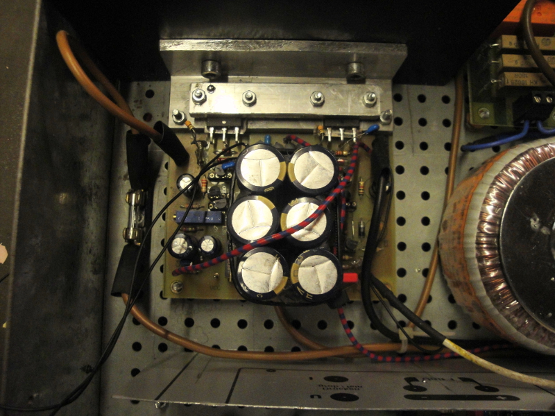

OK.
I made pictures from the top and bottom. I believed this can be seen from the printouts in the PDF and did not think of a photograph. The PDF has several pages.
The output devices are directly mounted to the pcb and transfer heat (hopefully well) to a heatsink via a 5mm aluminium bracket. Pls. see photo.
These are, as printed in the PDF, 2SK1056/2SJ160, obtained from reichelt.de. I have heared about fake units, but I have no method of verifiying their validity. They sure don´t have "renesas" printed all over them, but that alone would not have arisen my suspicion. They were the only company that seemed to stock them. Note that on the website they only show a generic picture
The mosfets used are successors of the obsoleted original types and may have different behavior.
None of the semiconductors uses are available today, only claimed replacement types made out of unobtainium.
In a later article JLH said, that his choice of low power transistors was mainly down to the fact that he had stacks of them at home.
In a similar amp he then recommended more generally "low power transistor, 100mW" or "medium power transistor 600mW" or similar.
I took the ones mentioned earlier for voltage capability and power (2N5551), resp. 2SA970 for low noise. (Incidentally, Geoff Moss used the latter in this later 10 watter...).
But in sum they may behave not as expected and require a thourough analysis.
The test load is a common wirewound power resistor with a 2µF film cap in parallel.
JLH always uses this reactive test load to proof stability on square wave inputs. My rendering of the amp may have just worked with the speaker attached, however it may have exhibited ringing or similar.
With lightbulb I mean "the poor man´s current limiter", a 100W bulb in series with the mains.
Even with zero input signal the bulb would light up considerably more than without the cap, indicating there was some excessive current consumption. This was dramatically increasing as soon as the output was excited.
Let me know it here is any more pics needed.
