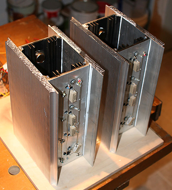

I've glued my pieces of heatsink together - added some shiny silver aluminium heatsink pieces to the black painted heatsinks that the devices are mounted on. I'm trying to use what I have to hand - it all has to come out of my junk box. I filed the edges of the black heatsinks to remove the paint from where it contacts the silver pieces to improve heat transfer. I used epoxy glue - it actually has pretty low thermal resistance and it's good for over 100 degC operating conditions.
They ain't pretty and are awkward in shape and size. I plan to have them operating with the heatsink fins vertically oriented. I will allow air to convect up the centre channel - think of them like Didcot power station cooling towers

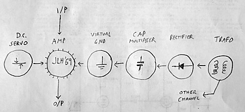

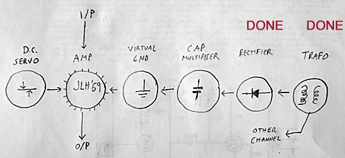

It's been slow progress but I've fixed the final design now, in my head at least. The overall architecture is shown in the attached. I'm going to start collecting all the parts together into one spot and this weekend I hope to cut up some plywood to make a kind of box for this thing.

So far this project has been about following the '69 design (apart from dual rail) and using up stuff I can find in my basement. I decided to plump for a cap multiplier for the power supply. For the pass devices I had a pair of small heatsinks off another old power supply retrieved from the garbage. Each heatsink sports a pair of ancient 2N3055's which I'll use in parallel. And I also have some ancient rectifier diodes from an old power supply, 1N1200's which look pretty darn rugged - they are chasis mounting beasts.

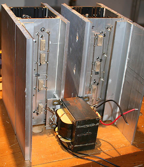

A bit more progress. I've added some angle bracket to extend the heatsinks on the outside - this will form the outsides of the chasis. The heatsink is the chasis. I'll make a front for it and a cover for the back. The back is where the power supply and amplifier will be put together. The front just has to look pretty.
I've added some angle bracket to support the trafo and installed the rectifier diodes into this bracket. This gives them somewhere to dump heat if needed (or they'll be warmed by the heatsink ) and it keeps them close to the trafo so that charging pulses are limited to short wires. The trafo is rated for 5.5 Amps; I'll only be needing 3A but I expect it will get warm.
Still gotta figure out how to mount the big caps, they've got nowhere to go to hide from the heat but I'd like to at least isolate them from direct contact with the heatsink. They'll also go close to the rectifier diodes to keep wires carrying nasty high current pulses short and sweet.

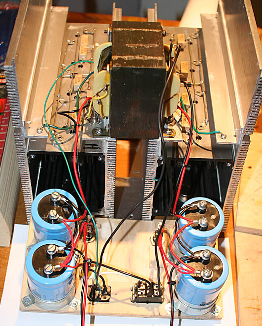

I had time to get back to this. I've created a small wooden panel for the back to which I've mounted the big filter caps, keeping them from direct contact with the heatsink. I've mounted rail fuses for each channel, a mains switch and a fuse for it and wired them up. I've also wired up the trafo and the rectifiers. It powers up just fine, giving me two separate dc power supplies. Each channel is made up of two-phase rectifiers instead of the usual bridge/4-phase and they're wired so that each pair of rectifiers is out of phase with respect to each other so neither channel 'sees' the other channel through the power supply - giving me dual mono. It's a bit hard to see it all in the photo, the wooden panel is lying on it's back on the bench in front of the chasis but will eventually be flipped over the top of the trafo and screwed at the sides to the heatsink/chasis. It extends only part way up the chasis, leaving space for additional wooden panels as I add more functionality to complete the project. Slowly, it's coming along. The trafo does buz a little, I may try isolating it from the 'chasis' with some rubber washers.
Next step I will design a pcb that will house a cap multiplier and virtual earth along with some heatsinks for the cap multiplier power devices. These will mount on another wooden panel.

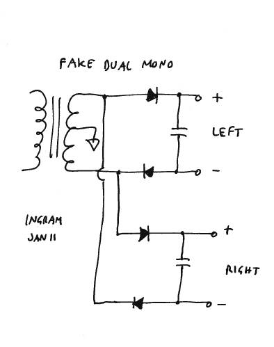

Hi!
Could you explain this in detail?
Maybe a drawing?
Tyimo
Maybe a drawing?

The way I view it, parasitic capacitances aside, the amplifier is connected to the psu transformer through the rectifier diodes only when these diodes are forward biassed and conducting. This happens at the peaks of the AC waveform. At other times the diodes are reversed biassed and the transformer is isolated from the amplifier.
In a 2-phase rectifier only two diodes are used and the transformer 'connects' to the filter caps to charge them up only once per full AC cycle. A full AC cycle (360 degrees) can be thought of as having one positive going peak and one negative going peak, alternating between them. Only one of these cycles will forward bias a 2-phase rectifier and the other cycle goes unused. So in Canada a 2-phase rectifier operates at 60Hz charging pulses instead of 120Hz for 4-phase (4 diodes or bridge) rectifier.
We can add another 2-phase rectifier connected so that it is forward biassed when the first 2-phase rectifier is reversed biassed. This means that each 2-phase rectifier takes it in turns to draw current from the transformer. Since the conduction of these rectifiers never overlaps they are fully independent of each other and behave as fully separate dual-mono supplies. In fact, they are arguably, better separated than a regular two-transformer dual mono supply. The transformer now has 4 diodes connected to it and will supply current charging pulses at 120Hz - the transformer doesn't see any difference between this dual-mono arrangement and a regular bridge rectifier.
The disadvantage is that you have a 60Hz charging cycle and so there is a longer time interval between charge pulses - larger voltage ripple on the rails requiring larger filter caps. And the ripple current rating of most caps is set at 120Hz so you need to derate it by around 85% for use at 60Hz.

I use the full wave rectification for each channel, in fact two FWR for each amp module, four in all, so that no rail 'see' another. I can confirm Hotironsmoke's post that this technique offers wonderful isolation and negligible intermodulation - all from one trafo.
