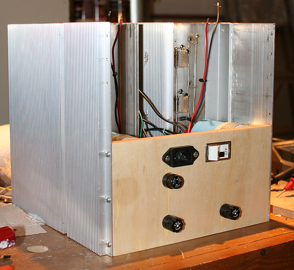

Joined 2009

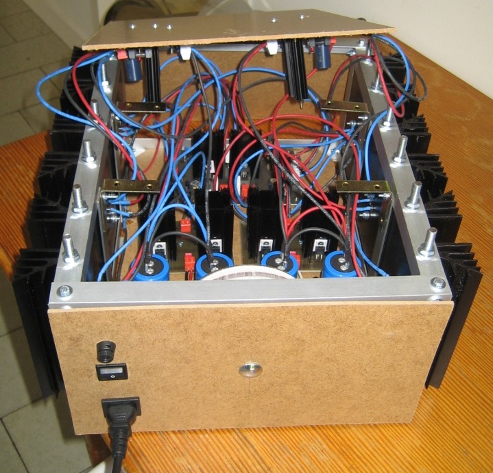

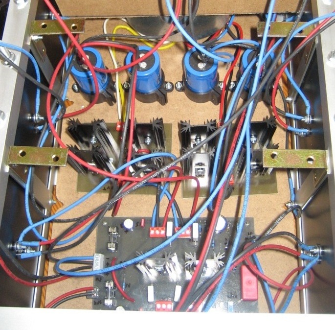

Well, a couple of short wires added and it's all happy as a full-wave rectifier. I've added an 0R51 into the positive rail between the two big blue filter caps of each channel. The rectifier still 'sees' two big blue caps in parallel, being the first big blue cap on each channel. Yeah, I wimped out on the half-wave rectifier, maybe another time. And yes, power switch is on the back panel. This is a Class A amp, it won't be constantly switched on and off so I'd rather hide the switch at the back and keep mains AC wiring in a small space. I've got earth wires screwed to 4 separate spots on the chasis for safety.

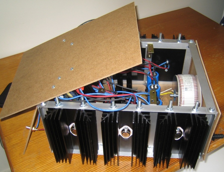

Photo shows the wooden panel flipped up and screwed in place. This is the back of the amp starting to take shape. The next strip of wood to be mounted on the back will be the cap multipliers, plenty of work still to sort them out. I figure that those big blue caps at only 11,000uF each aren't going to be enough for a quiet supply on their own. On the same board I'll include the virtual earth which will have rail to ground bypass caps of 10,000uF per rail per channel, each bypassed by a 2,200uF Nichicon MUSE gold cap.
Above the cap multiplier module there'll be a gap at the top for another wooden strip which will hold the front end of the amp.
It's pretty crowded in amongst the trafo and those big filter caps and I'd like to run a check on how warm it gets when loaded. Before I can connect a dummy load to the power rails to do that, I need to install suitable fuses. The rail fuses in there right now are 250mA as that's what was in the holders when I pulled them off a scrap item. Once I've found a pair of 2A or 3A fuses I'll be able to run some serious juice and see more clearly how ugly this thing is.

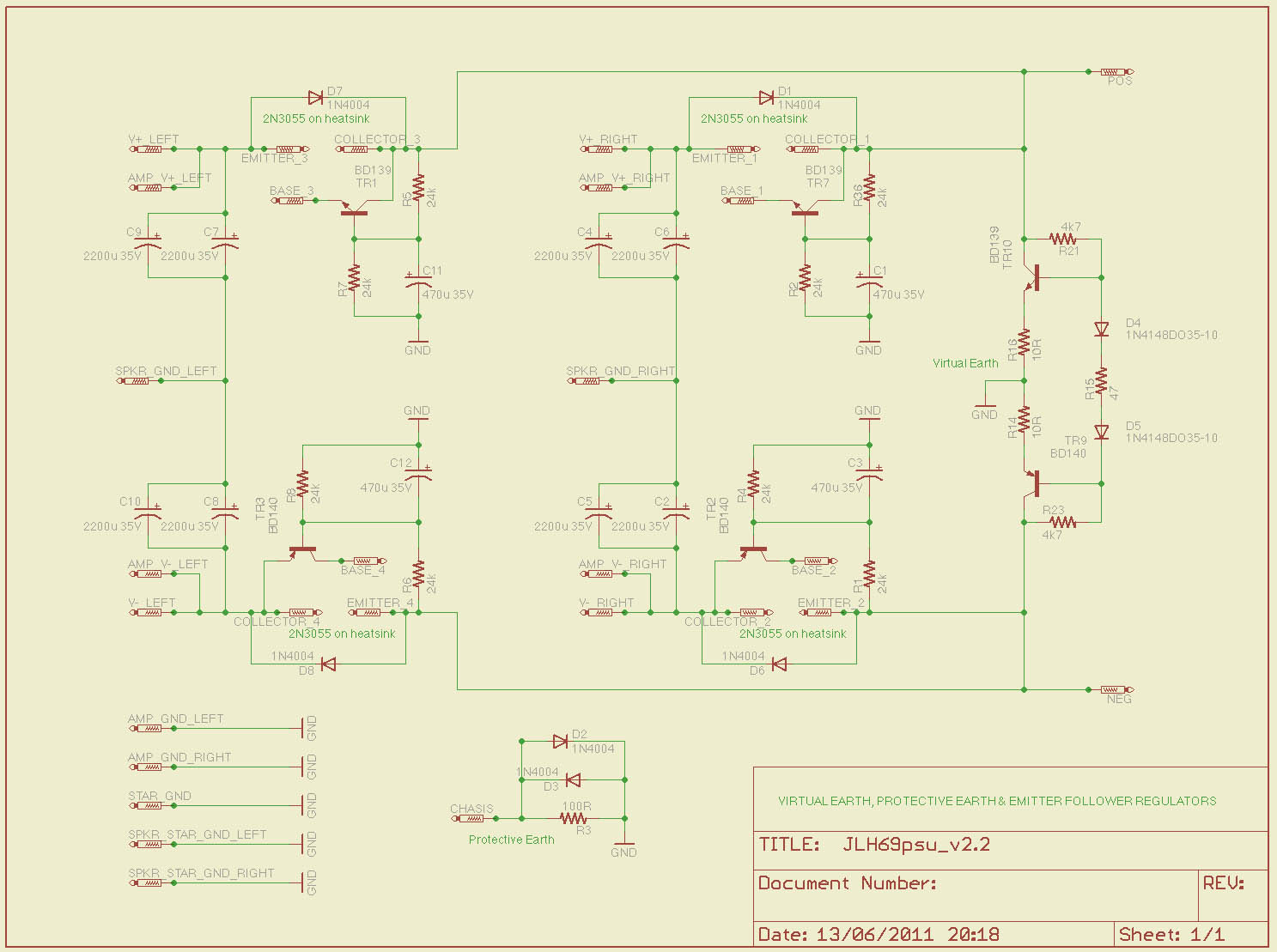

I decided this project is an opportunity to learn and do something new - namely use a proper pcb layout software. I picked Eagle because I have a Mac and it works on a Mac, it's a very usable tool and did I mention it's free within certain limits
First off is to set up a schematic of the power supply - namely the virtual earth, the protective earth (which keeps the signal ground isolated from safety earth in a safe fashion) and the emitter follower regulators (cap multipliers to you). There's an emitter follower per rail per channel, so four in total. And I happen to have two small heatsinks from an old bench supply with a pair of 2N3055s on each one - perfect for the job of using up my junk - which means the pass devices are off-board.
The rectified and filtered dc power enters from stage right on this schematic.
I've attached an image of the schematic, comments welcome.

The first thought that comes to mind is your capacitance multipliers are throwing away roughly half your supply voltage by virtue of the 24K resistors configured as a voltage divider - did you really mean to drop the voltage by half..
The active supply splitter seems to argue for a full wave rectified supply with center tap, simpler and more reliable in the long run.
The addition of a single additional transistor, a zener, a small cap for miller compensation and a couple of resistors to each of your capacitance multipliers would give you an actual discrete voltage regulator if you wanted a really low source impedance, a well defined supply voltage and less noise.. (Put a reverse biased clamp diode across each output to make sure they start if you do this..) I did something similar with a darlington and a somewhat more sophisticated VAS, it worked well.

Lose half the supply voltage ! well, then we don't want 24k resistors in the cap multipliers. I want to limit the drop to around 2V to 4V at most, so I'll have to recalculate.
However, I have already converted over to full phase recitification so we're ok on that score.
In terms of upgrading to voltage regs. It's an interesting question. The downside is more power dissipation into the smallish heatsinks the pass devices are sitting on and I only have 4V at most to play with that can be dropped across the regulators before I start running out of steam. In my junk box I have a good supply of LM317 regulators that could be pressed into use here but I detect a disdain for gnf based regulators in power supplies for power amps around this Forum ???

Provided that the input power is pretty stiff you might get away with relatively little drop. I was suggesting a discrete design - not a monolithic, note that you can also bypass some percentage of power around the regulator with a power resistor in order to keep dissipation reasonable, the low source impedance at the emitter of the pass transistor and the closed loop performance of the regulator should dominate even with a resistor between collector and emitter.. (And it assures the regulators start up properly) I usually bypass about 1/3 of the load current around the regulator - note that this only works with class A amps and filament loads.. In this case it would allow you a little more headroom for high and low line conditions..
Joined 2009
Looking at the 'numbers' I can't afford any voltage drop associated with the use of voltage regulators for the power rails. Saves me from wondering if I want a voltage regulator - I suspect it has it's share of problems.

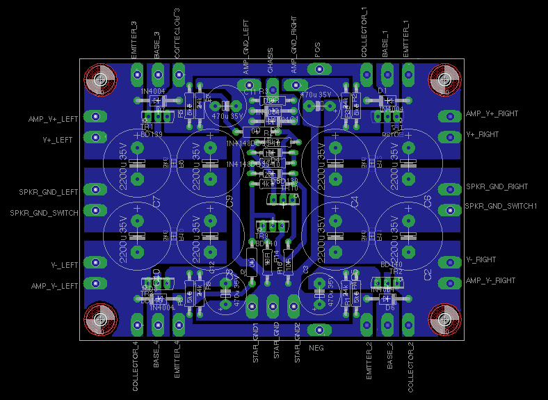

My first time using Eagle, single sided layout of the psu board with cap multipliers, virtual earth and protective earth. First draft attached... remember that the pass devices are off-board.

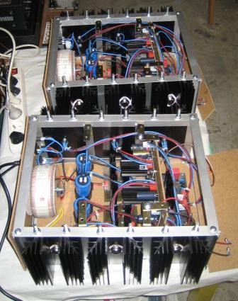

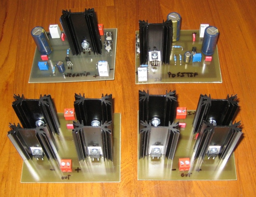

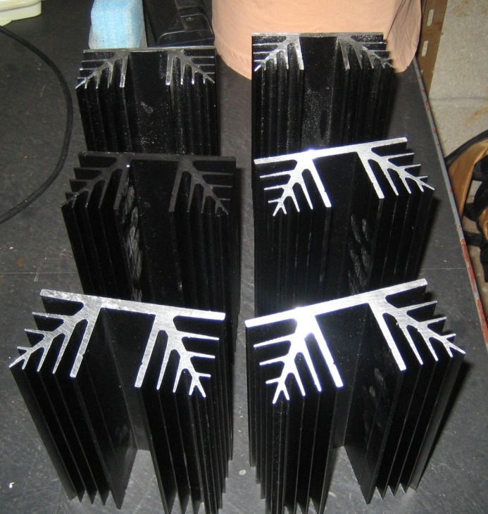

Hi all & Alan,
This forum is a real great source of information which I enjoy since I started thinking about building a multi-channel's sound system.
The JLH is my first DIY amp - not far from being the first DIY electronic gear - so lot of things to learn every day
Each channel is built with a symetrical regulated power supply from a 2x18V - 230VA toroid and 4 MJ15003. Each of the MJ15003 runs 1,4A based on the voltage on the 0R1. Is my understand correct that this makes a quiescent of 2x1,4 = 2,8A?
So far, I tried to run it up to 20V and 1,8A per MJ15003 and thermal stability looked to be OK.
It is not yet connected to the main hi-fi system but to low bandwidth speakers so it is really difficult to judge at this stage the sound in a perfect way. What I can say is that the sound is very transparent and detailled compared to the keenwood amp seating on the test system as an A-B comparison point.
Cabling is still in progress - not organized / twisted by transistor or optimized in lenght, shielded cable still needed for audio signal input and the Vellman kit for speaker protection is waiting to be connected. Pannels are all in MDF wood pending final decision on how it will look like.

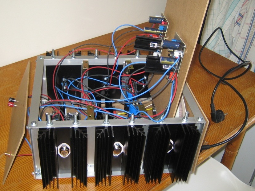

Below a few pictures:
- PCB(s) for the power supply of the second mono-bloc : bridge rectifier is based on MBR20100CT schottky diodes and regulators are using TL431 CLP.
- Heatsinks cut from a 1 meter block into 16 cm pieces (an aluminium windows manufacturer / installer agreed to cut it for me with a profesionnal saw). They are supposed to be 0,6°C/W from the manufacturer's specifications.
- Side views, front views, pannel view of the existing mono-bloc (in its present state)...
I've not used copper plates to connect the power supply main capacitors as seen in many implementations. Is it needed ? Would it bring any benefit?
Both positive and negative parts of the power supply are completely independant in term of zero volt reference point until they connect to the amplifier board and the ground star point is at the audio signal entry point linked with the main's earth point.

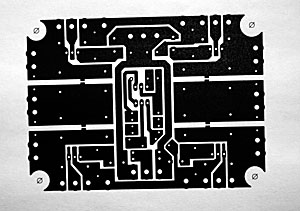

I've had a devil of a time getting the laser printer I have access to at work to print out the toner image of the pcb. It's a new printer. I'm using glossy paper, torn out of a US Electronis hobbyist magazine. This approach was successful in the past on my TGM project. I spent 3 hours to no avail. All I could get was an image on regular paper (see attached).
Then I realized, this is a JLH design, it's British. So the next day I took in an English Hi-Fi magazine and used a page from that. Worked like magic
Next issue was that I've tidied up the wiring around the psu trafo, rectifiers and cap quite significantly. But the darn thing buzzes loudly when powered up. It's unbearable from the other side of the room. I pulled out the screws that were firmly holding the trafo via 4 brackets to the chasis and then put a rubber grommet under each corner with no screws. It was silent. So there's a way forward, I just have to find some longer bolts to hold it together.

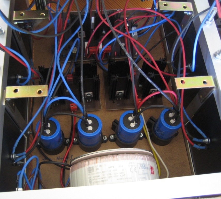

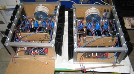

More seriously, I finished mounting / wiring the second mono-bloc (pictures attached) and I'm facing a situation now where:
1) Each mono-blocs is dead silent when connected alone to the pre-amplifier. No hum or buzz in the speaker when not playing music and sound is fine.
2) As soon as I connect both mono-blocs to the pre-amplifier, a buzz is heard in both channels.
3) If I switch off one mono-bloc leaving it connected to the pre-amplifier, the buzz remains in the speaker of the second mono-bloc
4) I tried by-passing the pre-amplifier by connecting to the CD player directly, and the same buzz can be heard.
I'm quite sure that this is an earthing issue but don't know really at this point where to start from. I'm going through the forums to find out if any-one had an equivalent issue before.
Advices are welcome to help !

Regarding the PSU, I'm contemplating the idea to implement two PSU, one with voltage regulation for the first two stages and one with C-R-C or C-L-C style filtering for the last stage. I've seen this in a class A amp as the needs are quite different between these two parts of the amplifier but don't know yet how this would work here.
The first step will be to do some simulation using SPICE - good activity for summer break rainy days to learn new things

On my side, I fixed the PIN-1 issues on both monoblocks that was participating to the buzz of the setup. The buzz has reduced a lot but not fully disapeared. I'm doing measurements between chassis, power ground, earth safety ground, signal ground to see how the whole thing behaves. I started rewiring the grounding completely on one mono-block to have an A-B comparison point. The next steps will be to implement some shielding, doing physical layout changes, implementing a ground loop breaker.
Jean-François.
