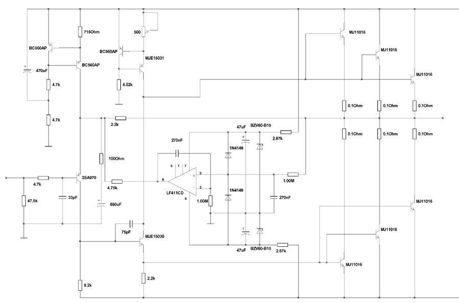

@Nisbeth :
Ok, thats right. Flatpacks are better integrated in a PCB layout. :)
@EUVL
I use a small modified version of the JLH design that can driven speaker with impedance smaller then 4 Ohm. Because my intent is to driven later very complex speaker (Electrostatical Speaker with lower Impedance of 2 ohm in High tone). For this the MJ11016 are better (look at measurements)
Another problem is the price of the MJL21194 or MJ21194 in germany. I see that you come also from Germany. I have look where i can get the MJL21194 and i found only by Segor Electronics the MJL21194, but the price of over 6 Euro is very high. By Reichelt i can get the MJ11016 for only 2.20 Euro.
Can you tell me where i can geht the MJ21194 or MJL21194 for a low price in Germany ( i need for my design over 40 of these Transistors!) ?
Here measurements of the Modified JLH with MJ11016 and MJ21194. Every Transistor has 0,9 A bias current.
Modified JLH with three pairs of MJ11016
Watt Dist. at 8 Ohm Dist at 4 Ohm Dist at 2 Ohm
50 mW 0,001% 0,000% 0,001%
1 W 0,004% 0,002% 0,006%
5 W 0,009% 0,005% 0,015%
10 W 0,013% 0,007% 0,025%
50 W 0,041% 0,033% 0,275%
max power :
at 8 Ohm - 0.170% Dist. - 83 Watt (can more but its cut off at +/- 34 Volt PSU)
at 4 Ohm - 0.443% Dist - 130 Watt (can more but its cut off at +/- 34 Volt PSU)
at 2 Ohm - 1% Dist - 153 Watt
Modified JLH with three pairs of MJ21194
50 mW 0,009% 0,005% 0,005%
1 W 0,041% 0,025% 0,030%
5 W 0,094% 0,057% 0,078%
10 W 0,138% 0,082% 0,139%
50 W 0,413% 0,274% ***
*** Cut off in Spice. MJ21194 cant driven ist.
Another way is to bridge two modified versions of the first Schematic with MJ11016 ( I know, it is overkilled ;-))
1 W 0,002% 0,003% 0,012%
5 W 0,005% 0,007% 0,030%
20 W 0,010% 0,019% 0,078%
50 W 0,018% 0,050% 0,352%
100 W 0,038% 0,223% 0,803%
Max Power at 8 Ohm 232 W with 0,650% Dist. (can more but its cut off at +/- 34 Volt PSU)
Max Power at 4 Ohm 315 W with 0,940% Dist. (can more but its cut off at +/- 34 Volt PSU)
Max Power at 2 Ohm 144 W with 1,135% Dist.
I know that a Spice simulation is one thing, the reality another. ;-))

Hi Thijs,
that are only values from a spice simulation, not measurements from a real Circuit !
And it is not yet optimized !
In the single version there are 3 pair MJ11016 output Transistors with 0,9 A bias current per Transistor.
In the brigde version there are 5 pair MJ11016 (per single Amp, complete 10 pair, i know it is overkill ;-) with 0,5 A bias current per Transistor.
And yes, i can post the Schematic. Its attached.
Greetings
Small_boy

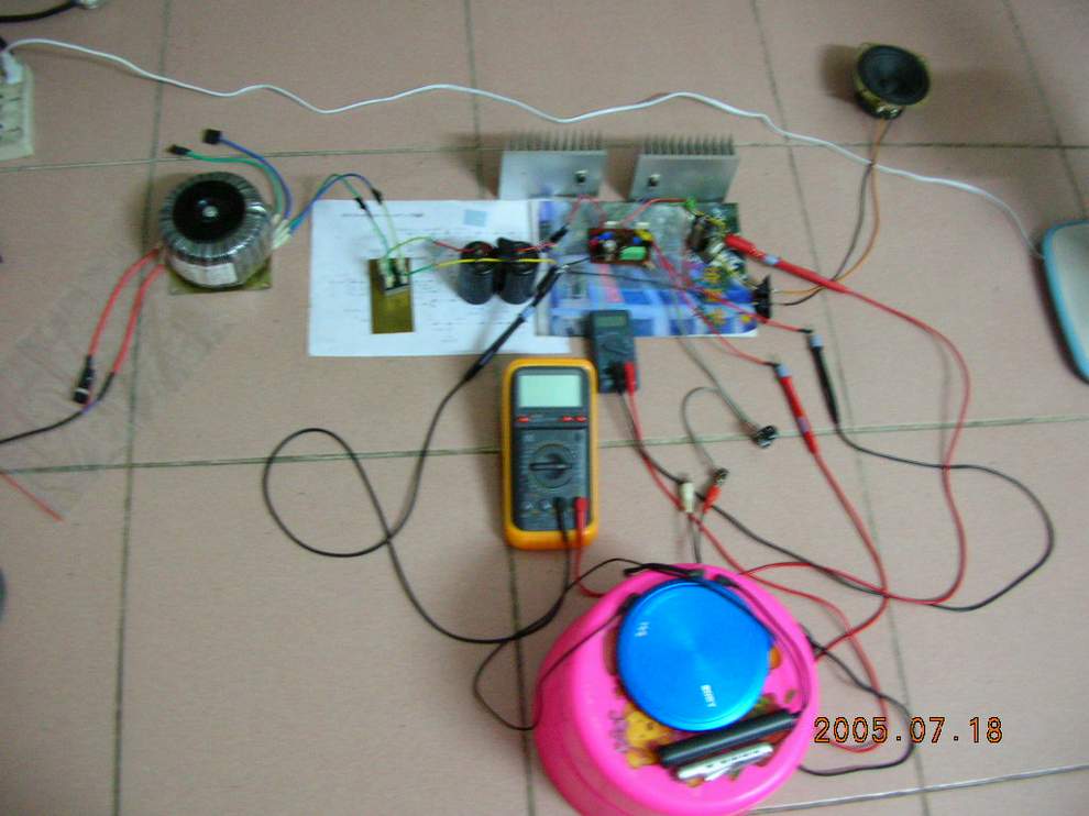

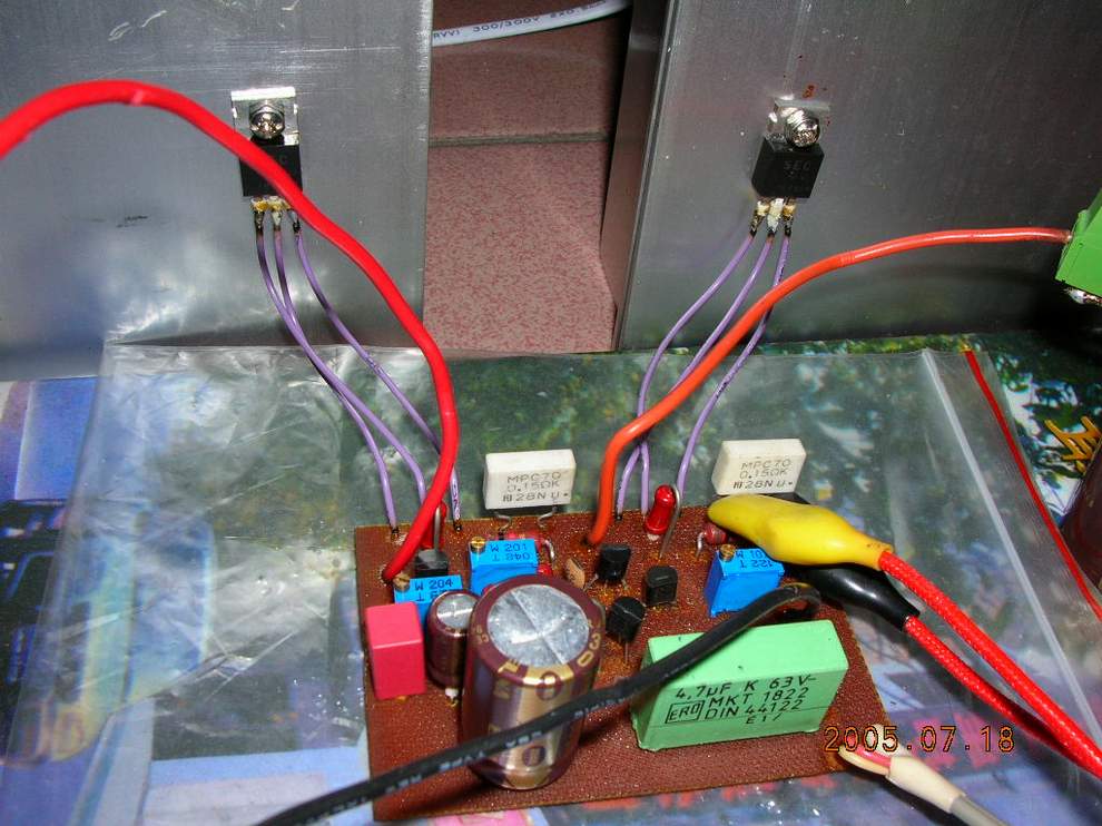

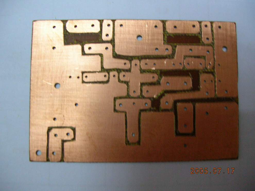

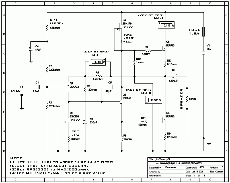

Re: ZVN3310A
mikelm said:
Well - I have some so if you want I would be happy post them to you.
If you want me to, email me your address.
mike
p.s. The distortion is lowered because this circuit combination removes non linear current draw from the feedback resistors.
:eek:
ha,thank you very mach,my friend!
but it's too far away from england to china,I don't want to trouble you...thank you again!
last night I have made some similation with ZVN3306A in my MULTISIM2001 software...but it's THD didn't decrease,so I suppose ZVN3306A(3310A) has a high UGS(about 4V),ZVN3306A's UGS add IRF510's UGS is about 8V,let Q1's UCE is reduced,so it's THD increased,that is to say:you can using more higher UCC(more than 36V) to get more lower distortion,But you have to choose ALEX's circuit if you want to increase it's working Voltage...because the SK170 only a small power transistor...
I will make a sample to test can't it works well...just wait me for few days!
best wish!
