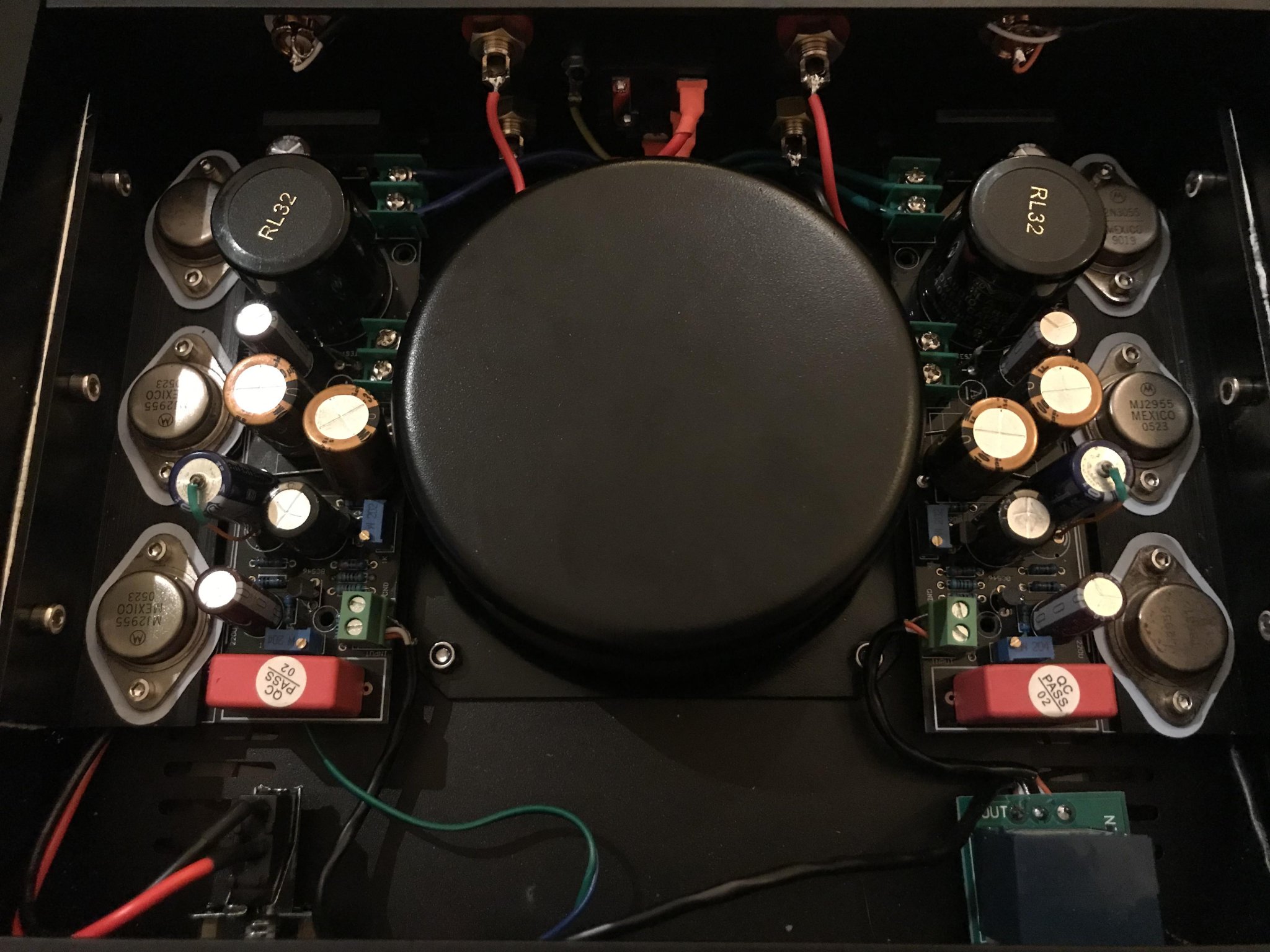

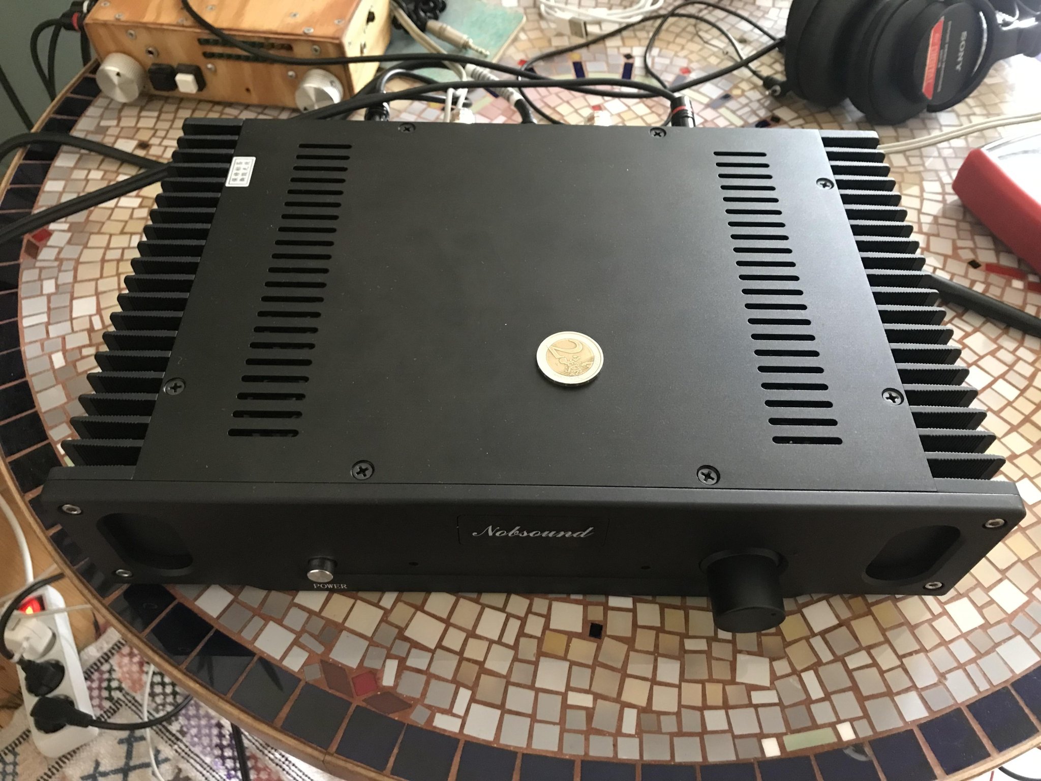

The ready made amp arrived and did some tests.
First impression was 'looks bigger than expected', wife also gave a weird look at it, but it couldn't get much smaller I guess. Other that this and badly chosen typography for volume/power, the case gives a quality feel from outside.
It worked out of the box with my 4ohm speakers and didn't get too hot, just warm enough. Couldn't say much about the sound yet because probably not well biased, but there was hum without inputs. Not too high, but annoying enough since speakers are always very close to me.
Factory settings
Torodial output: 21.7V
Rectifier output: 27V
Test point voltage: 23.3V
Test point current: 1.3A
AC balance: 10.9V
Hands on
The screws are like an old car wheels, very hard to remove. Also, a warranty seal covers one of them. I took me a good while to decide on this way of no return, until I decided to jump in.
LED attachment to the case is a joke, just taped and one of them was already off.
Parts seem genuine, unless they took the time to make some Motorola logos look aged. A MJ2955 looks so old and rusty that you can hardly read the markings on it.
Both boards look soldered by different people, so much flux on the back of one of them that I had to clean it. If boards are not matched, transistors probably less, I thought.

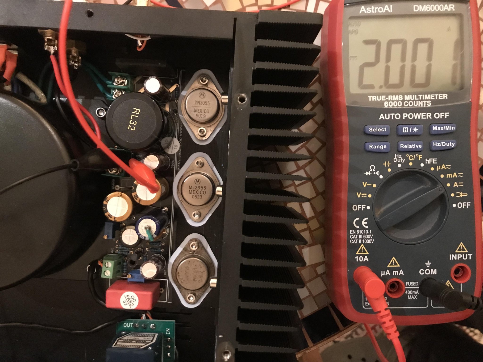

Replaced the output caps for 2x Nichicon 2200uF in parallel per board (4400uF). R1 became 47ohm. I had no 500uF for C1, so I used the axial 1000uF that came for the output instead.
There's a "test point (A)" jumper that was annoyingly soldered under the board. I soldered instead two leads on the upper side that I can solder or de-solder easily to set the bias. It confused me that this test point didn't show the same current than the toroidal AC output. Also the DC voltage it shows is different to the rectifier's DC output. As long as I could trace it, the jumper joints current coming from the capacitor's multiplier TO-3 NPN to the TO-3 PNP on the middle.
Current bias at test point: 2A
AC balance at output cap: 10V
Voltage at test point: 20.5V
Voltage at rectifier output: 25V
Result: One of the transistors reaches up to 70-75C. Nice to warm up your hands. And hum is still there, even stronger.
Everything assembled back, with caps exchanged at least. Heat sinks with extra thermal paste, since they came with not enough.
Next step: for my 4ohm speakers I'll follow @jemraid suggestion. I ordered a 2x12V toroidal rated 100VA (4.1A output). I hope this will diminish hum as well? The actual 22V transformer was vibrating quite a lot and related the frequency of this buzz to the hum I could hear on the speakers. 22V transformers of this size are usually rated 2.2A max. If hum is not gone, I might have to wire parallel capacitors to the power supply, the way @jemraid does on his excellent video. Or a voltage stabilizer?

Have you increased the current from 1.3A to 2A? Perhaps the installed transformer is not designed for high power.
Revert to manufacturer settings.
Evaluate the hum of the transformer and the noise in the speakers at the original settings.
If transformer hum persists, discuss the problem with your dealer.

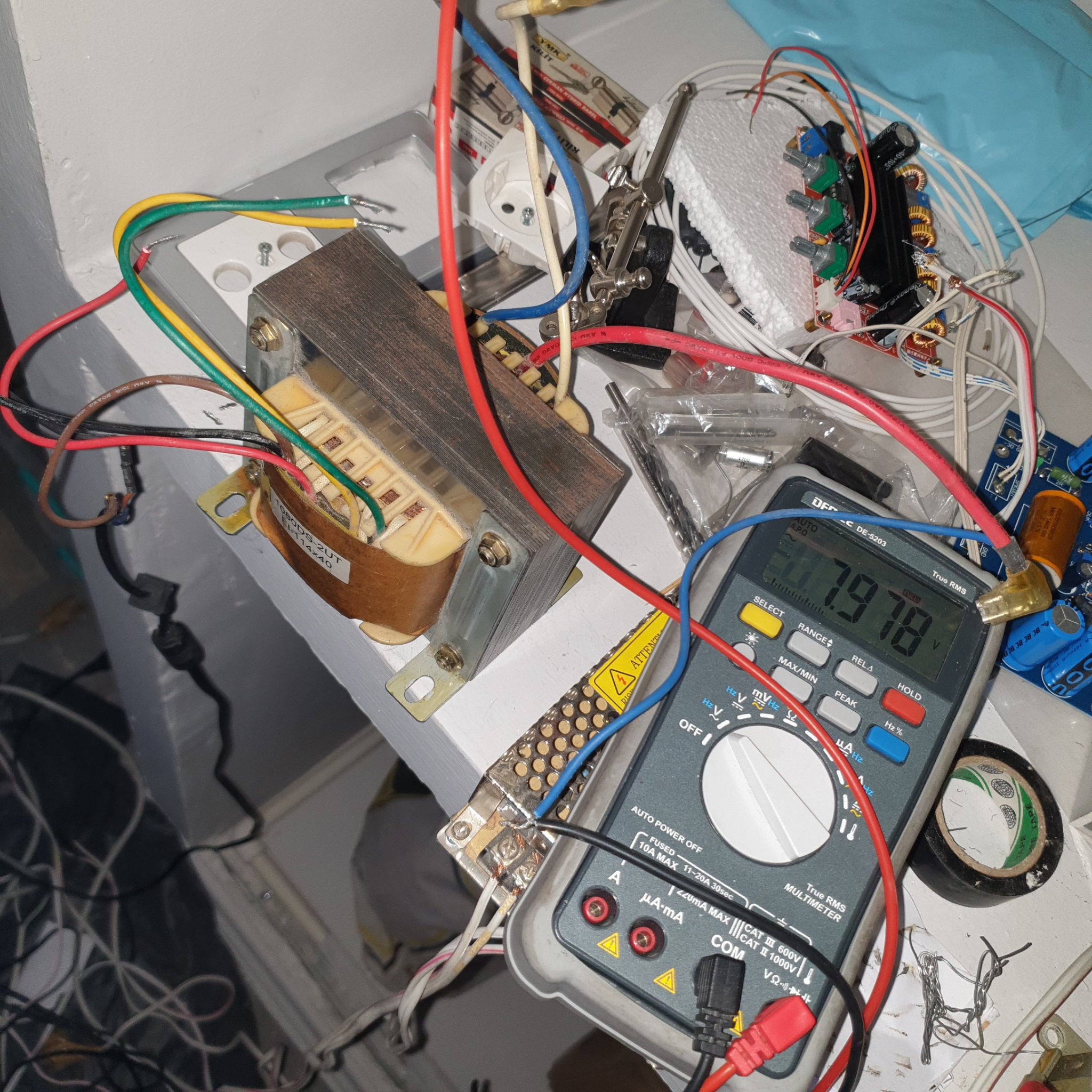

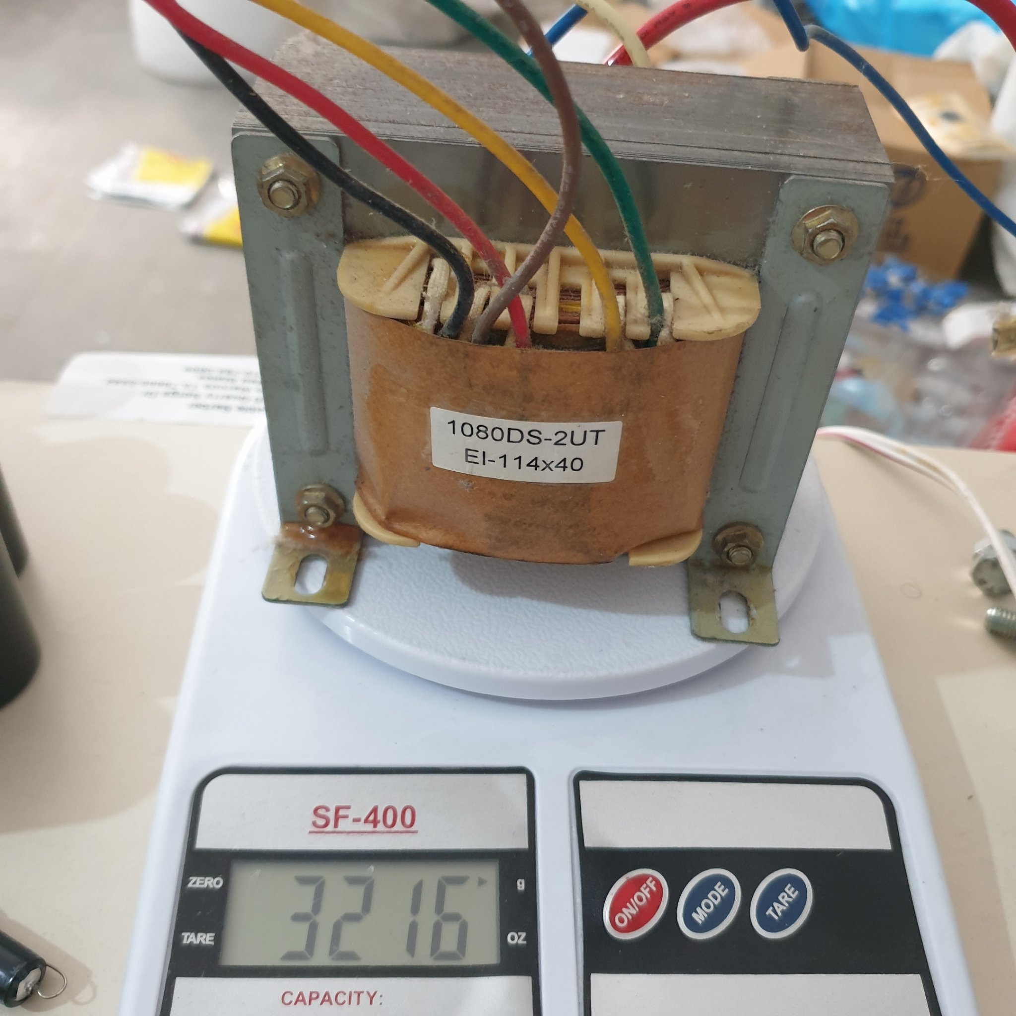

Hi.I want to build a class a amplifier for my 4 ohm 4 inch full range speakers. I have Amp camp amp pcbs but i heard JLH sounds better. I have many transformers(do not want to buy one more) I found one in broken UPS and it has 2 different primer inputs which is 220vac and 250vac and its output is 2x8vac if line connected to 220v or 2x7vac if line connected to 250vac .I want to build a symmetrical supply to avoid output caps but I do not know if any dual supply JLH board available.On ebay and aliexpress there is always single supply JLH available.I found one symmetrical one but there is no pcb board for it.And transistors seems unavailable
https://sound-au.com/tcaas/jlhnotes.htm
Which of them sounds better? Dual or single supply? Is there any dual supply option for my application? Is there something special for single supply one because there is single supply one available everywhere.Thanks
Are you able to measure the primary and secondary resistances?
That will give a clue (but needs a bit of thinking about) to estimate the ripple and performance.
You could also try a bridge rectifier and a smoothing capacitor across one secondary, measure the open load voltage (we would expect around 11V) and then place a 10 ohm resistor (would have to be rated at 10W or more and put on a heatsink, if you have them) and measure the D.C. voltage.
Depending on how well designed the transformer is you may or may not find running the 220V winding works. You did not say what voltage you have available, but I guess it is 230V. Running the 220V should not be a problem but if the designer did not allow enough margin the magnetic field may saturate the iron and it will get hotter than it ought. It isn't the 230V that is the problem, it is the tolerance to a higher than normal voltage which may be getting on for 250V. Do you know what your supplier's min/max voltage ratings are?
