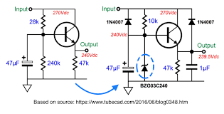

You can add a zener diode to the circuit and get a stabilizer when the voltage is exceeded...It also includes a capacitance multiplier on the power supply,
Regarding a stabiliser, when I mention stabiliser, I generally mean a feedback controlled power supply, not a capacitance multiplier. A capacitance multiplier acts as it says - more or less- as a larger capacitor than is used because of the gain of the transistor. The voltage on a cap. multiplier can still droop with current loading. It usually works well for a JLH though because the Class A circuit draws a constant current (on average, apart from when it might be overdriven). So you could use a multiplier in this case. Perhaps with an overvoltage Zener limiter as OldDIY suggests. (His illustration won't be enough current for your JLH though - you'll need a much beefier design, possibly with a transistor amplified zener too).

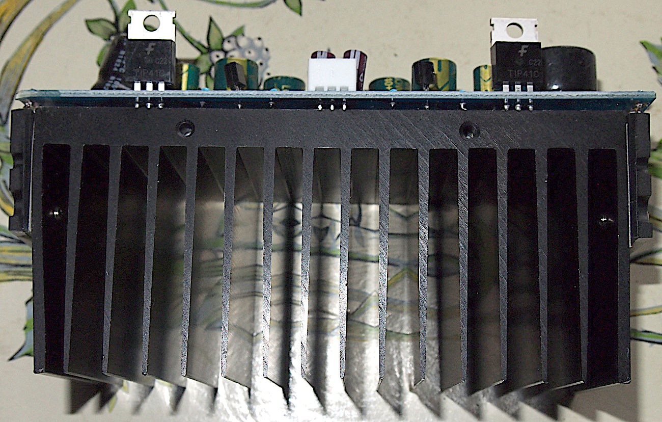

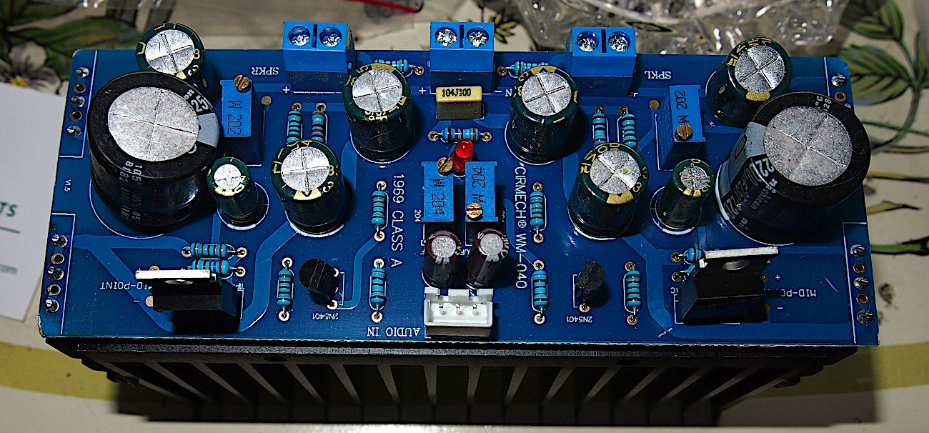

Looking at the heatsinks and chassis of the following build, which I'm waiting for, do you (or anyone else) think from experience it can effectively handle 2A with a 22V PS? Biased at midpoint 11V that makes for 22Watts, whereas the build advertises "15W", so I'm a bit worried.

I'm asking because I might still might be in a position to return it, naturally not after I've done the soldering rework of R1. But I could perfectly understand that nobody is in a position to judge this without trying, just asking for honest opinions.

As regards the image you showed, the heatsinks look like 200mm x 25 or 40mm deep, only 50 or 75 mm long. Maybe it has a thermal resistance in the region of 1C/W. Could be lower, if 40mm deep fins. After you've dug up some info about power and amplifier outputs, tell us what you think the total power input per channel is going to be and the depth of the heatsink fins. You can look up manufacturer's data as well as I to find out its thermal resistance and then work out how hot it will get.

Thanks. According to a supplier that's 1.65C/W if fins are 25mm deep but in black, anodised.dimensions

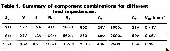

The power goes to 2 transistors. For 10w it seems the power dissipated by each transistor will be ~17w based on Hood's articles. That tends to apply what ever the load is as the supply voltage is changed for each of the speaker impedances. Eg he suggests 17v 2amp for 3ohm, 2amp and 27v for 8,1.2amp. 3ohm works out at 34w, 8ohm, 32w. Rather similar.Looking at the heatsinks and chassis of the following build, which I'm waiting for, do you (or anyone else) think from experience it can effectively handle 2A with a 22V PS? Biased at midpoint 11V that makes for 22Watts, whereas the build advertises "15W", so I'm a bit worried.
For your 15w you can simply scale the numbers accounting for a 4ohm load and the increased power. It will be close enough for your purposes. Powere disipation in each transistor should be ~17x1.5 watts. Neither transistor's current can go down to zero so there has to be an excess.

It's a bit late to add this, but surely most of you will have compared what you can see in the above pics of the CIRMECH board and its little heatsink, with other typical JLH class A kits, finished products and boards. That heatsink is nowhere near large enough for more than about 4W per channel in class A. It is woefully undersize and you'll wind up needing to pack it in ice before it overheats and your semis burn, genuine or not, if your power supply is more than about 15V.
I have one of these too, and realised how far short of a JLH amp it was before trying to power it. I've estimated that it needs a heatsink at least 4x that size to peak at 15W/channel before clipping and overheating when the ambient temp. is 20-25C. Perhaps bolting the 'sink to a heavy aluminium chassis or a much larger heatsink would allow it to deliver what you could have expected.
The TTC5200 transistors appear to be genuine Chinese assembled types but TIP41 phase splitter/driver transistors are not a good choice at all (high capacitance, very low Ft and hFE). If you obtain an original TO5 type like 2N1711, so much the better but 2SD669A (most Chinese versions are fine) is cheap, available, apparently better and already used on other commercial JLH clones. It should just drop in if the leads are splayed and it's rotated 180 deg. with respect to the TIP41's heatsink side. i.e. the pin order for TO126 style transistors is the reverse of TO220.
