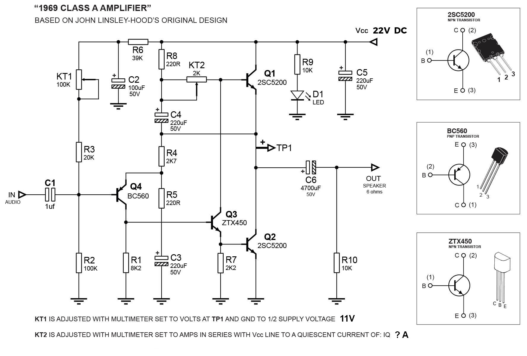

JLH 1969 10W (22V DC) IQ?
Hi, OldDYI.
I would like to feed my circuit with 22V DC. I am making a lineal source with a transformer and rectifier bridge. I will use the LM317 to keep the voltage stable at 22V DC. I will also use the TIP2955 transistor with the LM317 to absorb most of the current.
My question is about the quiescent current. How many amps do I leave the IQ at?
Thanks.
Att. Tiago Sierra

- JLH 10 Watt class A amplifier
