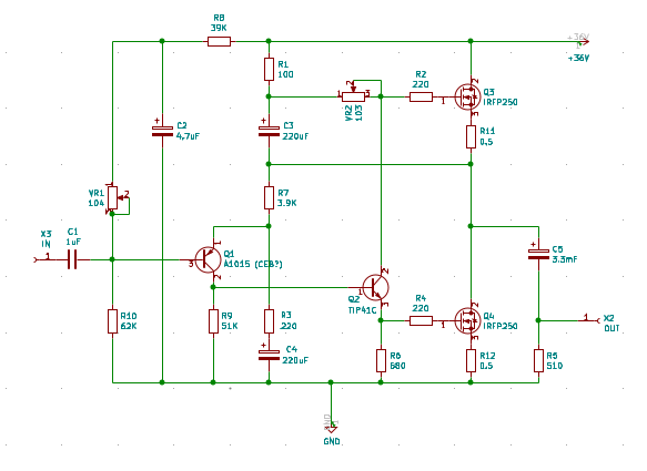

The problem is that the input filter capacitor (C3 in #7478 that OldDIY mentions) and the input capacitor will try to turn the pnp on, but the feedback decoupling capacitor keeps it off. During that moment the pnp is off, the driver transistor is off, and that allows the upper resistors to turn the upper MOSFET on. I don't see that changing the capacitor values will have much effect, and a slugged PSU (capacitance multiplier) will really be needed.
@Kozard - I don't think your "ripple magnifier" will be too popular
Or maybe the bootstrap resistors could be divided into three? A small resistor at the top decoupled to ground with a big C shold stop that quick build up. BUt the resistor will need to be smallish (22 ohms or so?) so the decoupling cap will need to be big but that might be the simplest option???
And the capacitance multiplier/ ripple filter could be applied to the bootstrap/drive stage and not have to have a high current transistor?

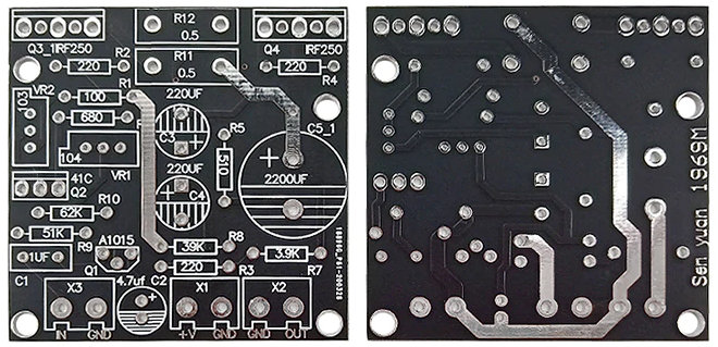

Thanks everyone for your time and your attention!

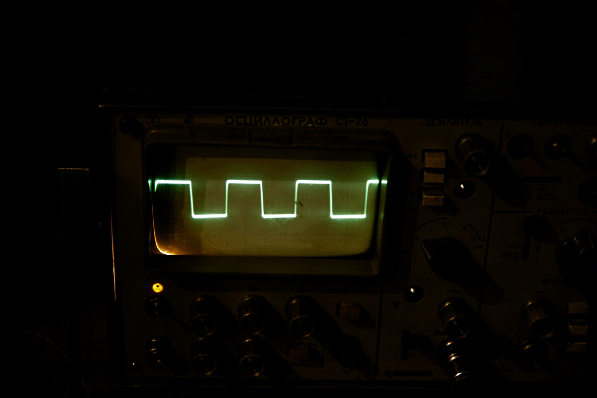

Now that I soldered back the 4.7uF, the issue seems resolved.
I get a 26V peek to peek for only 2uS, which is perfectly safe to me!
Trying larger bootstrap and feedback capacitors is on the way and I'll keep an eye for possible improvement.

I would suggest a capacitance multiplier would work. A complementary Darlington pair with MJ2955 and BD139 with the MJ2955 emitter to positive, and a 1mF capacitor from the base of the BD139 to ground, and 1k resistor to positive should work.
Simulated turn-on thump was 6V peak with the circuit "as is" (at least, my simulated version) and only 0.25V with the slowed risetime.
You will end up with something like a 2V drop across the series pass transistor, perhaps your PSU could be tweaked a little?

For reference and for anyone that may find it useful, I tried to draw the schematic of this version, hopefully without many errors.
So far I'm very happy with how gracefully this little circuit drives my difficult speakers.

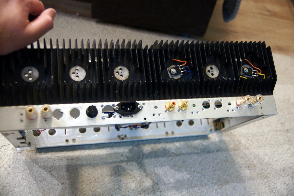

Ι've climbed up to 500mA per channel before the small temporary heatsink became too hot, circa 80C. Iq rises even more ~15% there. Higher Iq makes perceived sound more solid and clear.
A small chassis with larger heatsinks + kapton tape insulation + original mosfets are on the way where I plan to balance the Iq and the thermal dissipation within reason. Till then Iq is 80mA because it is on all day. Does not sound bad at all and I cannot stop listening.

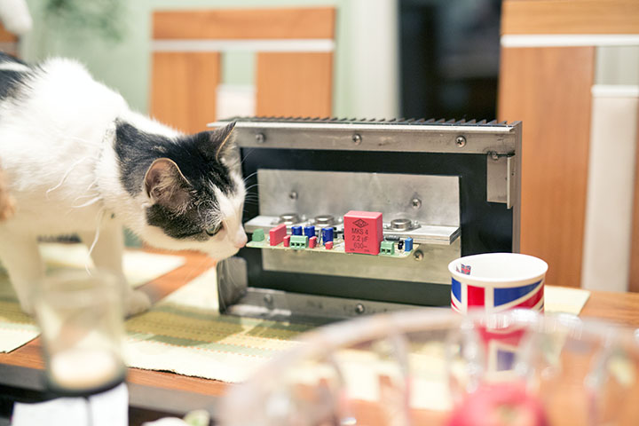

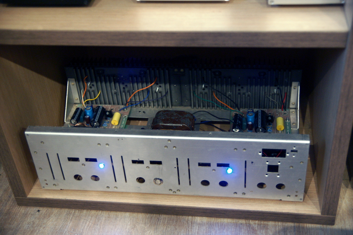

Well, for a week now I have been listening to jlh 1969 (the PCB has been on the shelf for a couple of years - I finally soldered - I wanted to try the famous JLH a long time ago) - I have to say that it sounds respectable - good bass and very enjoyable mid-range and top. Very good for such a simple circuit, I agree with PMA.
For now its a "naked" construction - maybe in the spring I will make a wooden "coat" for it and i need a PCBs for PSU...and maybe bigger transformer or two of them.

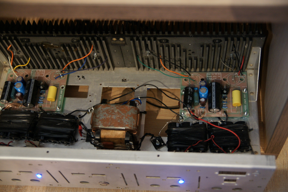

PSU 3x4700 uf (actually 5200uf measured) 1R and another 3x4700uf for each channel. Output 4700Uf, input 2uf2. On the board there is an additional 2200Uf and 2200uf filter for the input transistor. 23.5V power supply, MAX. 7.7W for 8 and 4 R loads. Quiescent current 1.1A (power supply max. 1.25 A - so a little reserve is left + transformer will heat up less).
At input BC 560, VA / phase splitter-D139 (with hfe 140 approx.) - at output BD911 also Hfe around 140 - I selected four out of ten with the largest and equal hfe. Admittedly they are pretty accurate - half around 70 and other half 140.
p.s. Remember that on these ebay PCBs BC560 must be turned upside down than indicated on the board.

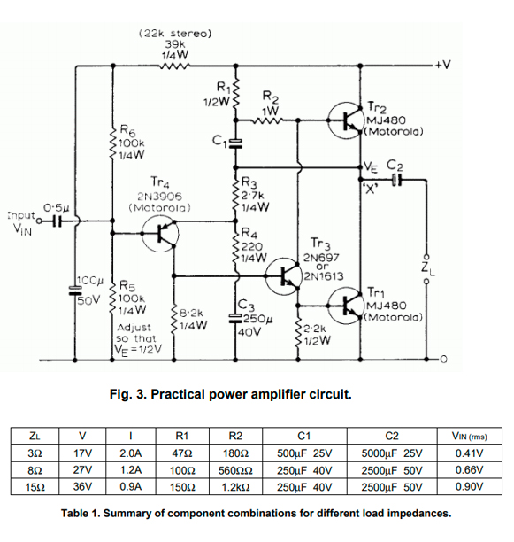

In the original article from 1969 (TCAAS) there is a summary for different load impendances from 15 to 3 Ohms. To start i thought to halve the R1 and R2 values and double C1 and C2 and measure distortion, then adapt step by step.
I didn't find a reference for use of this design with such a low impendance. What else to consider? Opinions? Hints? ..Thanks in advance!

The table isn't a measure of the amplifier's output impedance or damping factor. All it tells you is how to adapt the design to safely drive loud speakers of those differing impedances and still get the most from your basic amp.
Unless you plan to use low impedance loudspeakers, you will only be reducing the dynamic range and power available to your speakers, assuming they are more like 8R than 3R impedance. The table suggests resistor and other component values, supply and input voltages that allow higher bias and output currents which suit low impedance speakers but at the cost of lower output voltage. This means means less power for high impedance speakers.
So, its a table of compromises to support different speaker impedances. The reason being the limited power output capability of the single pair of power transistors operating in a compact, economical class A design amplifier. It certainly does not substantially change the amplifier's output impedance.
If you just want more power, think of a bigger, multi-transistor and driver stage class A amplifier design. In my experience, you may well be able to increase the JLH's power just by increasing the number of output transistors, heatsink size, transformer etc. but something will almost certainly be lost from the sound quality.

The problem with a low impedance speaker is that you need amps more than volts, but the increased current needs more drive power and/or output transistors.
the basic requirement is - what power do you need? then the volts=sqrt(PR) and amps=sqrt(P/R). 10W into 1 ohm therefore needs 3.16V and 3.16A rms.
You would best use transistors with high gain at high current, but quasi-saturation means having to use a higher voltage than ideal.
Note that in JLH's table, the distortion increases with reducing load. 1 ohm will be worse than the 3, assuming that the transistors you might use have gains of >100 as the ones JLH used (although modern devices should have better gain at higher currents, so will be rather better).
An output current of 4.5A peak (and that's only for 10W) will demand quite a high drive current, and may even need the driver to be doubled (Darlington or emitter follower boost), which will change the nature of the JLH original circuit.
