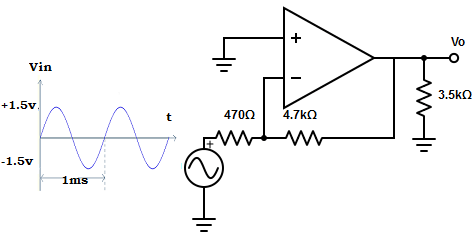

https://www.sanfoundry.com/wp-conte...mcqs-voltage-shunt-feedback-amplifier-q14.png

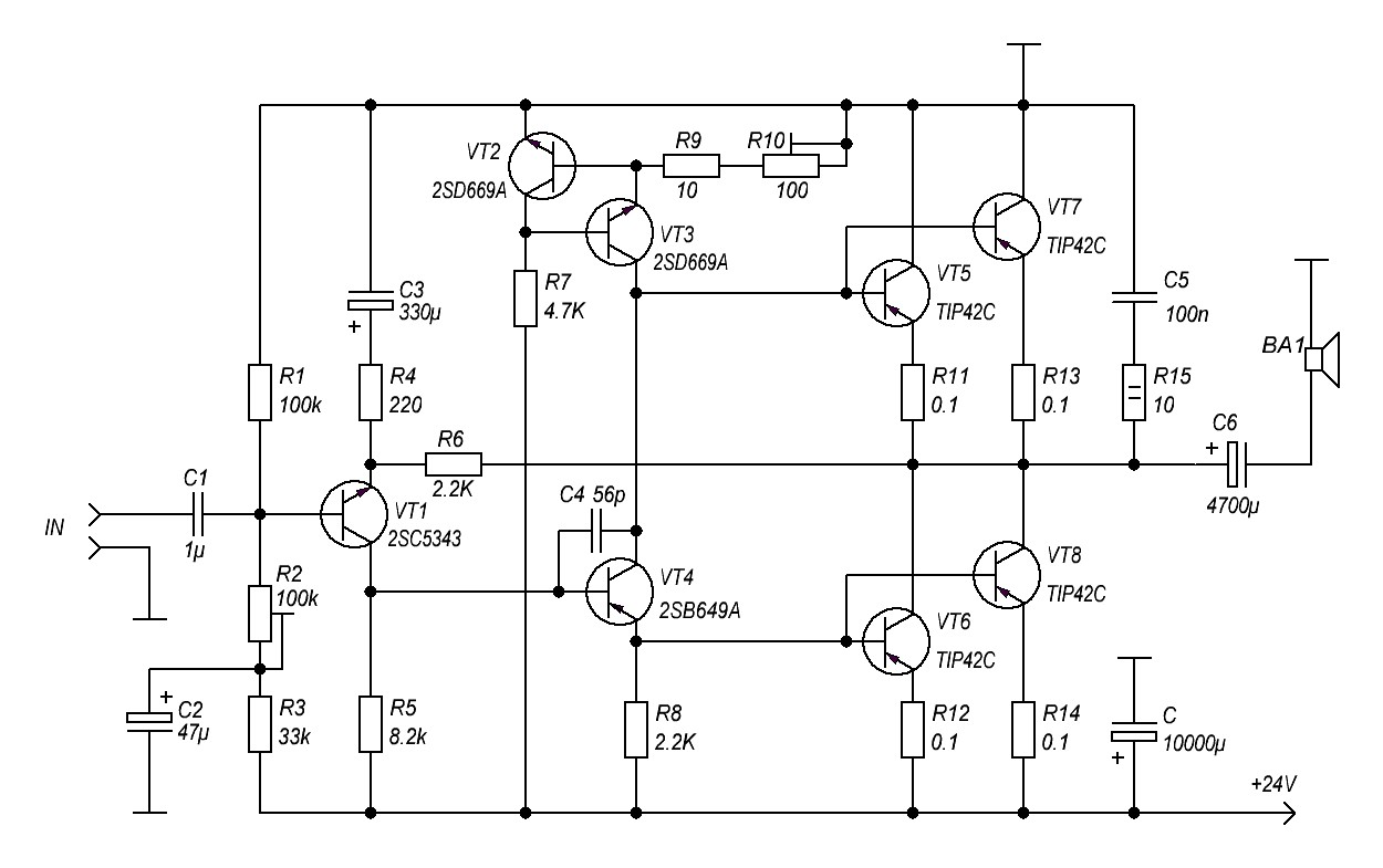

On page 496 in post number 4955 I posted a long-tail pair circuit with uneven collector resistors. Between that time and now I have tried to simplify the circuit and to try some more common transistor types.
My aim was to come up with a version that used roughly half the power of the 1996 Class A amplifier in which the output devices run at 44W each and
that would not be a great deal hungry than the 1969 Class A.
At half 44A times 4 the transformer can be reduced to half that for the 1996 amplifier.
The result is attached - some observations on the final circuit are in order.
My simulations show that there is a snag with single transistor input circuits in which the FFT components decay with some of the odd order ones being greater in magnitude than the preceding even order ones.
I think this is a question of the input transistor not being able to correct for anomalies elsewhere in the circuit - since it possible to make the correction with an LTP input.
The bootstrap collector load approach used in the original 1969 seems to have a reputation as being better than a constant current source.
The approach is based on positive feedback from the output to the phase-split transistor collector this then is re-cycled to the output and thus through the nfb loop.
This may not matter if the odd harmonics over the even ones at some point in the FFT pattern depending on where they stick out - I just don't like the thought.

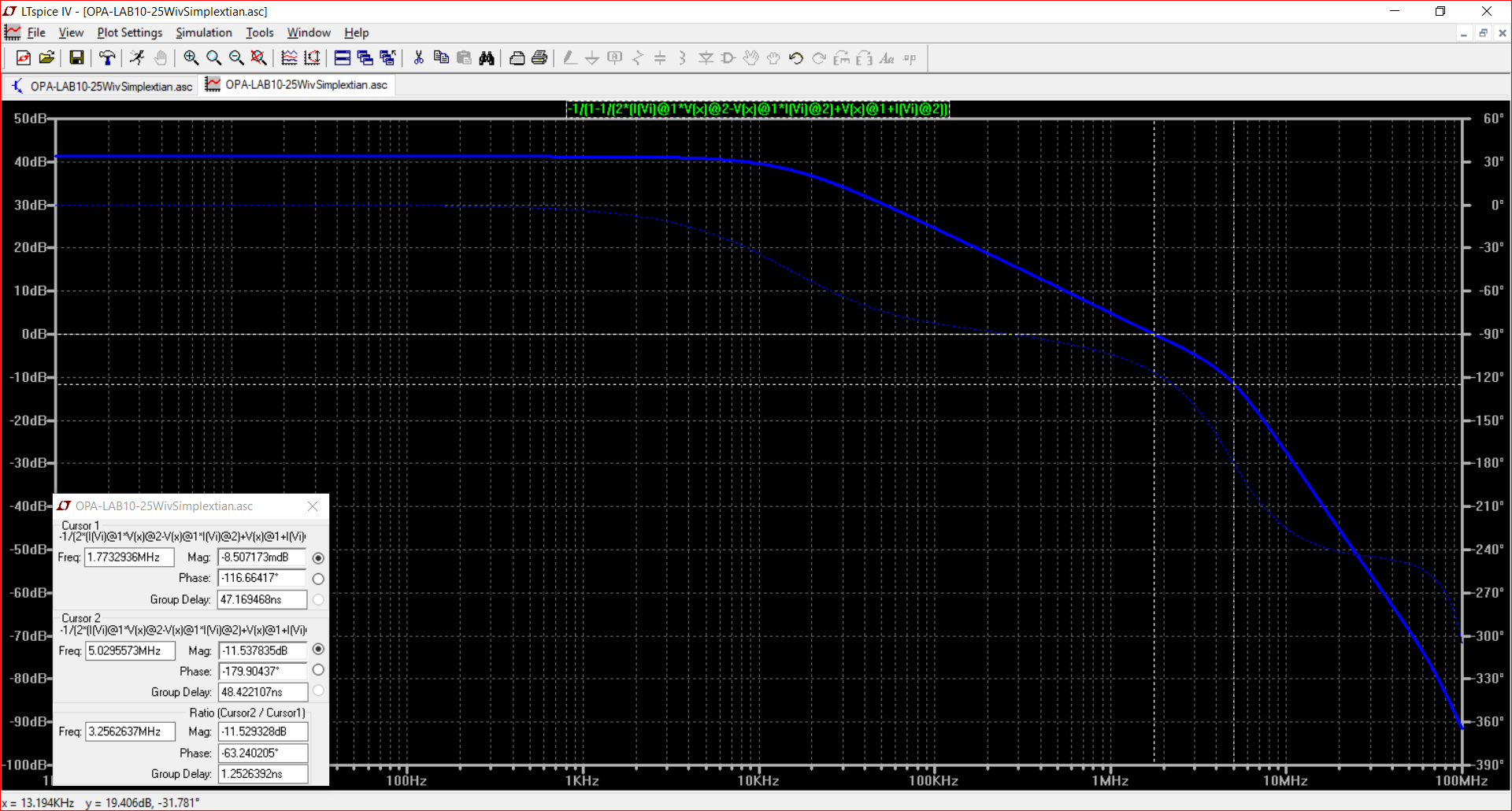

Another observation is that phase and gain stability margins can vary when transistor substitutions are made especially the phase split transistor. In the simulation attached to post 4955 I used a 2N5210 transistor which gave the best THD results but when it came to stability testing I had to incorporate a base stopper resistor and a phase correction network in the base to negative rail.
This gave rise to a kink in the Tian plot close to the critical phase frequency where the decay gradient increased from 6dB/Octave to 12dB/Octave.
With the method of compensation using a single capacitor much rides on the right value which may not be as per that simulated. Ideally that is on a portion of the plot nowhere near any elbow.
It is advisable to use a transistor with not too much gain for the phase split section which means avoiding such as 2N5210 and similar devices in this application (high gain might be useful in yours).
Happily humble transistors like 2N3904 and BC550 will work OK and the complimentary 2N3906 and BC560 partners will also work together.
I have used Bob Cordell's .models and included the link to his website so people can do their own comparisons between these and others in his .model selection.
Those I have chosen given the greatest stability margins however changing these is advisable if the voltage rails are increased beyond limits of the device working ranges.
Increasing the current is best done by varying the value of R14 - increasing this increases the standing current and generally improves THD.
The circuit works better without odd value collector resistors in the LTP.
This circuit operates in much the same way as the 1996 Class A which can deliver peak current of close to 4A into 8R.
The present simulation can deliver 2.2A into 8R.
