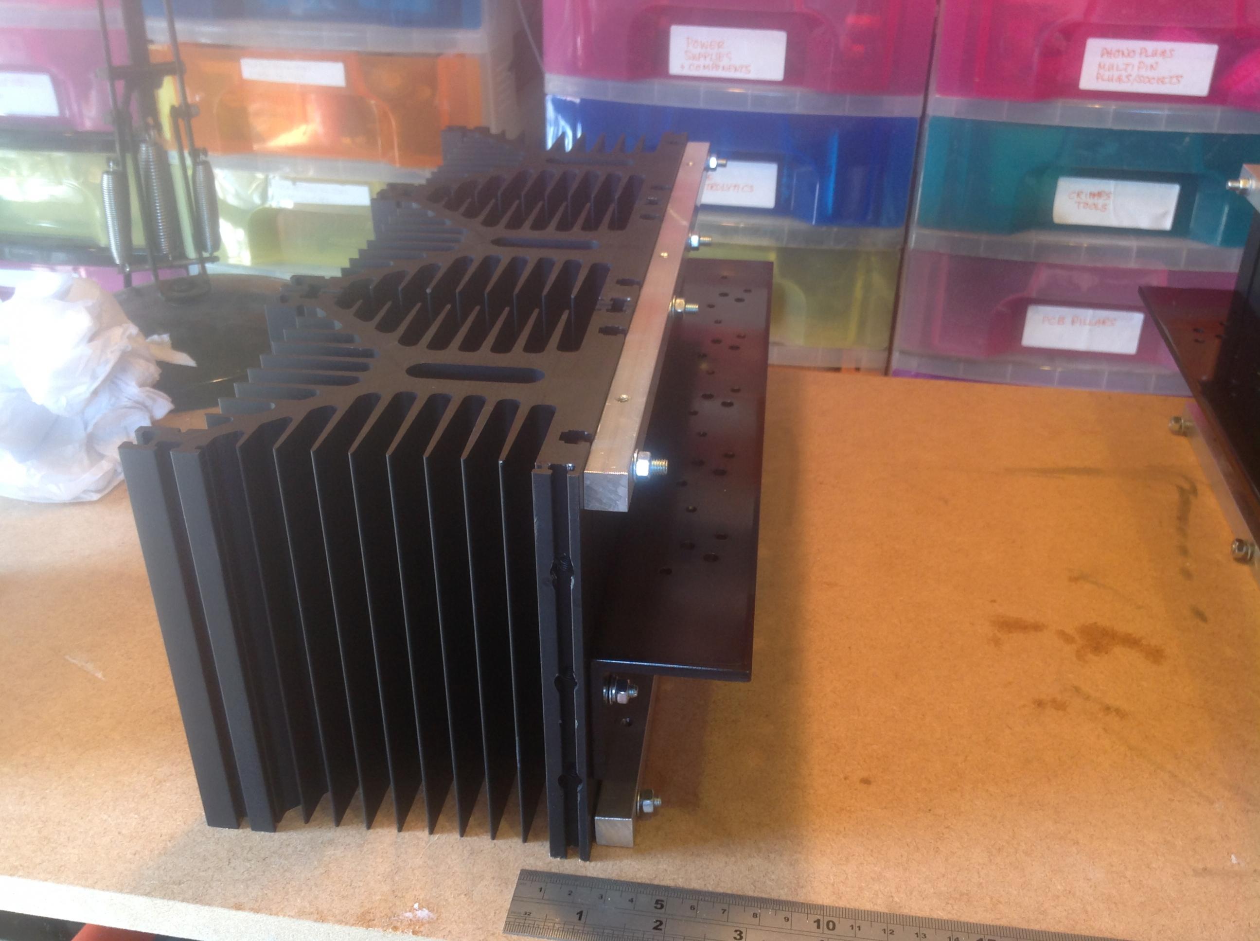

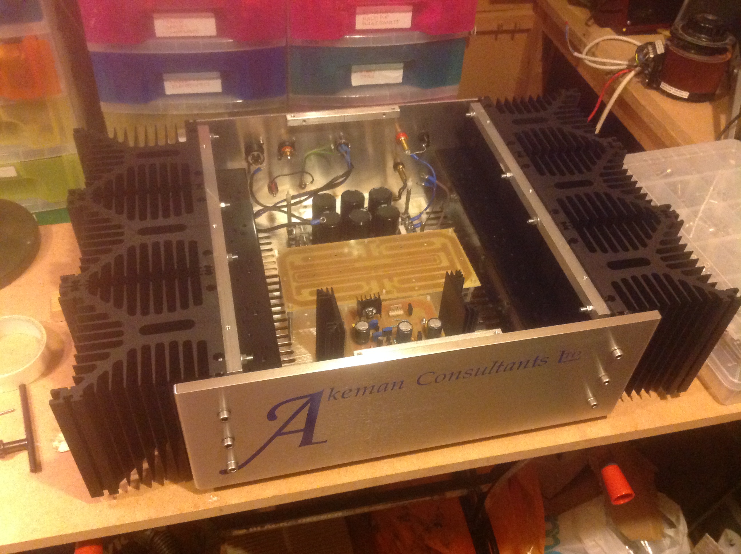

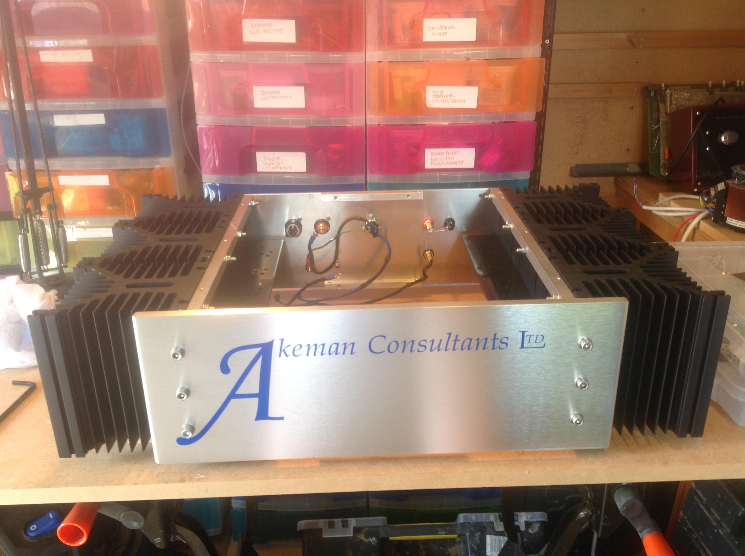

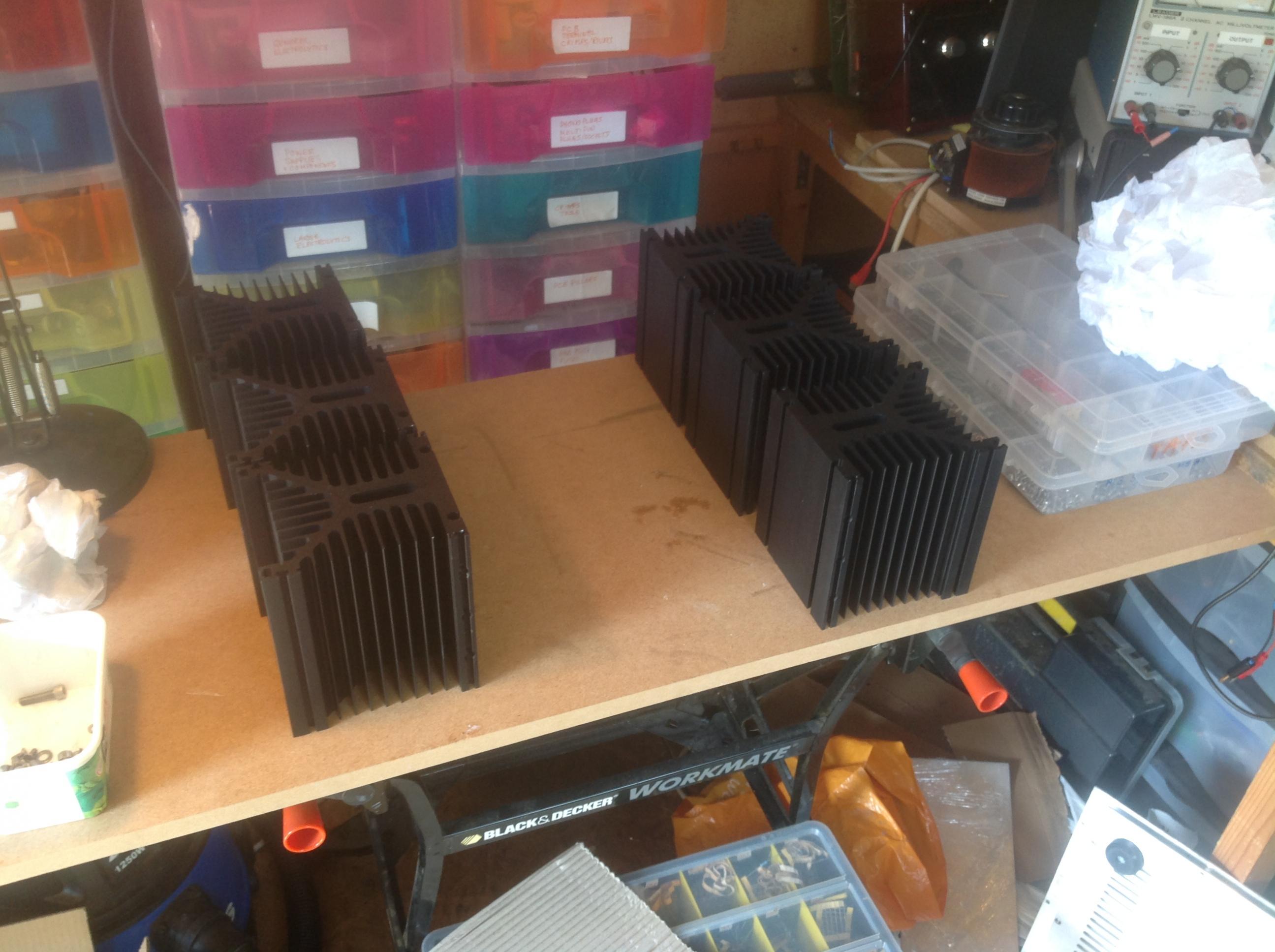

For some interest, here are some pictures of my monobloc Moss/JLH in the making. - "Call that a heatsink?" (Nigel?)
This is a re-housing of this amp since my first attempt had bright heatsinks and got a wee hot at 46C. or so, and I wanted to add more output transistors.
The black horizontal bar going front to back is the heat spreader linking the 3 heatsinks to the 3 pairs (up to 5) O/P transistors. I needed this amount due to my Matrix 801 S3s dipping down to just above 5 Ohms or so. One bank of heatsinks take the upper O/P transistor set (with one of the cap multiplier power devices) and the other the lower set.
The heatsink anodising was all stripped back and redone to aircraft standard by a local firm when they did the spreader plate.
I decided to put the transformers for both amps along with the soft start, rectifier and initial smoothing in a separate case. The amp case then contains further smoothing and the cap multiplier.
The unpopulated PCB going across the amp left to right is where the O/P tranistors come together. The O/P transistor cables all terminate with crimp n' solder connections onto stainless steel/high tensile nuts and bolts. The PCB tracks also have some 'magic sauce' added.:)
It measures about 0.008 to 0.01 or so on distortion measurements, but importantly, sounds smooth and power without effort to my ears.
