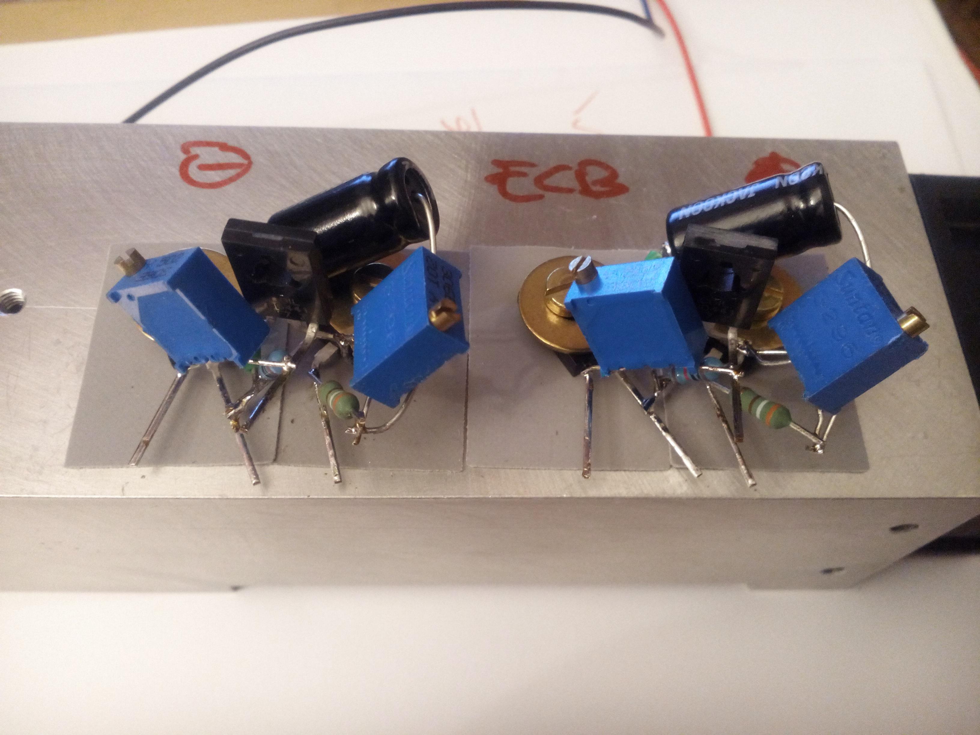

There is a half way house if you want. That is to use a 3.2 mm ring crimp connector - the red/blue/yellow type typically used on car electrics. These are made of tinned copper.
The way I connect to TO-3 cases is from the top and to use pvc over copper cable. Strip back the pvc, dip the exposed copper cable in liquid solder flux (use a flux pencil here) and then crimp the ring connector on.
Having got a good physical connection, use a soldering iron on the ring side and let solder run into the crimp space. The flux will aid the capillary action and make a good electrical connection.
Coming from the top of the TO-3 case on the heatsink, use a 3mm diameter stainless steel screw through the crimp ring with a shakeproof (crinkle) washer between the crimp and the TO-3 case to bite into both metals. I use a sandwitch of:
Screw head, plain washer, crinkle washer, crimp ring, crinkle washer, through the TO-3 case and mica washer, through the heatsink, through the isolation washer (which also aligns everything up) plain washer and locking nut. - hopefully that is clear enough
The plain washer compresses the crinkle washer to really bite into the case and crimp.
You could file the tinning off the crimp if you want to go a stage further. Copper screws would be too weak to really tighten up and probably would not add anything as you have made the most important joint which is wire-crimp-case.
It does mean that you need an extra hole in the heatsink to take the Collector wire through to meet up with those from the Base and Emitter, but that's not great problem. I use spare TO-3 isolation washer to form a plastic grommet.
Back on the PCB I use a similar system to connect theTO-3 wires to the PCB tracks. Use stainless steel nuts and bolts/scrimps with crinkle washers to bite into the PCB tracks.
