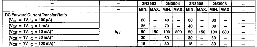

If you look at the spec. of the original 2N3906 part that JLH selected, you realize it's not a high gain part by today's standards. Excessive gain throughout results in instability with the JLH and if any of you bother to read JLH's articles plus later comments by Geoff Moss and others in the transistor substitutes section, you can read why. You'll find the best collection with support articles and recommended substitutes at The Class A Amplifier Site (TCAAS). It's now hosted as an archive at Rod Elliott's ESP website. Scroll down to the articles index here: http://sound.whsites.net/index2.html
Times and parts specs have changed since 1969 and we need to keep an eye on where we are going if sustituting ever higher performance parts. This is not a long tail pair input stage where high gain, bandwidth and matching are essential for optimum performance.
The attached table is what JLH would have seen as the gain (Hfe) spec. Compare this with BC550C, for example. http://www.onsemi.com/pub/Collateral/BC550C-D.PDF
Depending on where you bought those BC550Cs, you may find that they're not actually to spec. anyway. I have seen Ebay store BC550C, 2SC945, 2SC1815 etc that were all the same basic product, apparently marked or re-marked to demand, even with the wrong pinout. Very cheap and according to a curve tracer, they were similar to BC548 but I didn't have the opportunity to test much further.
