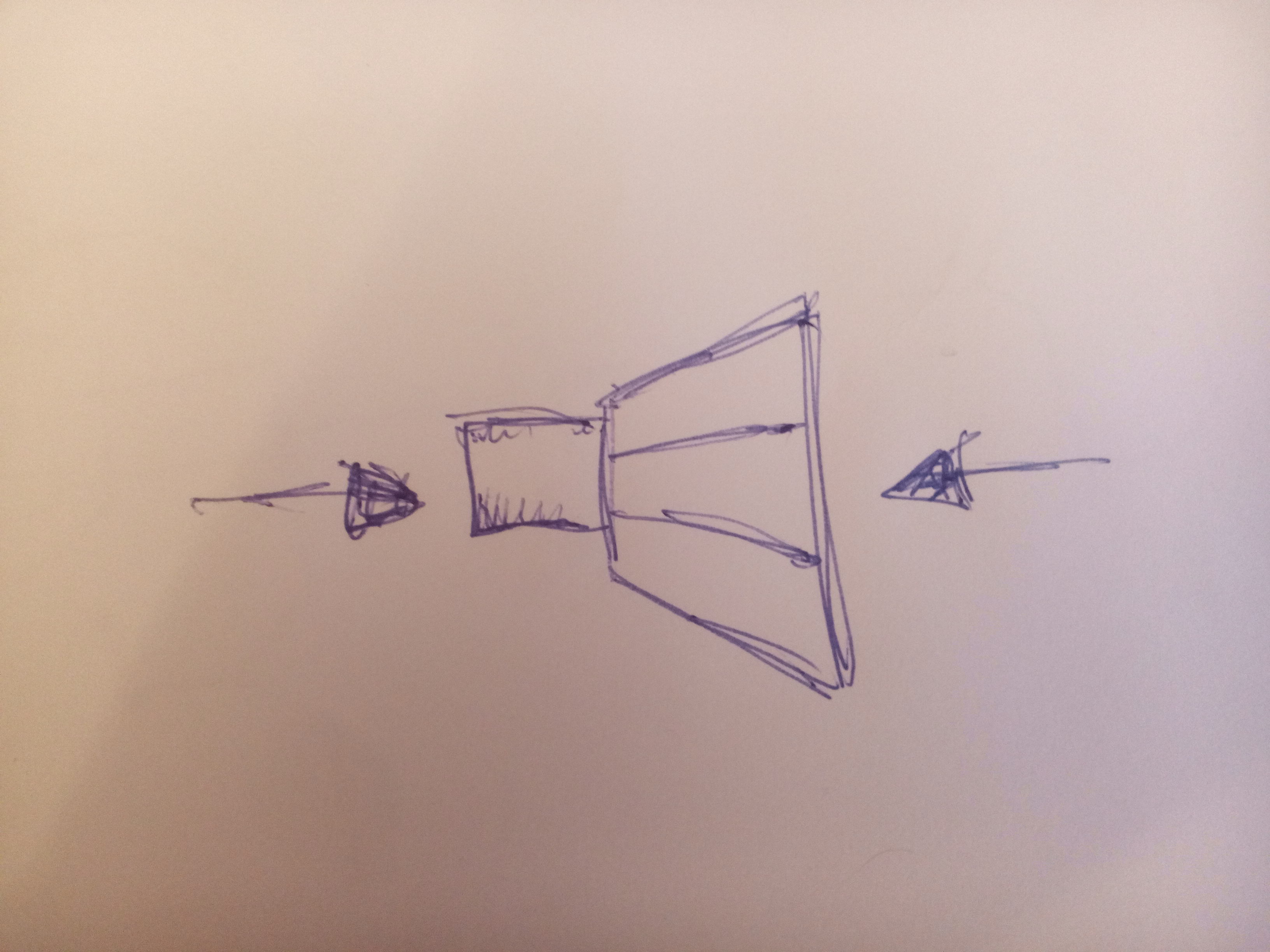

I would start with the speakers. The leaving of the requirement of 3-tones-amplification:
No multiway, no passive crossovers: circuit-salad. Too many characters, toooo different, homogenity, clearness NEVER.
No floorstand: too much surface that resonate and reflect.
No litz-wire, un-laqueured. Less diameters.
A better damping of the casings.
A better build-in of the drivers. A very complex modification of the driver - I do not know a good driver.
And so on;-)
