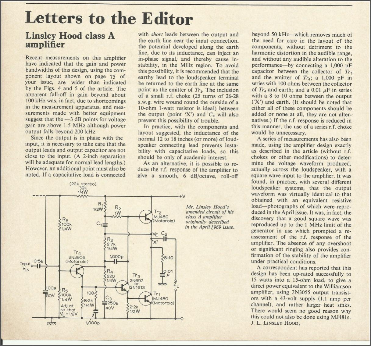

My JLH hasn't really be used since I built it - took years by the way! I find the sound too dark and rolled off. I'm using ancient single diffusion 2N3055H transistors for the outputs. I was warned not to, that it would be better to start with better output devices. I didn't listen. And as predicted, I don't listen to the amp at all. So I would suggest to others it's worth using better devices. Sanken have a very good reputation. I'm not sure why the 2SC2911 are not sounding good, it's possible that you have a little bit parasitic oscillation and you could fix this as JLH once suggested with resistor+cap shunt compensation - it's in one of the articles, can't remember the details right off the top.
There is no point using high speed output transistors that were intended for the switching demands of class AB amplifiers, in a class A amplifier. Why do you think old parts like 2N3055 are still specified and preferred in JLH amplifiers?
People who are new to audio electronics, often make the mistake of thinking you can just swap semis at will to high speed (high Ft) transistor types and all audio qualities will be improved. What is missing there is an understanding of how this also reduces stability margins. The JLH class A amplifiers are simple and have no preventive measures that would damp any oscillation, which is likely what you perceive as metallic sound quality when 2SC2922 transistors were fitted.

Gannaji - Yup, that's the one. Shows the optional compensation R + C. Something like this, done right, could allow use of faster transistors.
Ian - I think it's a basket of attributes we're looking for here in order to achieve better performance. Probably the key one is that modern devices have lower beta-droop in a design that JLH has shown produces less distortion when low beta is avoided.
