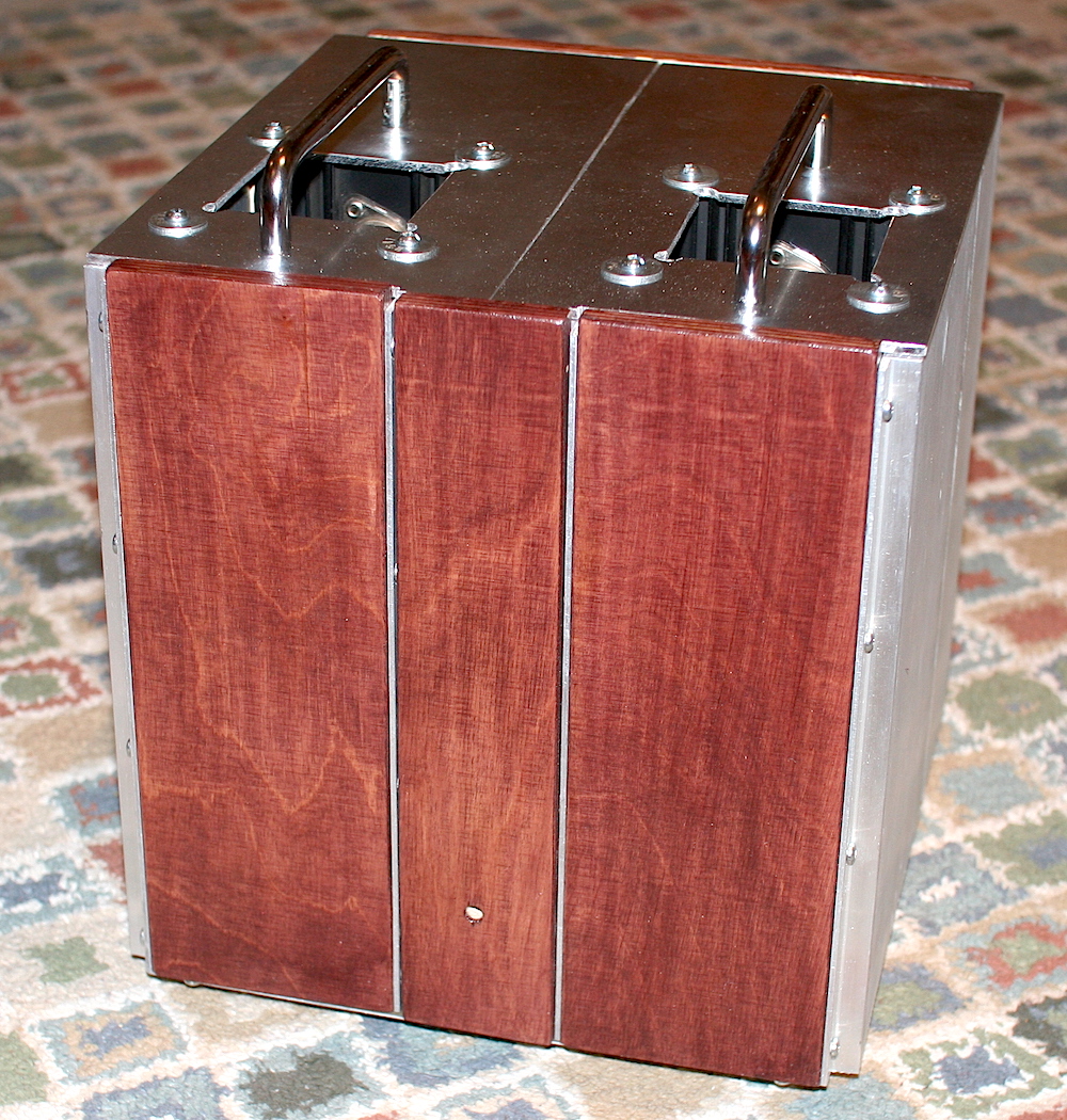

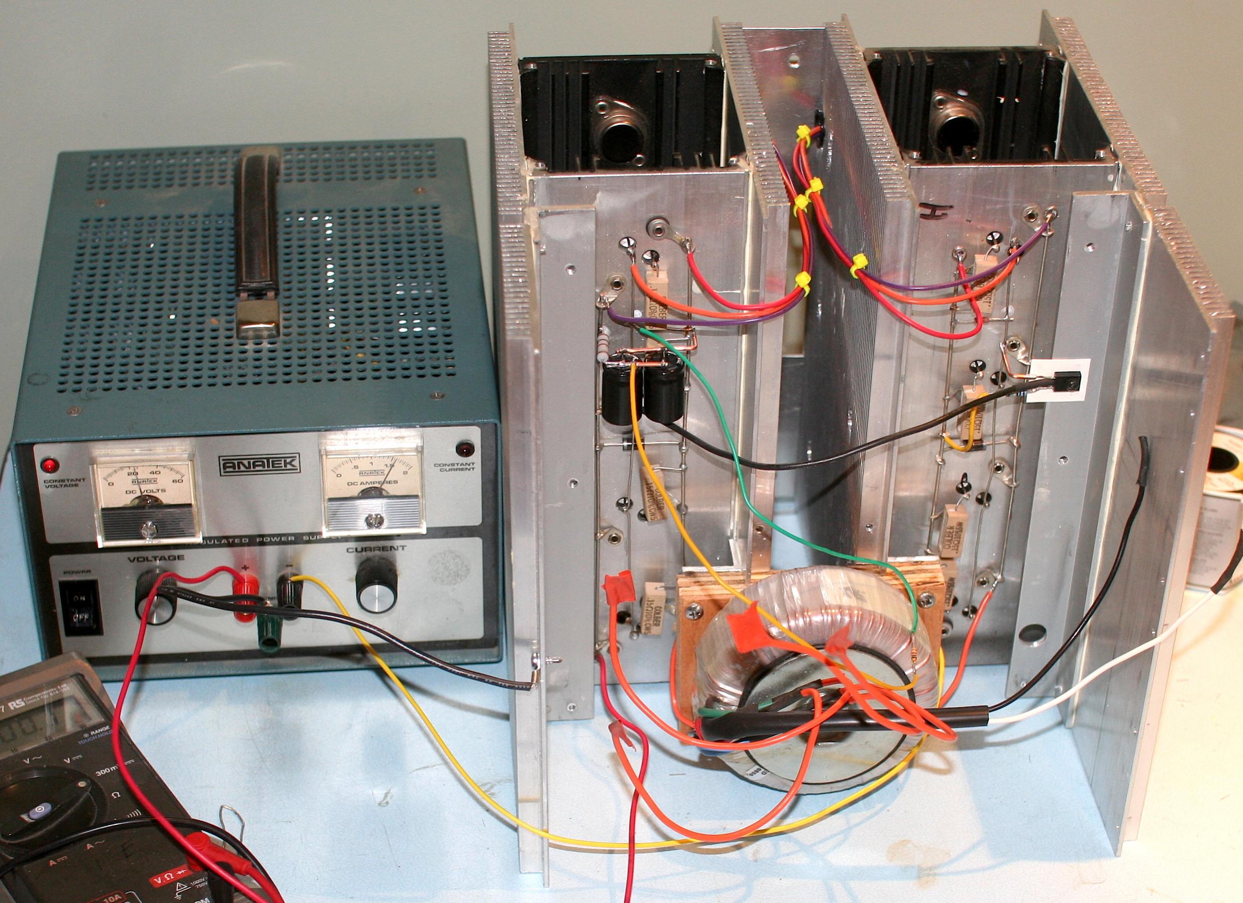

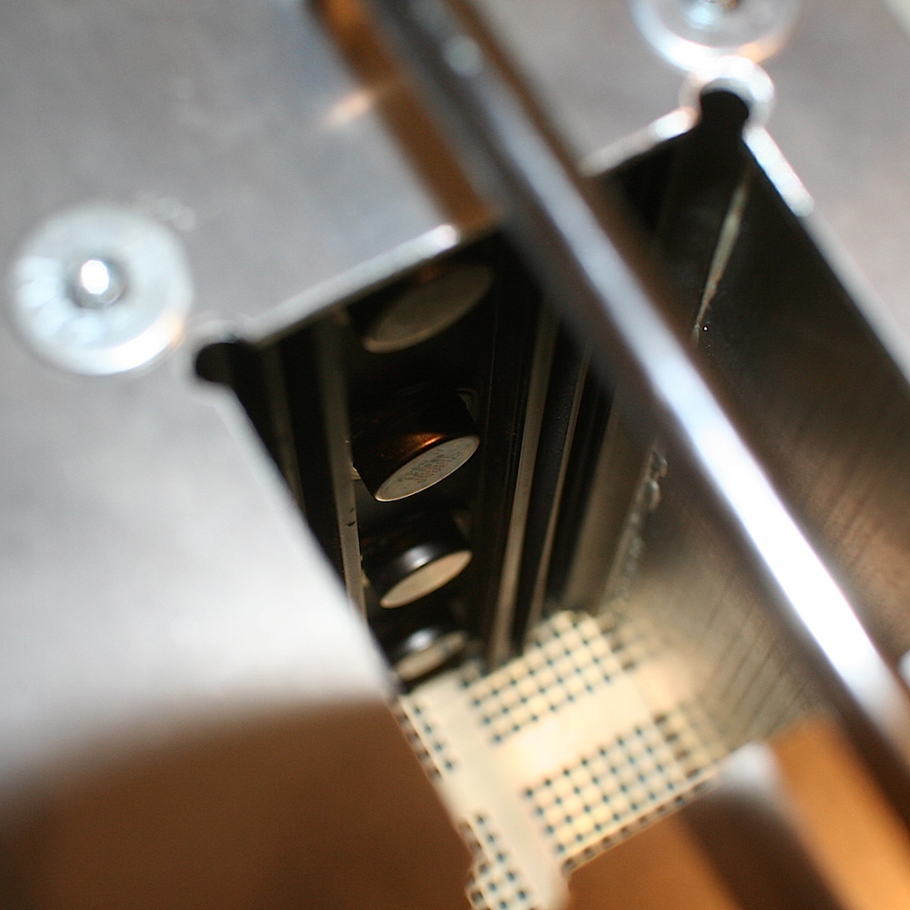

Well in my case it would be quite a large re-build. Not sure how easy it is to see from the photos but I have many output pairs (not much chance of beta-droop here) and each 2N3055H is riveted to the heatsink - yes, these were recovered from a pair of Acopian regulated power supplies. I'd have to dismantle the amp and drill out the rivets. I would not contemplate doing this unless the improvement is likely to be a revelation.
Oh, by the way, this is a mono-only amplifier - it's a tad larger than most of the 1969 builds I've see around here
These amplifiers need far bigger heat sinks and power supplies than Linsley Hood indicated in the 1969 article. I built one of these with an 80 v.a. power transformer it lasted a couple of years before burning out. I replaced it with one having double the rating and it too suffered the same fate. It is well worth doing the job properly in the interests of reliability and not have this sort of worry even if the result is something relatively large in volume and weight.
