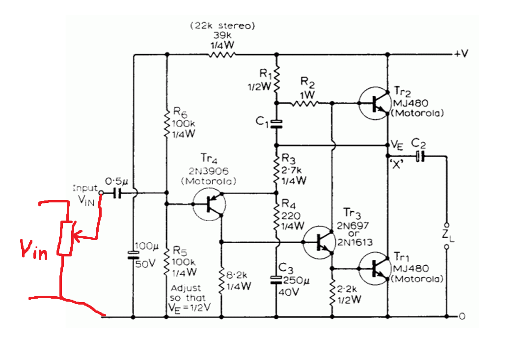

Can anyone suggest a way of adding a 'Master Volume' control - after the R3, R4, C3 combo on the JLH '69 schem?
I've got the amp running off +9V as a small guitar amp and I'm using a pot at R4 as a crude Gain control but I'd like control over the final volume so I can crank the gain - but reduce the volume at the output.
I tried just running a pot as a voltage divider between the output cap and the speaker but that's not working too well.
Thanks!

Like this. Typically the pot would be 47k (ish) for something like this.

In the spirit of DIY - why not add a gain adjust into the feedback network. I Since it is for a guitar amp some of the consequences may not be an issue.
Things to consider
- don't reduce the gain too far as this implies increased negative feedback which may make the amplifier unstable. You can amerliorate this with a small capacitor across base-collector of TR3 (try 100p npo ceramic).
- you may want to reduce or otherwise change R3 to give a different range of adjustment from your variable R4

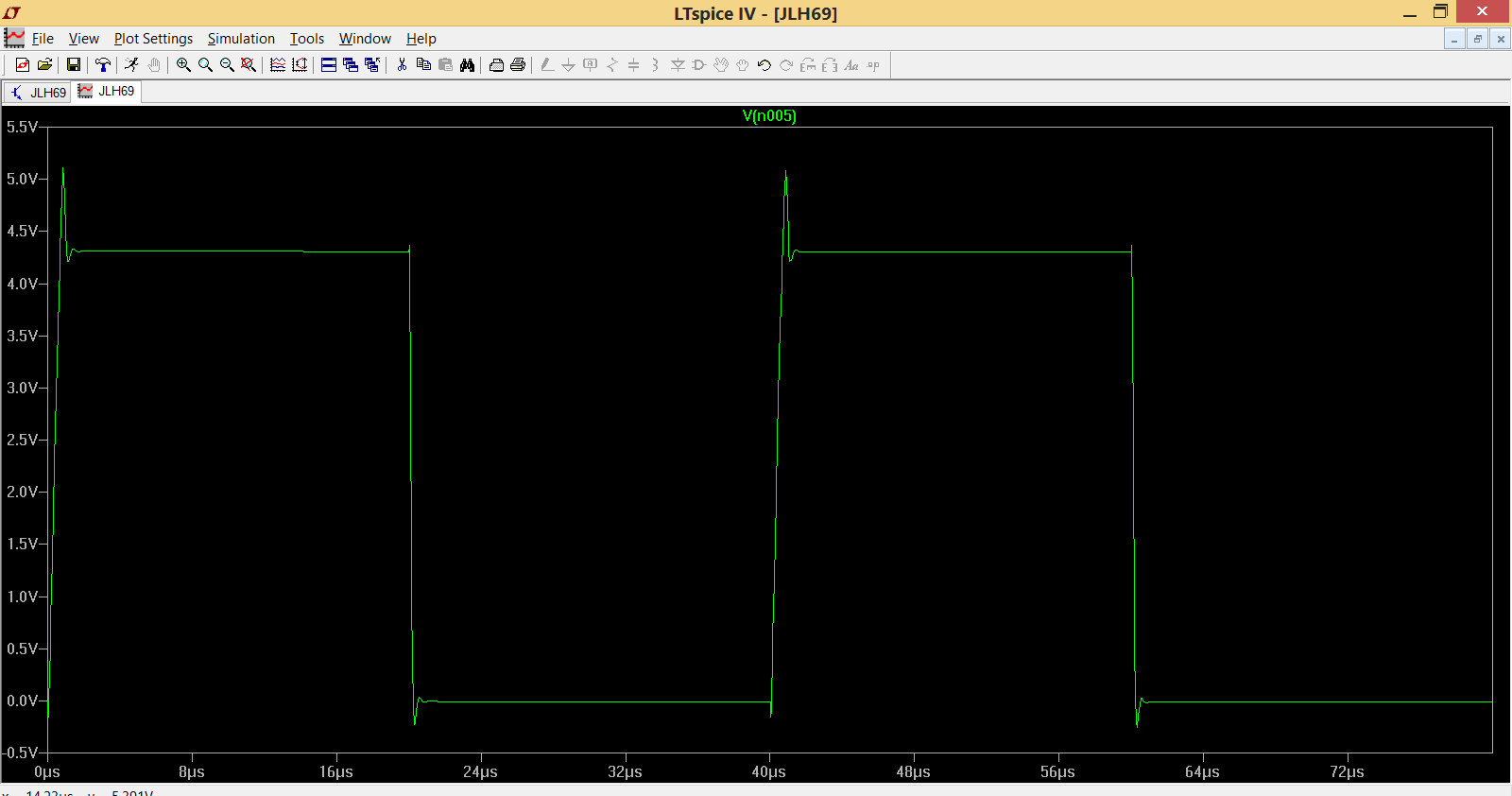

I must admit that just trying it in simulation and its acceptable up to a point. Making R4 a 22k with a 100 ohm series limiter and it does work.
This is with R4 at 22k and a 25k squarewave :eek:

Hi
A volume control in the feedback loop is generally not a good idea. It can change the stability of the amplifier. I have however used this as a balance trim in the past, but the variation in gain was limited and within the stability range.
If you use a pot in the output on the speaker, it will have to be something like 10 ohms 10W rating and at full volume could overload the amplifier (total load=4 to 5 ohms -OK if the amp can drive this, but the JLH targets a particular impedance).
Unfortunately a standard volume control on the input may not be a good idea either. The problem is that at mid-turn (anything from say 10% to 90%) the impedance is high (say 10k-ish for a 22k pot) and this can increase the distortion in the amplifier, change the frequency response (down) or even cause instability again (by changing the frequency response of the input stage).
However for the JLH design used as a guitar amp this may not be a problem in this case.
What I would suggest in general is to use a 1-transistor buffer stage (emitter follower)- or a FET buffer - with an input control so that the impedance to the power amp. stays more or less low, under 1k at least.
John

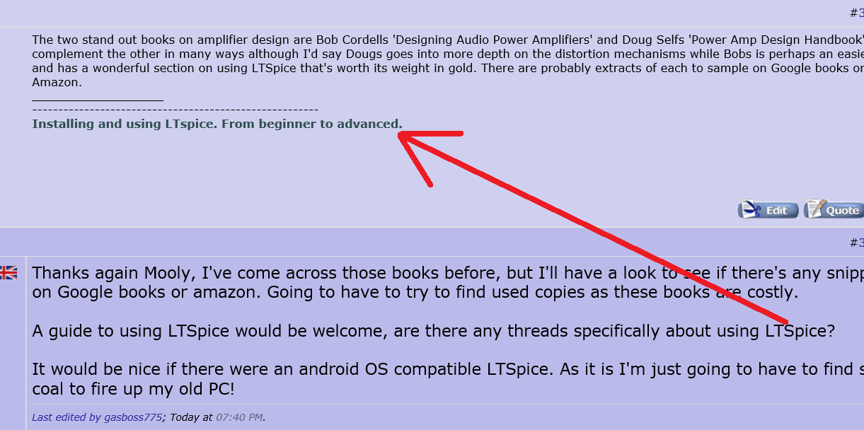

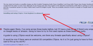

The two stand out books on amplifier design are Bob Cordells 'Designing Audio Power Amplifiers' and Doug Selfs 'Power Amp Design Handbook'. Both complement the other in many ways although I'd say Dougs goes into more depth on the distortion mechanisms while Bobs is perhaps an easier read and has a wonderful section on using LTSpice that's worth its weight in gold. There are probably extracts of each to sample on Google books or Amazon.
Thanks again Mooly, I've come across those books before, but I'll have a look to see if there's any snippets on Google books or amazon. Going to have to try to find used copies as these books are costly.
A guide to using LTSpice would be welcome, are there any threads specifically about using LTSpice?
It would be nice if there were an android OS compatible LTSpice. As it is I'm just going to have to find some coal to fire up my old PC!
Err... yes ;)
DOH!!!!!:p
But honestly, I didn't realize it was a link, dunderheid that I am!
I have LTSpice on my old coal fired PC, but never got much further than using it for schematic capture. Running simulations should help prevent me from needlessly murdering some nice transistors. I look forward to reading the thread.

How?
Can you explain how to take a sch and insert it into LTspice?
Iam not aware of any method to do this automatically, if that's what you mean. I was talking about using the program (ltspice) for manually drafting diagrams, as an alternative to, in my case, messy drawings!
If you are looking for instruction on how to do that and MUCH MUCH MORE! I refer you to Mooly's excellent tutorial;
http://www.diyaudio.com/forums/software-tools/260627-installing-using-ltspice-beginner-advanced.html
Gordon.
