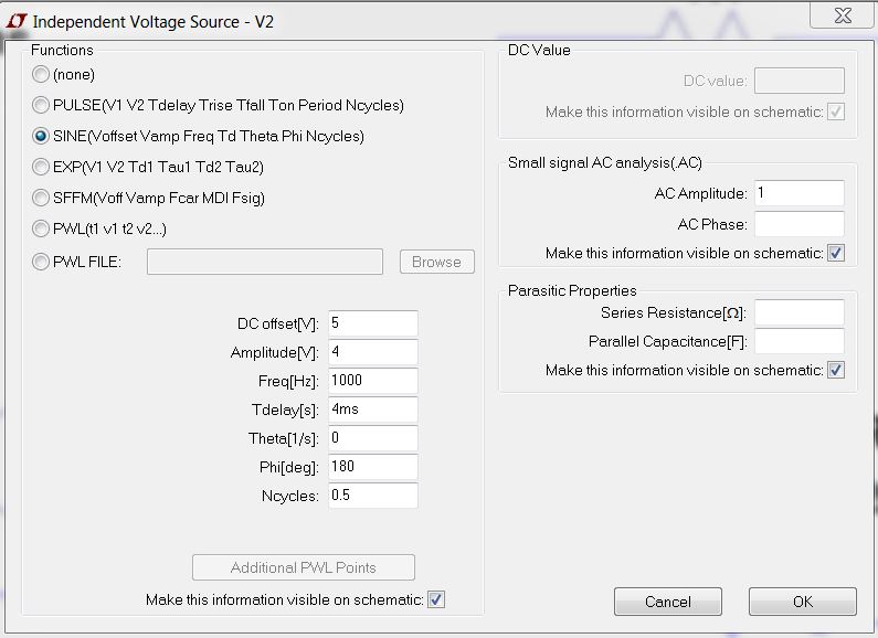

Here is the little teaser I promised classAchap... its a bit off topic but it was interesting and came about through questions asked on this amp earlier in the week.
The file is a simple (as simple as it gets) complementary output stage. Single rail of 10 volts with an AC coupled load to ground. The input is a sinewave biased "or sat upon" 5 volts DC so that we get max output swing. The output shows the classic class B crossover distortion.
So far so good. If you look at the voltage across the load and the current in the load you will see they are as expected, and in phase. Its educational to now look at the current in the output cap C1 and you can see how its 90 degrees out of phase with the voltage, the current in a capacitor leading the voltage by anything approaching up to 90 degrees if the cap is big enough in relation to the series load resistor.
If we now look at the current in the load which rises to around +160 milliamps on positive half cycles and -160 milliamps on the negative half cycles and then superimpose on that the current in R1 (which is in series with the supply) we see something that isn't very intuitive
If the input signal is now changed to a single half cycle (as shown... it takes a few seconds to run as a sim due to it being in the "dead crossover zone) the circuit "appears" to draw no current from the rail. I'll leave that one with you
