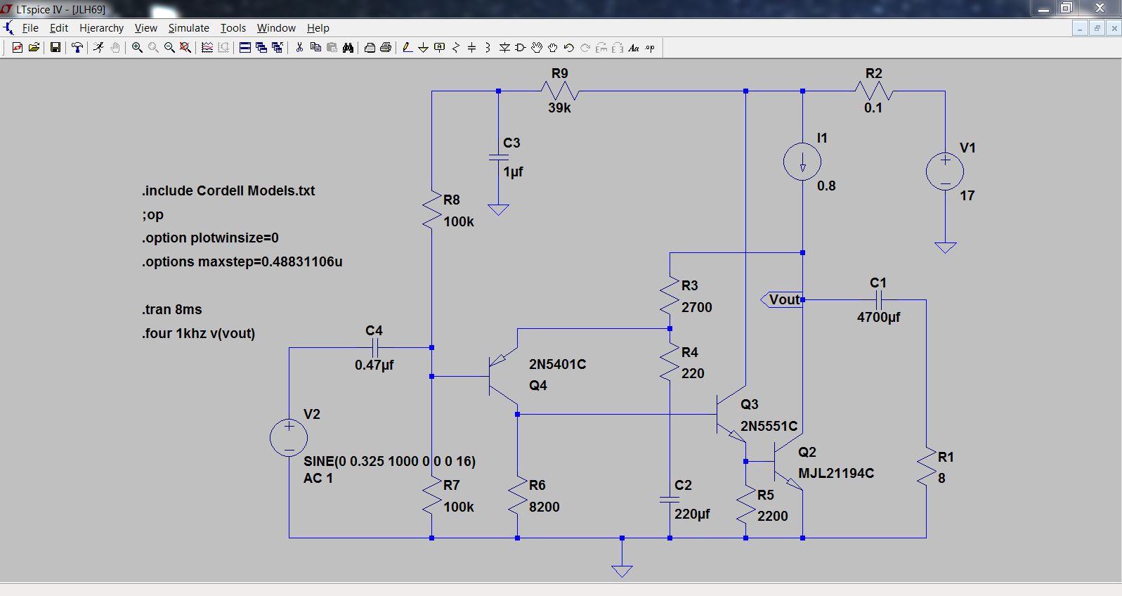

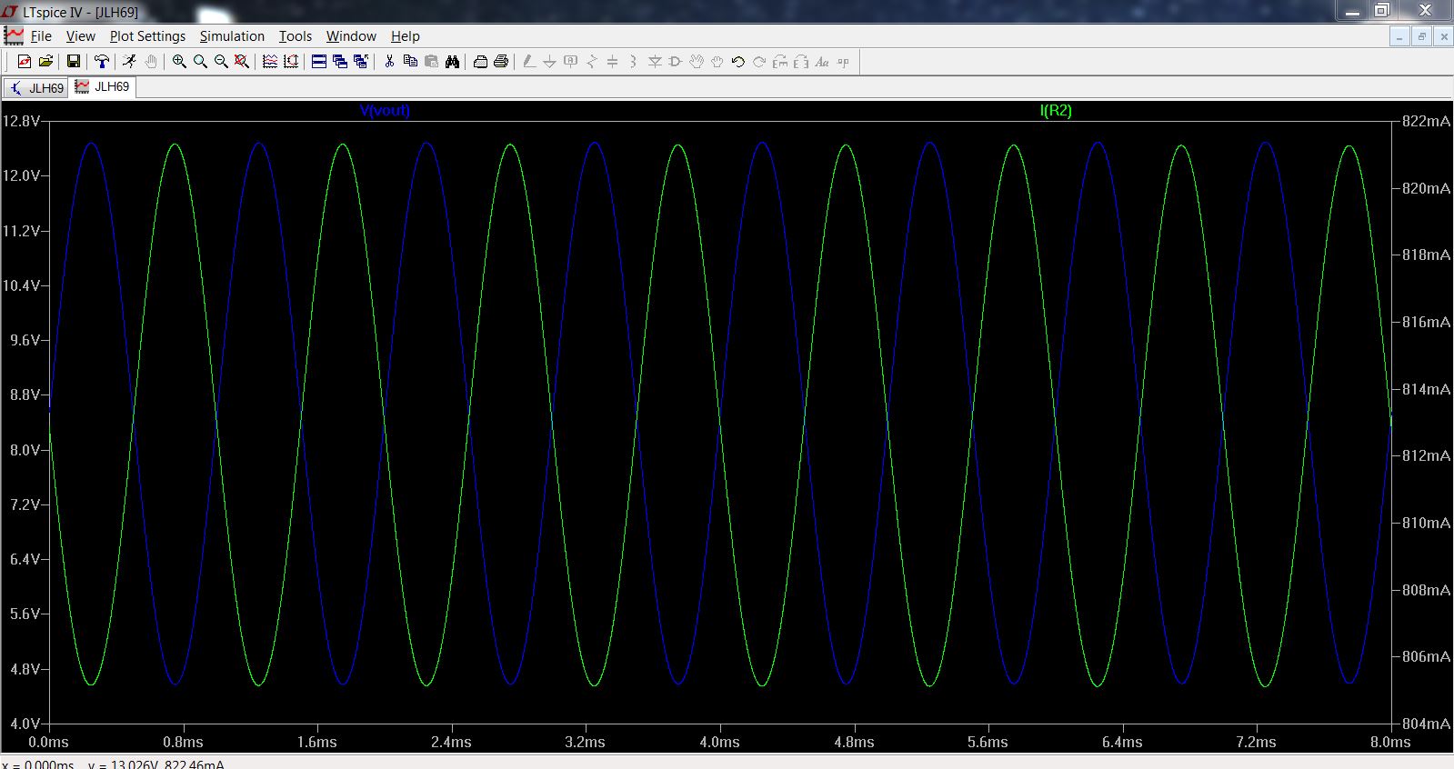

What do you make of the signal current in the V1 (17v) supply though – should that be there d'you think?
Don't quite follow what you mean
The supply is "perfect" in that it maintains 17 volts. The current drawn by the amp varies as the output voltage varies (and hence current in the load varies). This is reflected in the current drawn from the 17 volt rail.
The current drawn by the amp varies as the output voltage varies ...
Yes, indeed it does seem to – but JLH thought it didn't and he says so in several places, it's why he specified a simple PSU. I thought that was interesting and I'd certainly like to know about it before attempting a build.
Let me think about that for a few minutes... I want to try something in the simulation.
I wanted to prove to myself what was going on. I think you mean that because it a Class A amp and not push pull the current draw should be constant.
If the top transistor is replaced with a current source the supply current is essentially steady. I also modified the amp to use a simple resistor load and that to gives the large supply current variation of the original design. It also varies just as much with no load.

where the load is parallel to the output current modulating device then it is possible to create a constant current ClassA amplifier.
The JLH does have this parallel requirement. But the JLH does not use a CCS as the collector load. The CCS is a modulated type and thus the constant ClassA current draw does not apply.
There are VERY FEW ClassA topologies that have constant current draw.

It's because of the 2N3055's non-linear current gain. The peak output current is less than double the quiescent current, so you have to set the quiescent current higher than half the peak output current.As to the efficiency. Well Class A that has a constant current source is around 25% efficient and push pull around 50%. If JLH is around 33% (and I don't know if that is the figure) then I guess that implies its a half way house between the two
It's interesting to look at the collector currents of the two output devices in a sim, with fairly high output power.
Using output devices with constant (and equal) current gain, you'd get closer to the ideal 50%.
Indeed. In the file I posted some while back if you set the input voltage to 0.6 volts and first change just the top transistor to the standard library model 2N3055 and then do the same again for just the bottom transistor the result is surprising.

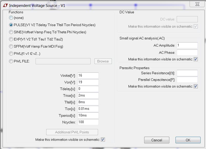

The ripple rejection of the amp is an interesting one. If you add ripple to the rail and cut the input signal you can "measure" and see it directly on the load resistor. This shows over 200mv RMS ripple voltage on the output but my rail ripple is quite high to show the effect. Non the less, this is one area the amp/PSU could be improved.

If you install LTspice here is the file that will run straight off. Just unzip the folder and keep the two files together. If you want to try it and get stuck just ask...
OK. I've tried it and I'm stuck!
I'm looking at the current at node V(out) (JLH 'X', Tr2e/Tr1c). This is Q1 emitter, Q2 collector, C5 o/p (JLH C2) and a couple of mA from nfb loop. These should all sum to zero but at peak output I get:
Q1e = -1.58A
Q2c = 0.42A and
C5 = - 0.99A
which sums to 0.17A ??? (expect slight variation)
I must be doing something wrong please can you check?
BTW I turned V2 amplitude up to 0.64 to get full drive.
Most of that is the current through C1, the bootstrap capacitor. Plus a couple of mA through R3.These should all sum to zero but at peak output I get:
Q1e = -1.58A
Q2c = 0.42A and
C5 = - 0.99A
