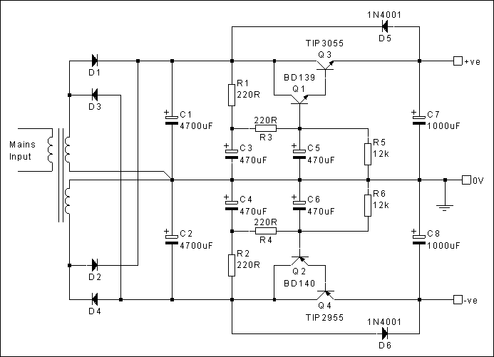

For my peace of mind in my fully DC linked designs I have resorted to a DC sensing circuit that switches off the amp if the averaged DC at the o/p reaches about 1.4V which - even with 4 ohm speakers - will only generate about 1/2W worst case

Yeah - saw that one but in the end I designed one that didn't include switched outputs - because we expect / hope that this will be a very rare event that this circuit will actually switch I elected to simply have the amp turn off which means the relay can switch the mains - a less critical connection in terms of impacting audio quality.
The trick is to find a relay which doesn't degrade the sound to much when it is connected into the signal path. I tried a Velleman kit with my JLH some years back but it added a hard, metallic quality to the sound. I eventually settled on a circuit which shuts the amp down by reducing the power supply rails to almost nothing via small relays connected in the voltage regulator circuit of the power supply. It works like a dream and doesn't degrade the sound.
Tim.
Would you mind sharing the circuit? Sounds interesting to say the least.
Is the soultion fast enough for protecting the speakers on e.g. a dying rail?
Thanks, MArco
Geoff Moss kindly provided me with the circuit. It is based on a standard detector circuit similar to that used in Rod Elliot's project 33 speaker protection circuit. It does not provide any time delay/muting at switch on.
The protection circuit is powered from the +ve rail via a fixed regulator which is fed from the +ve rail just after the reservoir capacitor. During a fault the amplifier is effectively shut down as the supply rail voltages are reduced to close to zero by a double pole relay which simultaneously disconnects the base of Q1 and Q2 (in the attached diagram) from rest of the capacitance multiplier circuit. The protection circuit remains powered until it is 'reset' by manual switch off/on. The circuit 'fails to safe' so Q1 & Q2 are disconnected during power down also.
My capacitance multiplier also includes a CCS voltage regulator which is not shown in the attached but I imagine the disconnection of the base of Q1 & Q2 would have a similar effect with or without this. I believe the circuit will give adequate protection under most scenarios.
Tim.
