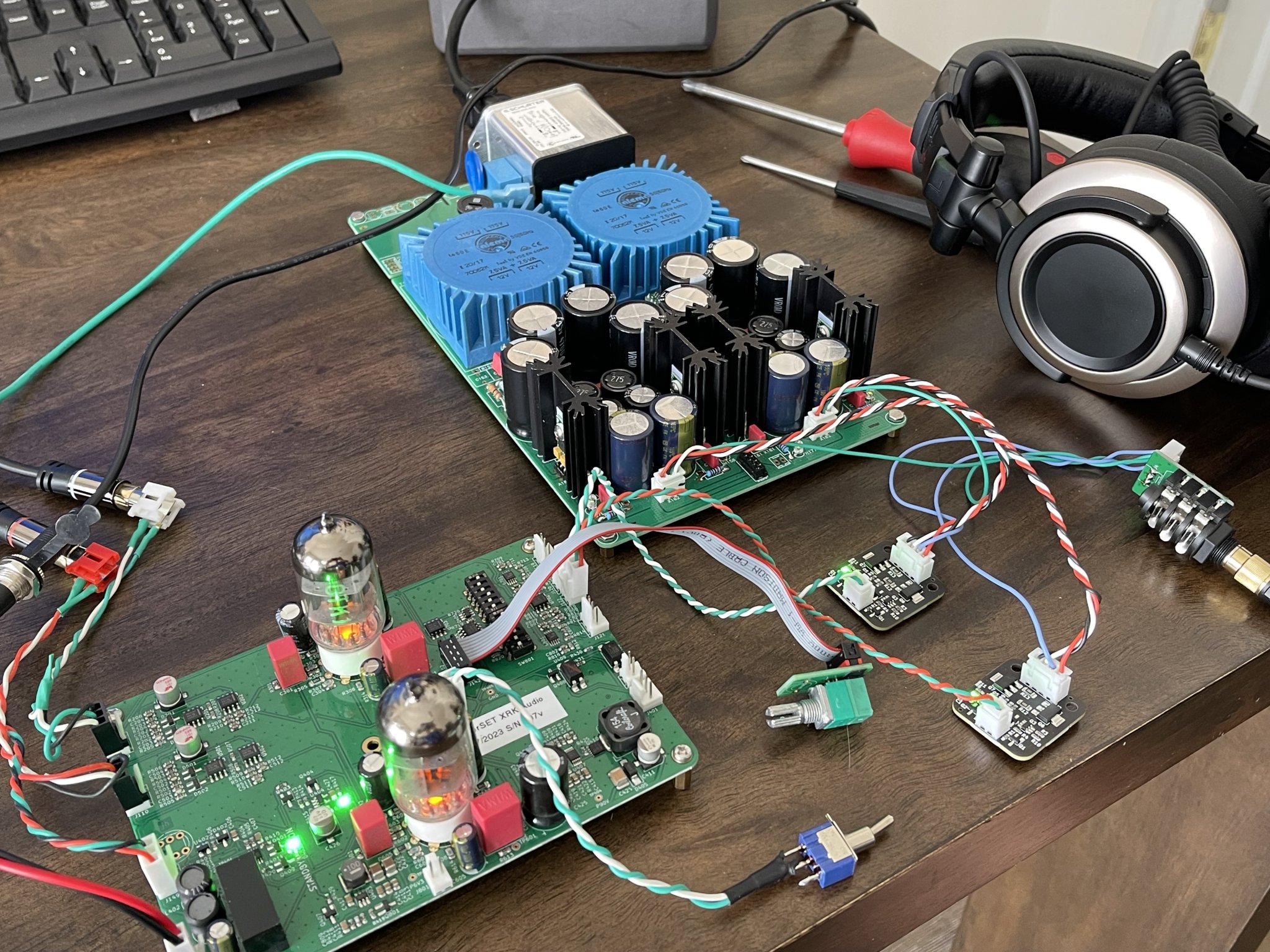

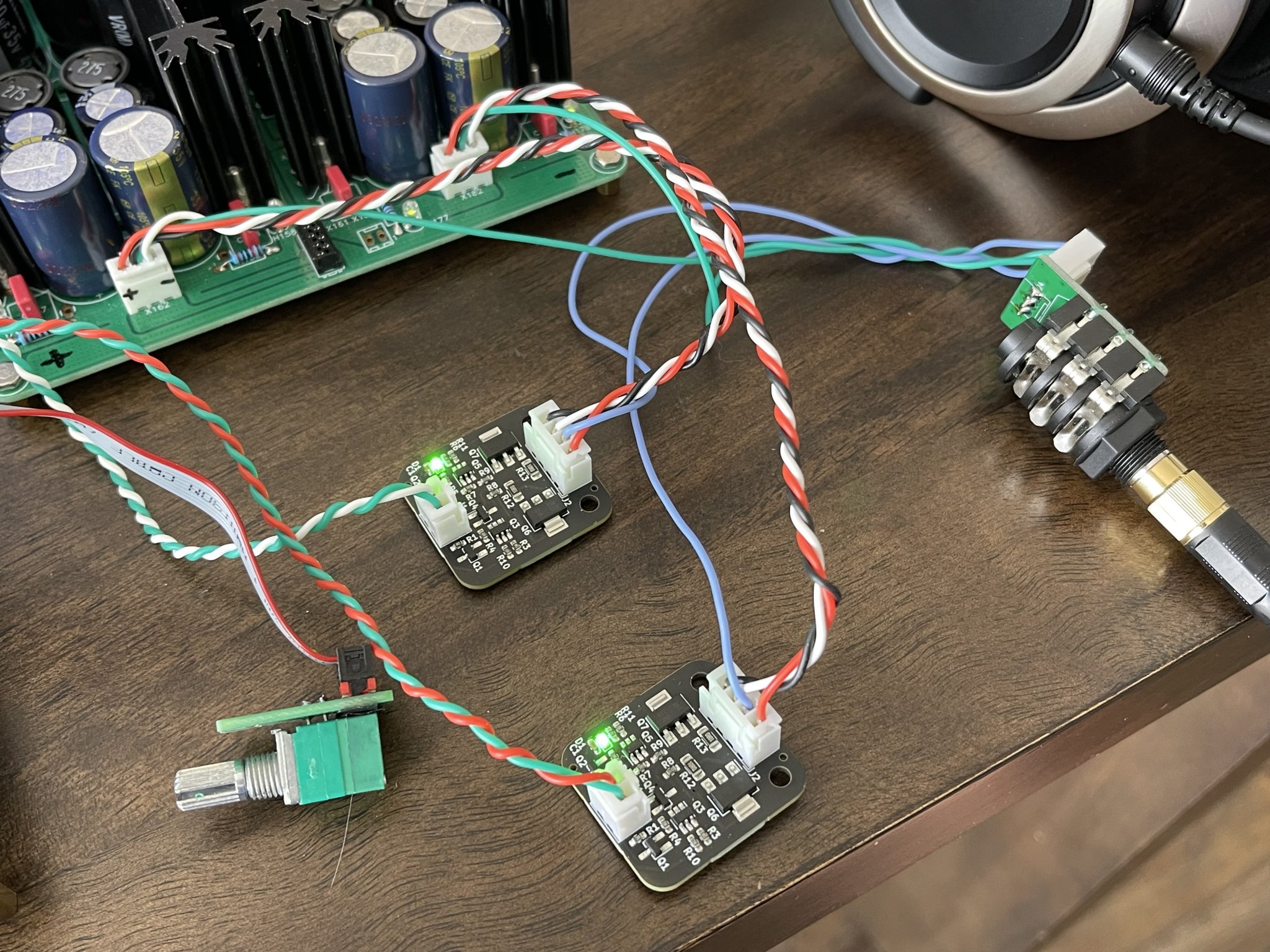

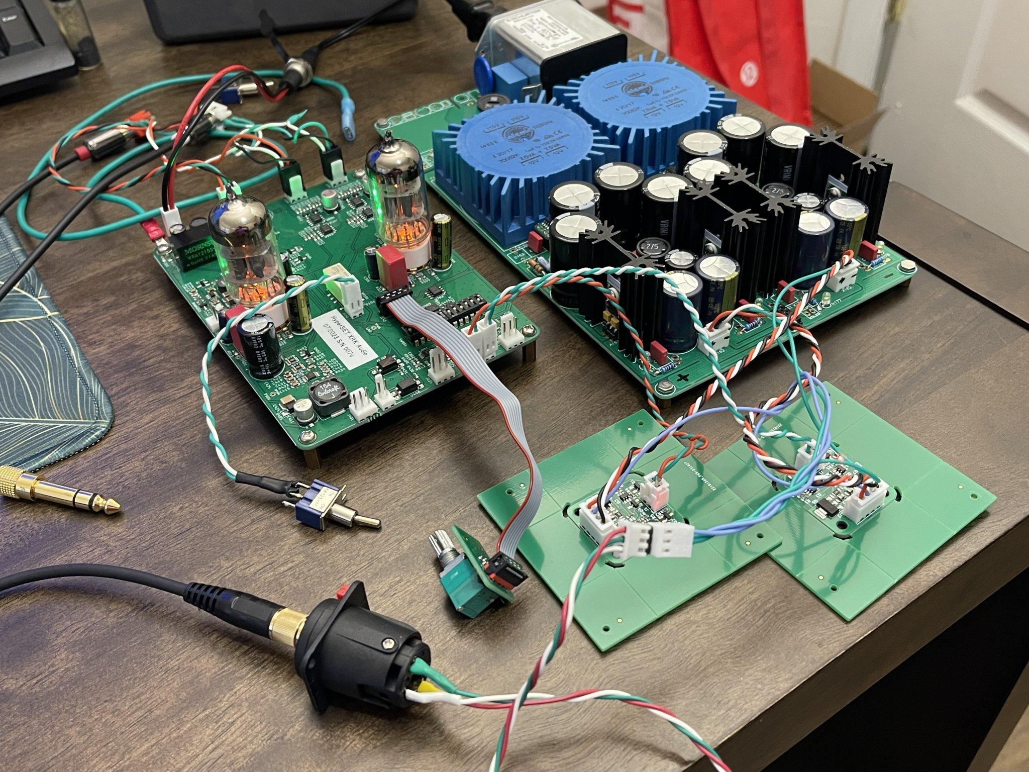

Here are samples under test as a high performance headphone amp output stage. Here, the diamond buffer is being driven by the HyperSET tube buffer set to 14dB gain and the +/-20v PSU is provided by the Yarra Mk I linear PSU with active bridges, a CLC, and TI TPS7A4XXX low noise regulators (one of the best linear preamp/headphone amp PSU’s that I have):

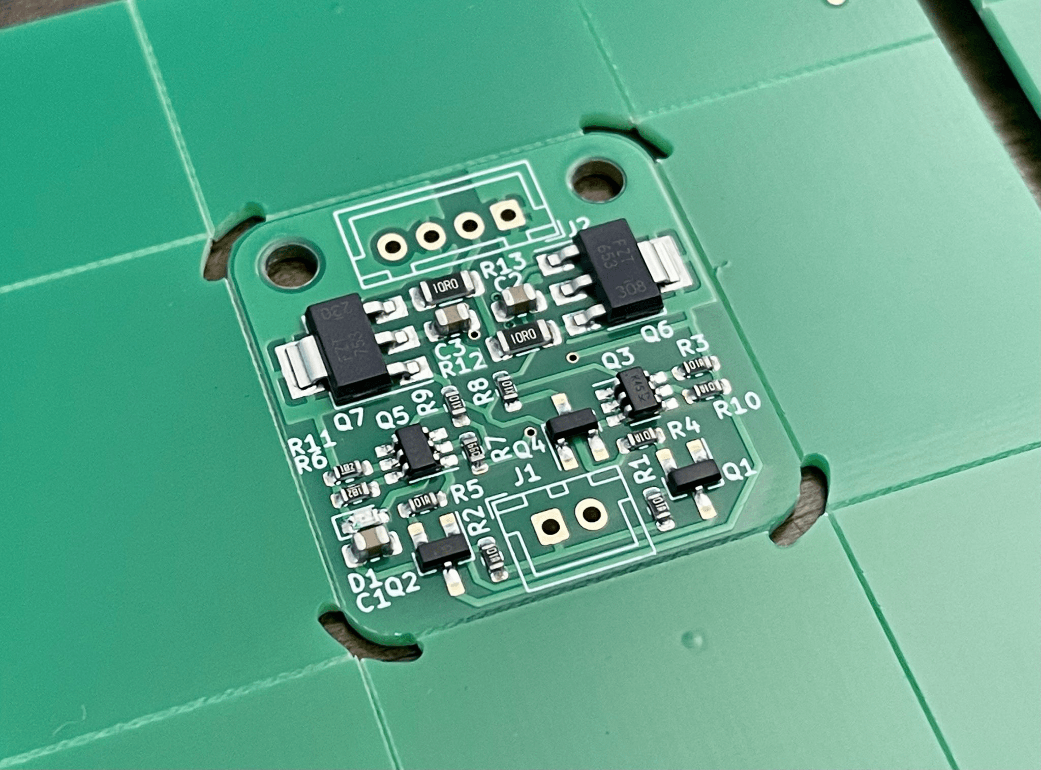

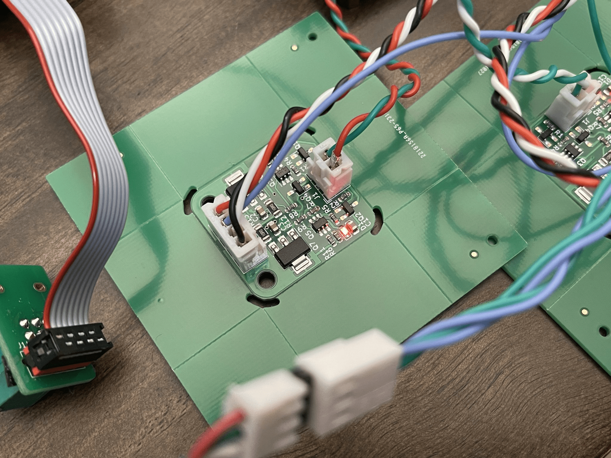

Edit Nov 24, 2023 - Black Friday: The PCBA’s arrived and I have tested them and they work well but I discovered that I mistakenly had the board house install a red LED in place of a green LED (this was one of the parts they substituted that I did not catch). The red LED causes the bias current through the diamond input stage to be about 40% below the 1mA nominal value. It works fine for most applications but if you want to drive high voltages into lower impedance loads, you could swap the LED out with a hot air pencil). But as I said the board works fine but is not perfect and still very useable and nice sounding, so in the spirit of the holiday season, and following what we did a few years ago with the Xmas Amp, I will offer these diamond buffers fully built and RTR for FREE (while supplies last). You will need to pay for shipping (auto-calculated from my Etsy shop). I will put the link to order shortly.

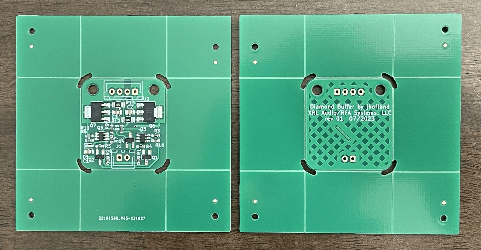

Boards will be 1oz copper ENIG finish with green solder mask. Sold as fully pre-assembled pairs with high quality genuine parts. You only need to install the through hole input and output connectors of your choice.

The boards arrived from the PCB assembly house. They look great and sound great. However there is a red LED in place of a green one. This was a substitution the assembly house made that I did not catch. It means the bias current in the diamond input stage is about 40% below the nominal 1mA. But it works well for most applications unless you need it to drive high voltage swings into low impedance loads. It’s easy to swap out the red LED with a hot air pencil if you want. The boards are still very functional and a nice buffer to have on hand. But due to the mistake, they are not perfect so I will give them away for Free as the Xmas Diamond Buffer while supplies last (1 pair per member, please). You will need to pay for shipping (auto calculated per my Etsy shop). It’s appropriate that the LED glows red in color for the holidays!
