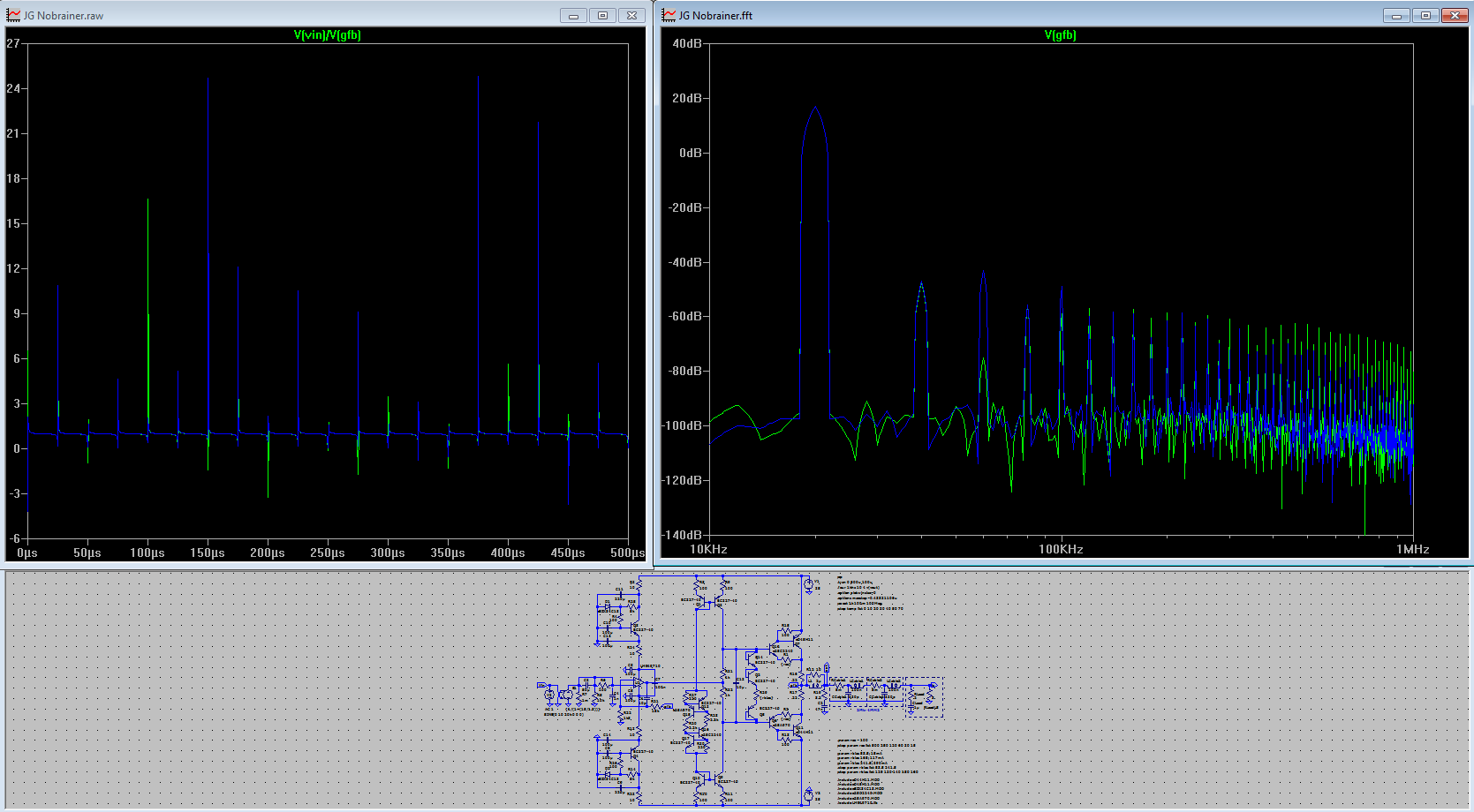

attached is my sim-file.
It´s based on #389, but with stray parameters on all caps and a different sim algorithm.
Up to 0.8V (rms) input voltage it sims well, but from 0.85V on the Spice Error log increasingly lists these messages "Heightened Def Con from x to y".
Its accompanied by spikes on the current through Rmes2 and tthe current mirrrors and distorted collector currents of the CFP drivers.
So far I have no idea what may be wrong with the sim.
Compensating the CFPs didn´t change the spooky spiky behaviour.
Calvin, can you please post a complete sim-file including referenced sub-model information not standard for LTspice (like the potentiometer). It would also be nice to have the plot files/specifications included.

the models are those attached to Your file Frans.
The Poti can be omitted with alltogether. Its not used in the sim.
Its just a relic of my Sim basic parameter file which I use as starting point for nearly all of my sims, so I don't need to type it all over again and again.
The poti files may be copied from the LTSpice Yahoo group, as well as many other models, for example a THD-Analyzer for THD over frequency or THD over level.
The mentioned sim was a transitional sim at 1kHz or 10kHz with different sine input levels.
Just probe the currents and voltages around the Bias spreader and output stage to see the spikes and distorted wavefoms coming up at input levels >0.8Vms.

unfortunately not yet.
It seems not to be a matter of Frans´current source, as the effect also occurs with a resistor or a simple JFET CCS.
It rather looks to me as a problem of the driver of the CFP starving and eventually cutting off.
Btw. regarding Frans´s sim in #335.
What is the source of the OL-gain-peak at ~40-50MHz?
As the OPamp is compensated it could be a matter of the current source or rather a oscillation of the CFPs.
Somhow using the middlebrook probe in my sim the peak doesn´t occur.
Have the transistor models been changed between #335 and #389?
