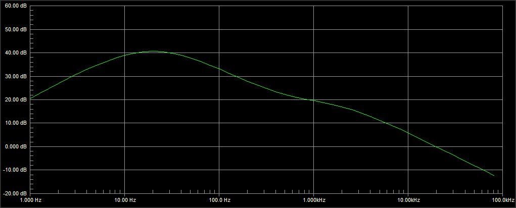

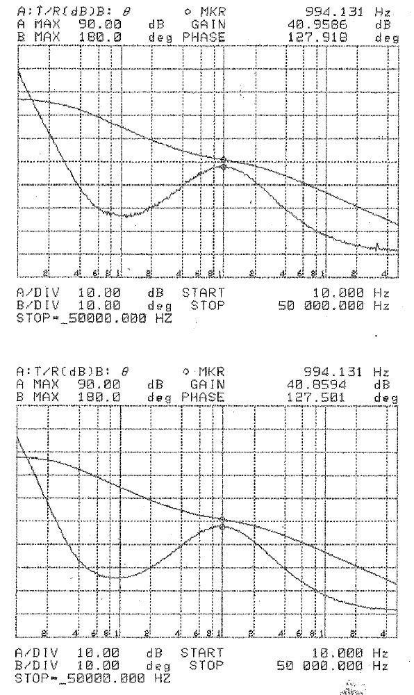

I finally managed to snag the cap values I needed, so I was able to change out the RIAA equalization network and get the 1kHz gain close to 40dB at 1kHz, which is what I like to see for home use. Attached are the gain-phase plots for both sides of the RIAA preamp with the new equalization values - matching between channels is still pretty close (~0.1 dB). I'll continue with these equalization network values for further experiments.

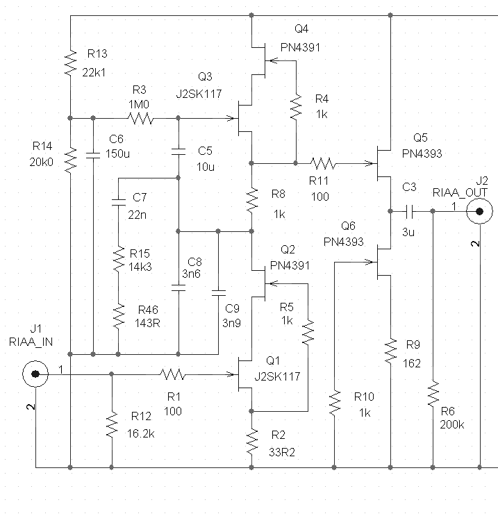

Here is the RIAA circuit with the new equalization values to bring down the gain to ~40dB at 1kHz. The caps are a mixture of store-bought (Wima FKP2 PP film/foil) and scrounge (polystyrene laid-in lead units from (?) and TRW). I'll be listening to this thing sooner or later, and will report on the results.

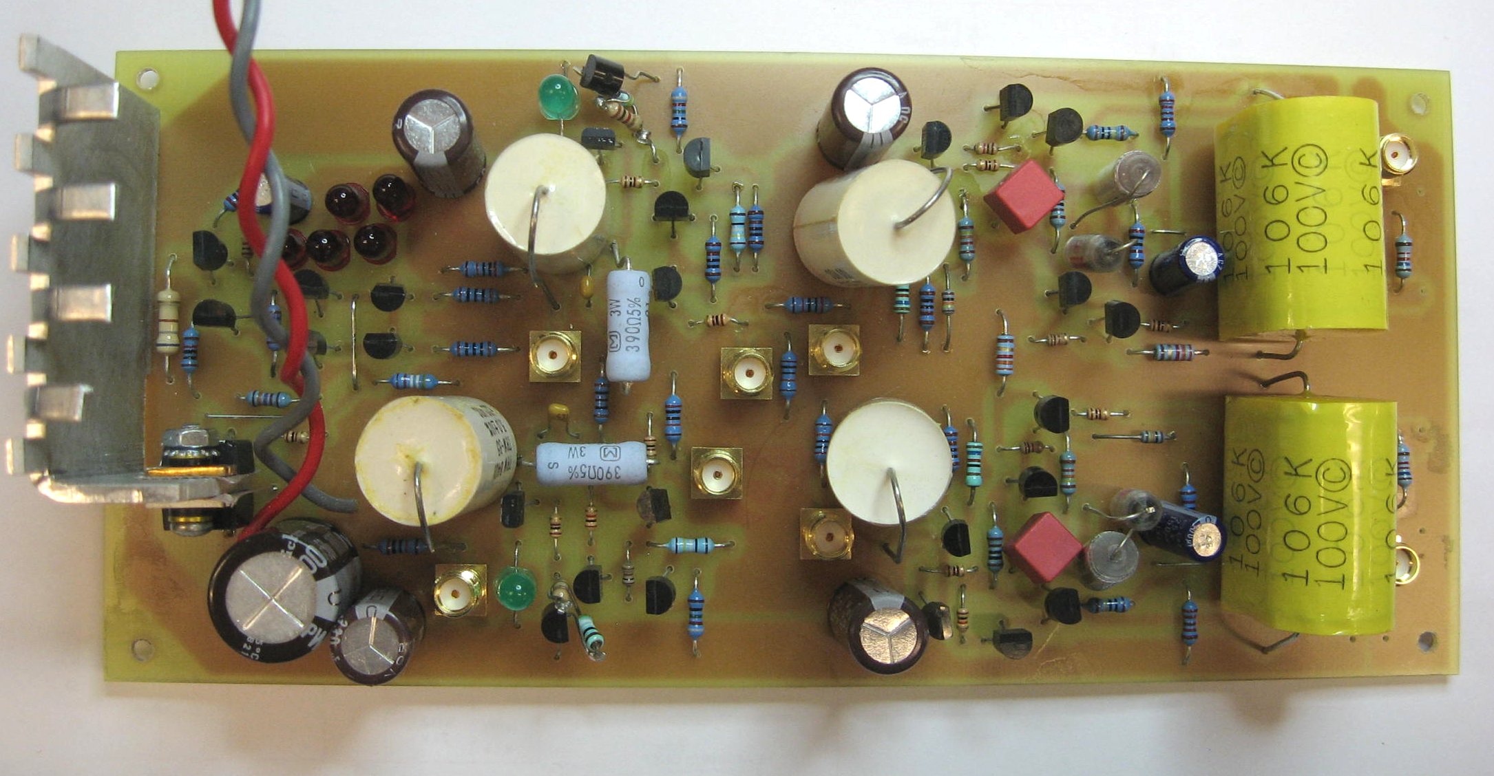

I spent some of this evening doing the soldering on the studio version of this preamp, which will feature a lower gain RIAA stage for the hotter broadcast cartridges, and a unity gain line amp stage that will eventually drive output transformers for a balanced feed to the studio A/D converter.

I just put the home version of the RIAA/Lineamp all-in one package into my living room test case and powered it up for an hour or so with a bench supply to check for bias stability - all's well so far. Next thing is to hook up all my components and let it play - fingers crossed, as I've done a fair number of measurements with a lot of equipment except for my ears...

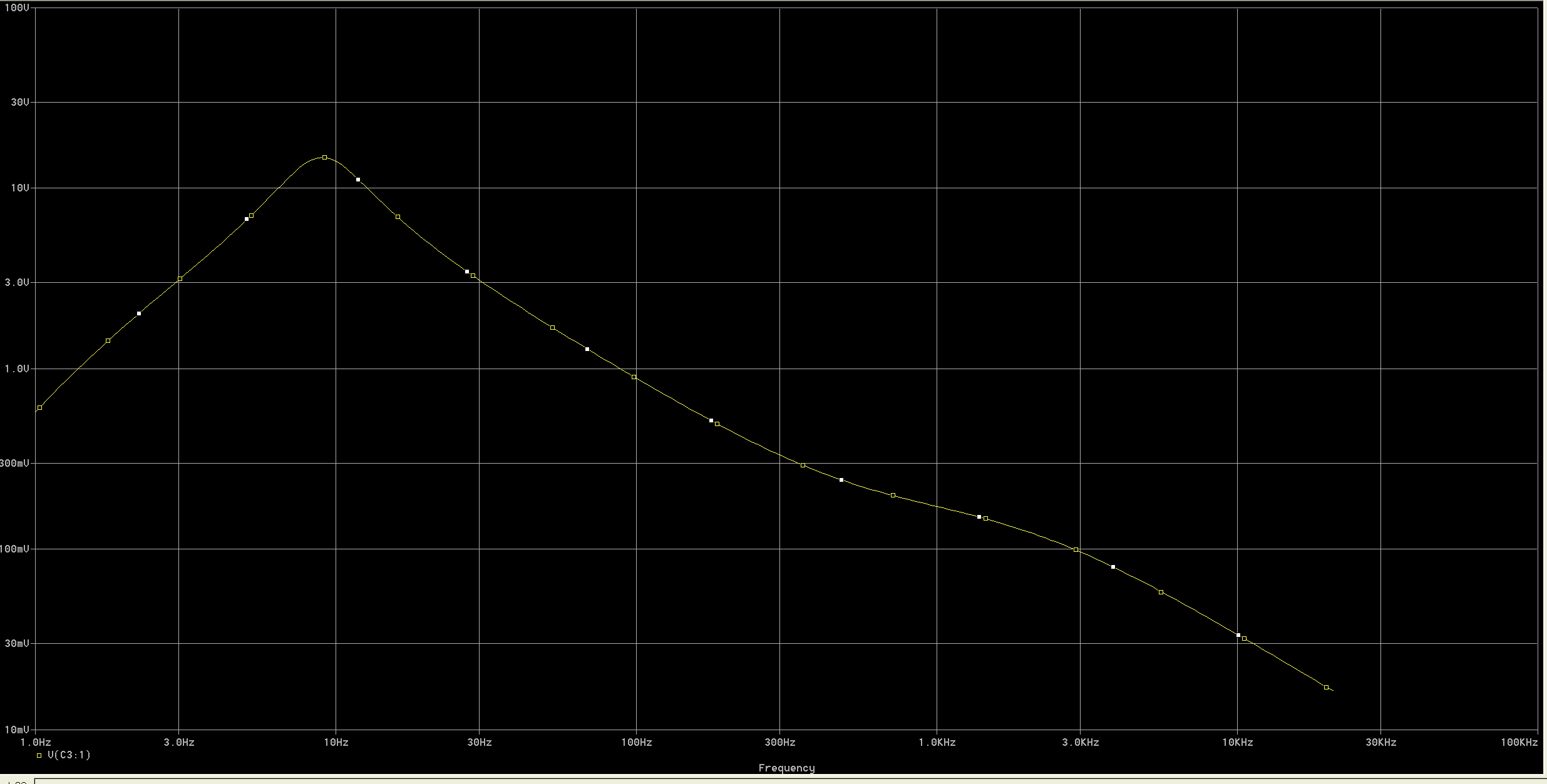

I made a remark that it didn't appear to make any difference in the position of the 10uF coupling cap between top and bottom stages of the single stage SRPP preamp - well, it looks like I'll have to eat that remark.

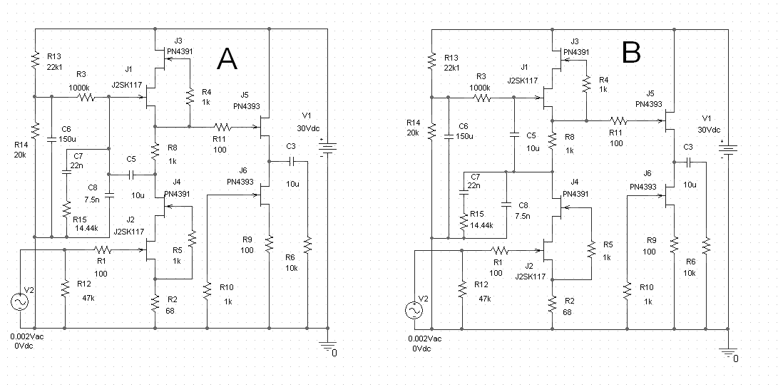

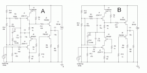

Attached is a pic with the two schematics in question, the being the position of the 10uF interstage coupling cap. Casual inspection would make one think that there would be no substantial difference in the frequency response of the two circuits (marked "A" and "B"). Simulation and real-life test indicates otherwise.
So you know what I'm talking about, the attached picture shows the two schematic variants in question. They vary regarding the position of the 10 uF interstage coupling cap (C5) vs. the RIAA comp network. The connection difference is subtle.

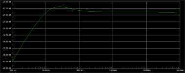

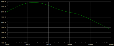

Attached is the freq response from circuit B, the first variant I tried - notice the peak near 10Hz, and how high it is. This combined with the tonearm resonance and some acoustic feedback (turntable isolation is pretty lousy) had my woofers flapping around like Dumbo's ears. Very disconcerting...

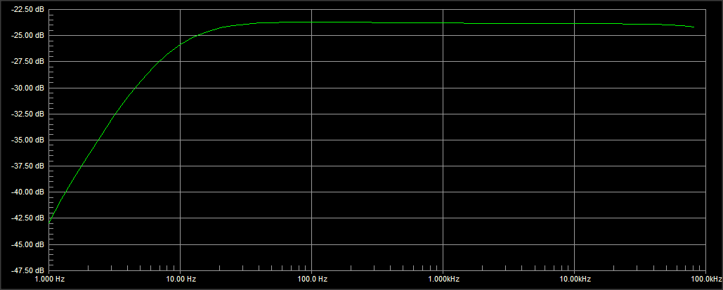

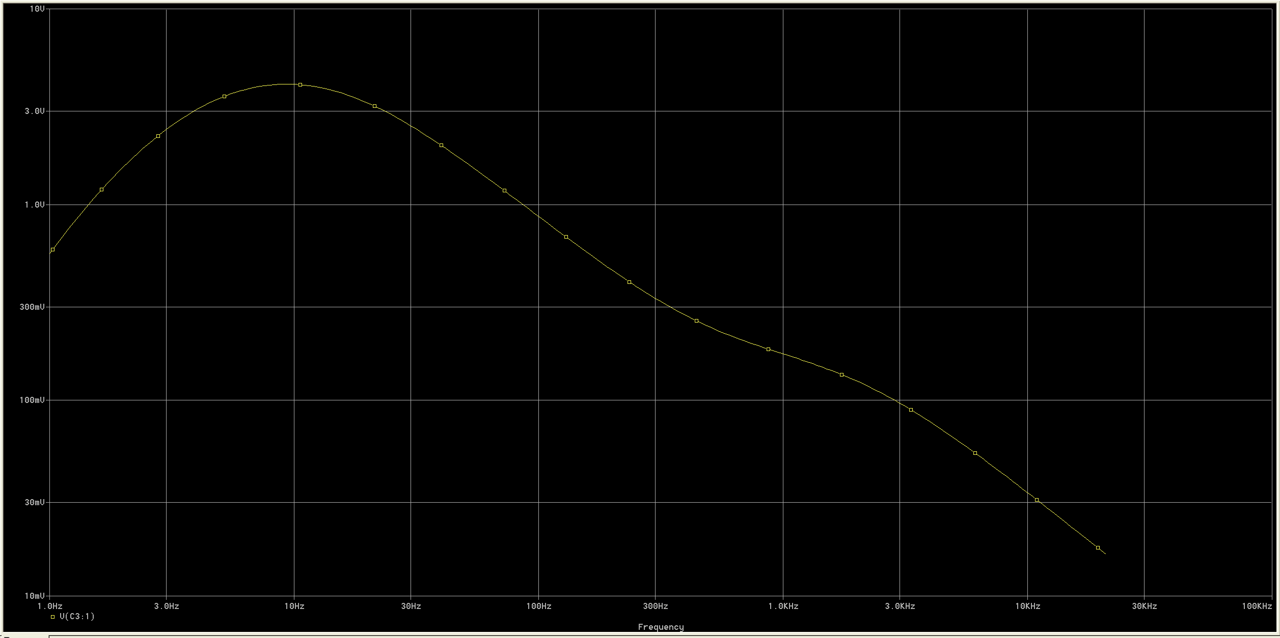

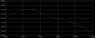

Here is the frequency response for circuit variant "A" - note that the 10Hz amplitude is lower and that the plot looks like a LF round-off rather than a resonant peak. The actual circuit (cut and jumpered into shape) is much more well-mannered, though Dumbo will still flap his ears if the volume is high enough, indicating that there is some turntable damping/isolation/resonance tailoring left to do.
This is just an initial remark, but we are used to thinking of things in terms of voltage dividers. If you consider the circuit as a frequency-dependent current divider driven by a voltage-dependent current source, the differences between the two circuits may make more sense. Surely the cascoded bottom jfet can be modeled with a good degree of confidence as a current source - after all, that's what cascoding is about...

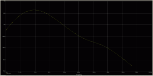

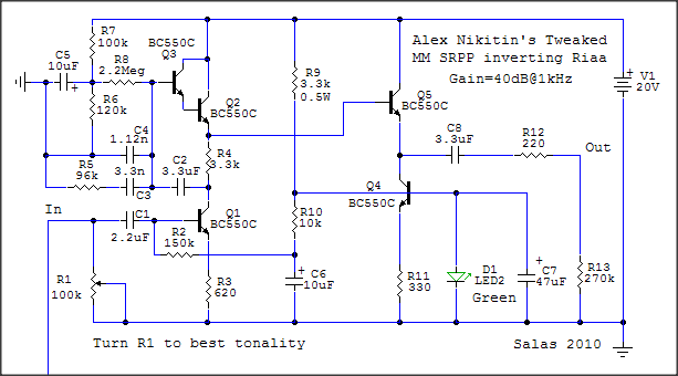

Surely the card worked without VLF exaggeration, and here is the simulation of the tweaked circuit I had posted in another thread. Attached here again for quick reference.
Well yeah, the circuit you show (and the original Creek preamp) has the coupling cap configured like circuit "A", which has the smooth roll-off (shown in post #212) without VLF peaking. Try switching the coupling cap (C2) around in Nitikin's circuit so that it's like "B" and see if there's a difference - I'm curious.
I'm also wondering if the cascoding I'm using makes any difference. If I have time tonight, I'll strip the cascode first from the top jfet, then the bottom, and see what happens. The circuit you show has no cascoding at all. If I remember correctly, the better Creek circuit cascoded the bottom jfet, but not the Darlington on top.
Very mysterious, it looks like the two implementations in your case are pretty close to identical, with a smooth low-frequency roll-off and a small gain difference. This is what one would expect from a casual look at the circuit. I'll have to try the same circuit you did in both "A" and "B" variations to see if I get the same answers, as we look to be using different simulation engines (PSpice/Orcad in my case). If I get the same answers as you, I'm going to try monkeying around with the cascodes on my circuit to see what I get.
