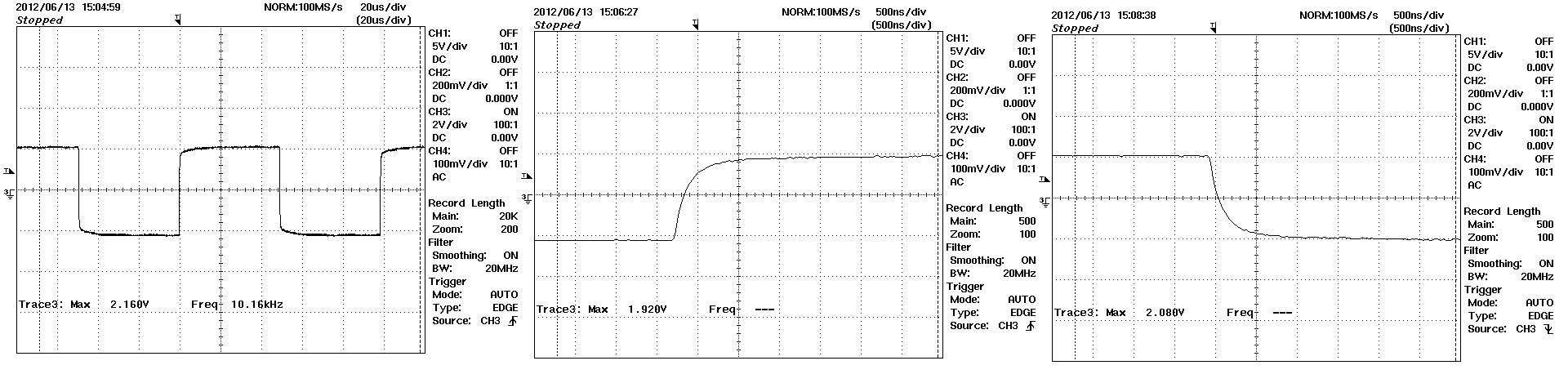

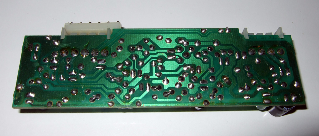

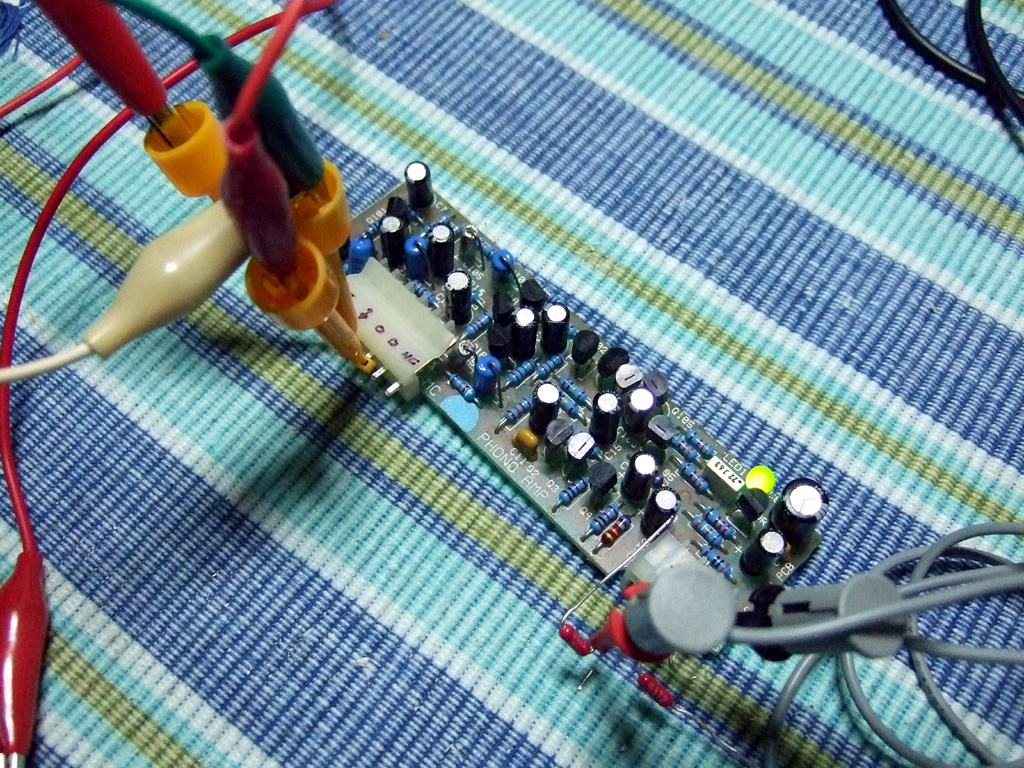

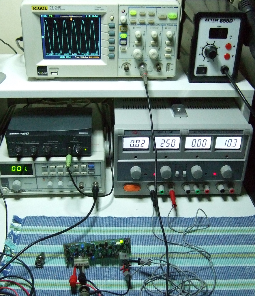

I owed pictures... Found the card in some box. Took gain measurements too. Its 54dB indeed the MC one (not SE designated). I.e. expect 250mV RMS from a 0.5mV MC cart. Seen driven with 1mV for 500mV RMS in the pics. Negative sine peak gets clipped at 6VRMS. At 8VRMS sine is clipped up and down. Input load is 220 Ohm.
Well, looking at the components on the board, I certainly ain't writing home about it. Trying to wring MC amplification levels out of a single stage was an exercise in hubris (though no doubt the accountants were all weak in the knees about the cost savings). I'll confine my efforts here to MM-type signal levels, where this design makes much more sense. With cascoding and a low capacitance/low noise fet like the 2SK117, it makes a whole lot of sense for broadcast-type cartridges that have upwards of a Henry of inductance (look up the specs for the Stanton 680 - it'll make your hair stand up on end..).

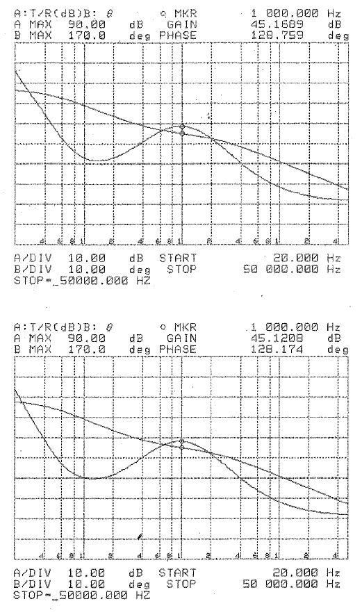

Here's the response of the SRPP RIAA section of the preamp. The channels are very well matched, though the 1Hz gain is rather high ( I like to see ~40 dB at 1kHz). If I want to fix that, the answer would be to scale up the RIAA EQ network a bit. I'll do that if I can find some appropriate cap values at the surplus stores. The capacitance will go up by a little under 2X, and the resistors will go down by the same factor. At any rate, it's a start.
The close matching is very pleasing, as I didn't work exceptionally hard to match the fets (the ones that need matching are the bottom fets of the SRPP stages).
Another option for taming the gain might be to replace the 2SK117s I'm currently using with the PN4393. These have similarly low input capacitance, but lower transconductance. The noise might be a little higher, but that's probably not a big deal for the intended application.
