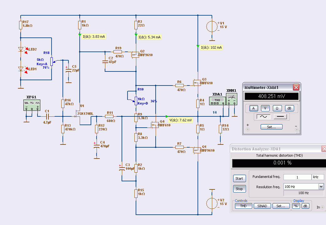

I did setup a Headphone Amp in spice.
I used IRF610/9610 TO-220 output and same transistors for VAS.
Driven by a VBE-multiplier based on IRF610.
Bias was 100mA Class A.
There is no need for big LATERALS for a headphone amp.
The good thing is that people has got 2SK170 and IRF610/9610 at home.
(Of course one could build a normal Fetzilla
and use a Headphone output jack.)

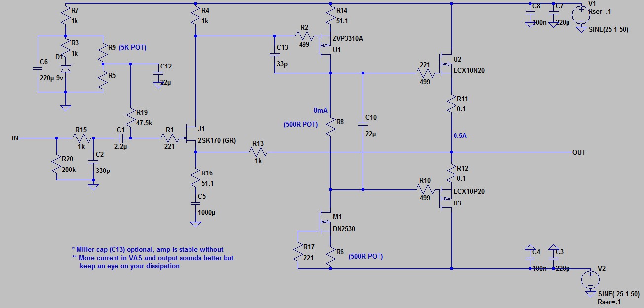

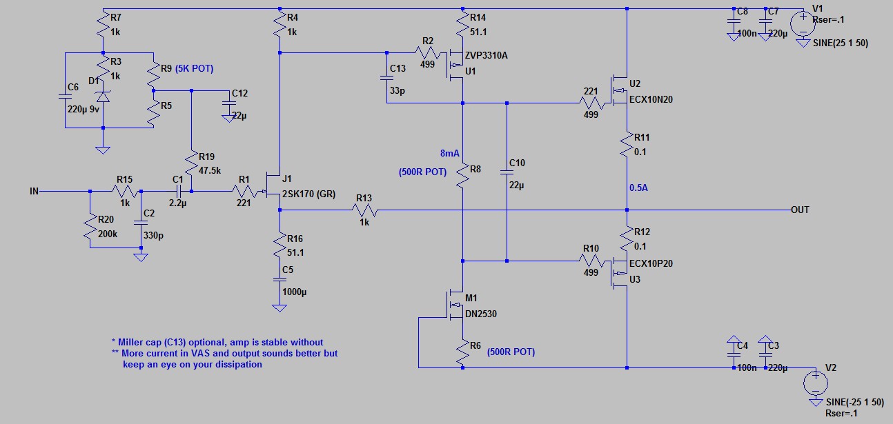

Current (and best so far) schematic
Thanks Miib.
All,
Here is my current schematic. Same as last time except for the 22uF bias spreader cap. The amp sounds truly exceptional in its current state. The bias spreader cap has really cleaned up the treble and removed a slight hint of harshness that was there before. Sound is also a bit more fluid and relaxed.
If you can deal with the heat and decreased life, more current in the vas and output is better but the values I have posted are a good compromise.
On the agenda for this week is the construction of what I believe will be the best and penultmate version (as per Hugh's PCBs), with supply rail filters for the low power stages and a special new hybrid bootstrap/ccs VAS. Also, a new device for the VAS which is ideally suited to 20mA current but has far nicer parasitic properties than the IRF9610.

Mikelm, Stan,
Please try placing a good quality 22uf electro across your bias spreader. You won't be disappointed. I think you will be very, very pleasantly surprised as I was 5 minutes ago.
Stan, this will fix your treble issue, I promise.
Thanks to Hugh and JLH for the inspiration.
Edit: someone please tell me why this works!?
Hi Greg,
I replaced the bias spreader (1uF film cap) with a 22uF 50V bipolar electro cap - Hitano brand from my parts bin, I think it is better than the polar electro. I also increased the gate-stopper of my ZVP2110 from 200ohm to 330ohm, the treble is smoother.
The input capacitance of N-type (600pF) Renesas L-MOSFET is much lower than the P-type (900pF). I am currently using a 180ohm gatestopper for N & 200ohm for P. I may change it to 270ohm for N & 180ohm for P.
Cheers, Stanley
Hi, Stanley
You are right - if you are aiming for the same rolloff at output mosfets (gates) you must use a bigger gate resistor for N-ch because of its lower Cgs. 270R for N-ch and 180R for P-ch seems fine. You may try also 240R for N-ch and 150R for P-ch (even with a small theoretical imbalance).
regards,
Tibi
Stanley, I endorse Tibi's comment. I had thought 470R and 330R, but I suspect 270/150 is better. It is not always realised that the gate stopper can be used to tailor the subjective bass response of the amplifier - the difference is astonishing.
Thanks for bringing this up, it's important!
Greg, the 22uF bias spreader cap works by firmly holding the control voltage at the point of turn on and turn off of the output devices. The larger capacitor means that the bias voltage is completely unaffected by charge migration into and out of the mosfet gates, and it's value is so large and the time constant so slow it tends to remove the oscillatory transition during switching. Result is more defined drain current, better control - and more HF resolution.
