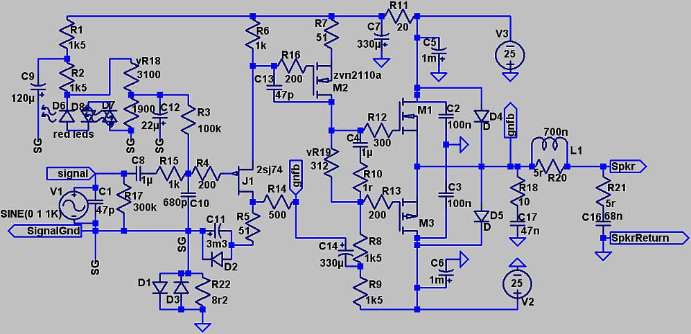

NfetZilla the "inverted" version
my version of NfetZilla attached. Note the polarity of the supplies !!
1k0 drain load for 2sj74 is currently 500r, drawing ~4.5mA. The device is ~8mAIdss. I will try 330r once I have music coming through. That will increase Id to ~70% of Idss.
Input bias wiper sitting at -2120mV relative to Signal Ground.
Output bias resistor set to ~285r for ~290mA of quiescent bias.
At this higher output bias the drift in output offset is greater. +30mV at cold start up, to -5mV fully warmed up. Varies by +-4mV.
With input shorted the DVM reads -5.1mVdc and 0.0mVac
With the input open circuit the DVM read -5.1mV and 0.1mVac or 0.2mVac.
Sorry, my component numbering is all over the place.
R12, M1 & R13, M3 are swapped. The 300r is on the 2sk1058 and the 200r is on the 2sj162.

The kind of oscillation I described was load-dependent oscillation. This can occur with an amp that has good phase margin, as Sonnya says.
There is more than one cause of oscillation. Miller compensation address only one of these causes. A Zobel addresses the other. One way to avoid needing a Zobel is to decrease open-loop gain.
It sometimes works to increase miller compensation to a very large value, to make an amp stable into capacitive loads. However this will slow the amp down and destroy it's good performance. This is because miller compensation isn't effective for capacitive loads. It is more effective to decrease open-loop gain or use a zobel.
SWF, maybe you could try the amp with capacitors going from 1nF upwards to see what range destabilizes the amp?

As for the design here in this thread, the mosfet is lot better than BJT in handling the capacitive load.
The Zobel network is hard to get around. In my design with 5 pairs of EXC10 i have a bandwidth of 2MHz, and it is stable with an Zobel of 10nF+3.3R (4.8MHz)
Without the Zobel it is not stable, but the Zobel will not load the outputs in the audible range with those values.

I agree on that. But if the amp is prone to oscillation in the SIM, it is most likely to be the same in real world. And that have to be fixed in one of the following ways.
1) Minimize the influence of the Zobel and if present LR series.
2) Or redesign the amp, so that they can be removed or at least minimized.
With 10nF it will load the amp with z=159R and 100KHz, and z=795R at 20KHz.
If this impacts the sound, then there is something seriously wrong....

Hi Kean,
the Pi version of the Output Thiele Network is shown in post1404.
By convention R18 & C17 (R+C) are referred to as output Zobel.
Thiele showed two versions ot the Output Network.
Both had the series connected L//R.
Version he seemed to show more often had the R+C to ground after the L//R
The other version had the R+C before the L//R.
Cherry went on to show that the two Thiele versions were the limiting values of an infinite range of Thiele Networks.
I decided to try the Pi version since that seemed to offer performance gains from both sides.
I simplify the analysis by looking at near infinite frequency. Treat each capacitor as zero impedance and the inductor as infinite impedance, (yes I know that parasitics enter long before we ever get into the RF band never mind approaching infinity) as an effective HF load
The R'+C followed by L//R" simplifies to R' when no speaker cable is connected and becomes R'//R" when a capacitance exists between the speaker terminals.
The other version of L//R" followed by R'"+C across the speaker terminals shows an HF load of R"+R'" when no speaker is connected and R" when the speaker terminals are connected with a capacitor.
The Pi version shows an HF load of R'//[R"+R'"] when the speaker terminals are not connected and R'//R" when the terminals are capacitor loaded.
Note that at HF all the versions show a basic R as the load. It is that R that helps maintain stability of the amplifier at HF.
