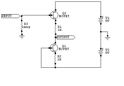

B1 buffer discussion
And this is where the original article can be found:PassDIY B1
I removed the input switching and also didn't use a volume control in front.
looks like an easy build. just have to find matching 2SK170's. some of the values need to be adjusted. I dont think R1 is needed if running on batteries. C1 and C2 can be lowered to 100uf. C101 can be a 10uF electrolytic to save space

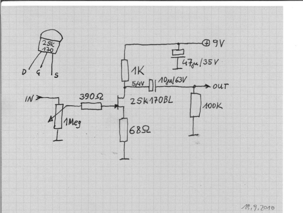

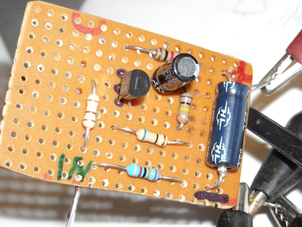

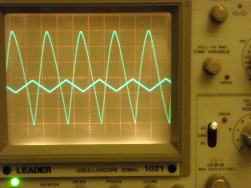

hello.
made a sim with the 2sk170bl in the afternoon.see attached schematic.
and built that with some spareparts i had laying around. my 2sk170 has an idss around 8,2ma..........so i measured nearby 6v drainpotential in my circuit (foto).and i have not built in the pot at the input because the function generator has one.
the o-scope foto shows beginning distortion at 6vpkpk output with 0,8vpkpk input signal (triangle).
sorry,made a typo in my last schematic(post 30): ofcourse the jfet is a 2sk117 (and not 2sj117).
greetings

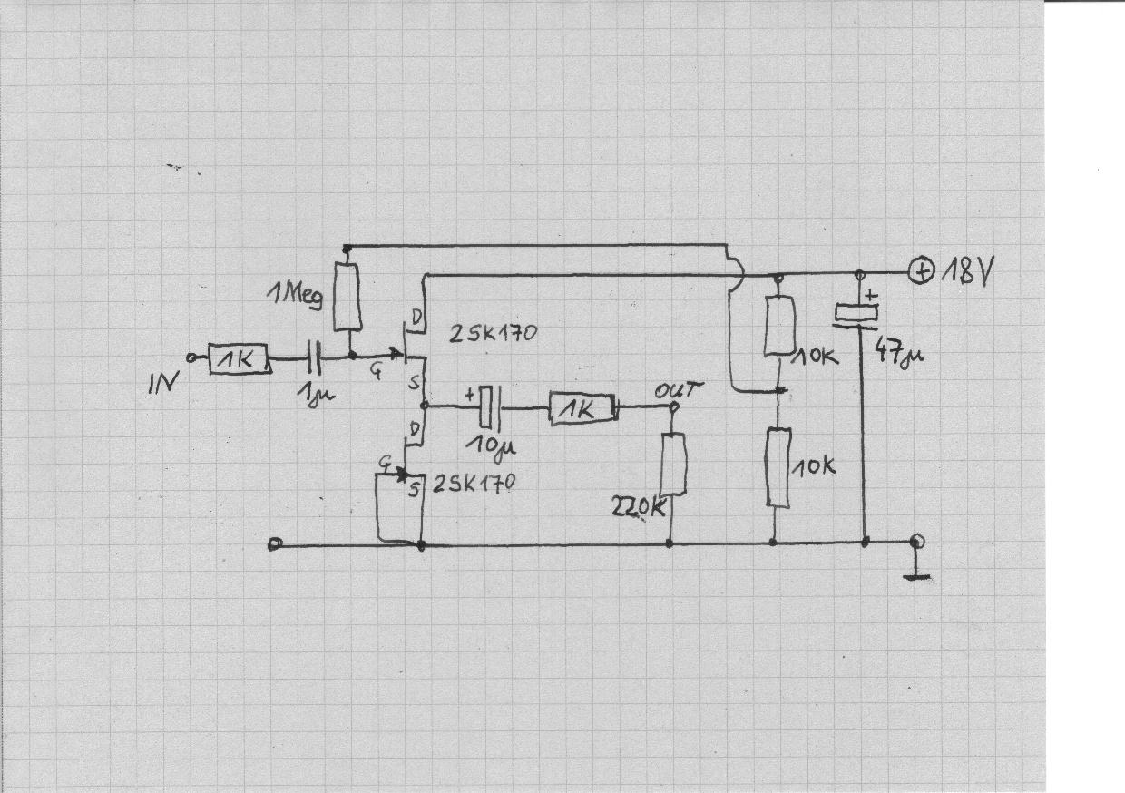

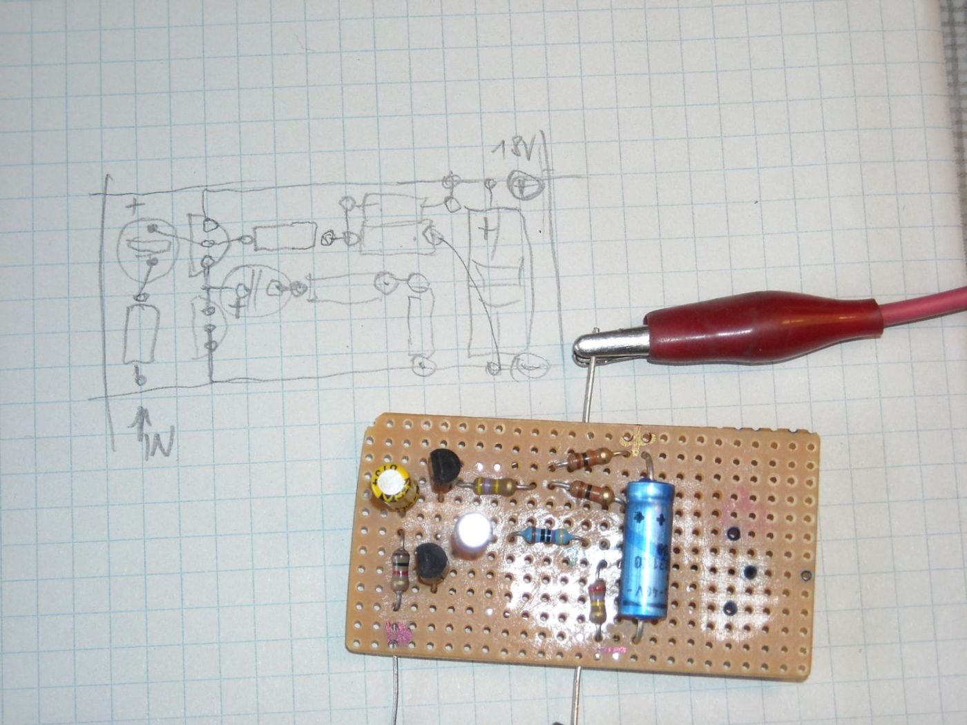

hello paul.
so here is a minimalistic schematic of the buffer amp. i left out the big elcos because it should fit into the body of your guitar.
psu is two 9v batteries in series..........
the foto shows the circuit on perfboard,i used spareparts which i had on hand.
greetings
thanks. I just got the matching FET's in the mail. I'll put it together and hope it doesn't clip
