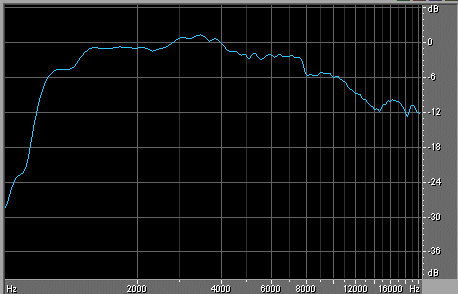

Hello Jack,
There have been some comments on Internet about your published response curves (on and off axis) which are said to have been "too much smoothed".
In fact as anybody can verify it after importing and analysing the (attached in TXT format) impulse response you measured on axis for the blue prototype of the E-JMLC-1000,
the impulse response of that horn is,as ever with a Le Cléac'h horn, very smooth and therefore doesn't need any smoothing.
In a second attached file we can also see the screen copy of the FFT delivered by CoolEdit using the least smoothing (FFT length = 65536).
(Impulse response cut before the first reflection at 5ms).
Best regards from Paris, France
Jean-Michel Le Cléac'h

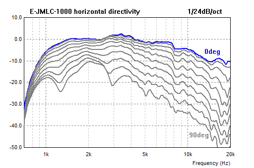

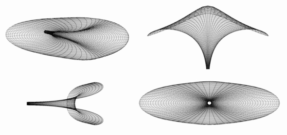

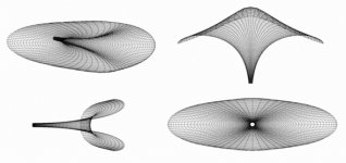

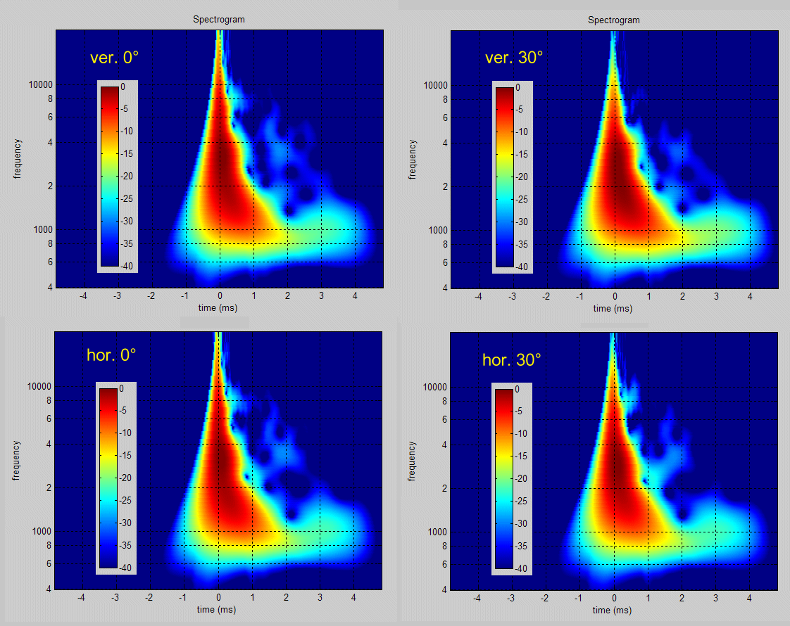

E-JMLC-1000 - most beautiful small horn ever made? For sure can rival waveguides.
Hello,
This E-JMLC horn possess an hyperbolical expansion of the area of the wavefronts (with T = 0.707 and Fc = 1000Hz).
I designed that kind of horn to provide a more constant horizontal directivity than the axisymetric Le Cléac'h horn while keeping a very efficient loading of the driver (allowing a better operation of the diaphragm and an efficient reduction of the distortion compared to waveguides).... That's why you can see a kind of beak at mouth.
I was puzzled when I saw that, few times after I designed this E-JMLC horn, the horn of studio monitor from SONY used such a feature, see:
http://www.audioheritage.org/vbulletin/attachment.php?attachmentid=13498&stc=1&d=1141815765
Even if Jack Zagaja measurements show that the directivity is very constant inside a 60° angle until 15kHz, allowing a wider listening zone, I don't call myself that horn a "constant directivity horn". There something very special about that kind of horn : the horizontal profile varues a lot with the cut-off frequency. IMHO the better shape is obtained with a frequency (around 300Hz) and in that case I think the angle inside which the directivity should be more constant could be reach 90°.
See attached graph.
But in that case the horn is very large and it will be very difficult to unmold, that's why Jack Zagaja asked me to calculate a first model usibng Fc = 1000Hz.

Nice! And in 10 degree increments, thanks.
Question: This is called JMLC-1000 because it has its -6dB point at 1000Hz? One would normally cross it higher, yeah?

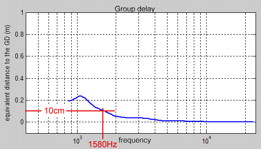

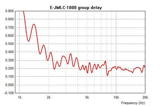

Hello Pano,
You'll find here attached the group delay curve of the E-JML-1000Hz (calculated from the published 0° pulse response using my own Matlab routine).
As I used to say, I use for myself the horns above the frequency above which their group delay (expressed in equivalent distance travelled at the speed of sound) becomes smaller than 10 centimeters (4 inches).
So I recommand to use that horn above 1580Hz.

1000 stands for calculated cut-off. Usually crossed one octave higher (group delay).
Bah.. Group delay is still low at 1000 Hz.
When I look at I' think of a single component for the horn at around 6 kHz for the low-pass, with an appropriate summing filter for the mid-range targeting around 1.6 kHz. (..it would of course need a nice flat impedance for the driver to slightly below 1kHz.. but the RCF neo 1 inch driver accommodates that.)
Nice horn, Jean-Michel & Jack Zagaja; looks like an ideal choice for a wideband 1" driver.
I can see why you are recommending 1580 Hz or higher as a crossover point: not only does the group delay increase fairly sharply below that (although it remains lower than many other horns), but pattern control is starting to go away, and diaphragm excursion is also going up as well.
One of the truly remarkable differences between a T=0.707 JMMLC profile and say, a conical, is the difference over the first octave to octave-and-a-half of operation. With the JMMLC, resistive diaphragm loading is present almost down to cutoff, while a conical needs to go an octave to an octave-and-a-half above cutoff to enter the resistive-load region. That has implications for IM distortion in a frequency range where the ear is most sensitive to distortion (which largely follows the Fletcher-Munson curves).
Some contributors might feel that pattern control is more important than IM distortion in the 1~5 kHz region; to me, that's a subjective call on the designer's part. One of the things I like about the patterns of the JMMLC horns is they are not constant-directivity; instead, they mimic the directivity of ideal direct-radiators, which I don't see as a bad thing at all. The interesting thing about this new horn is the directivity is similar to an ideal 6 x 9 (or smaller) elliptical speaker, but oriented vertically.
