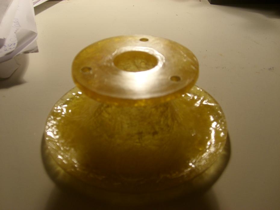

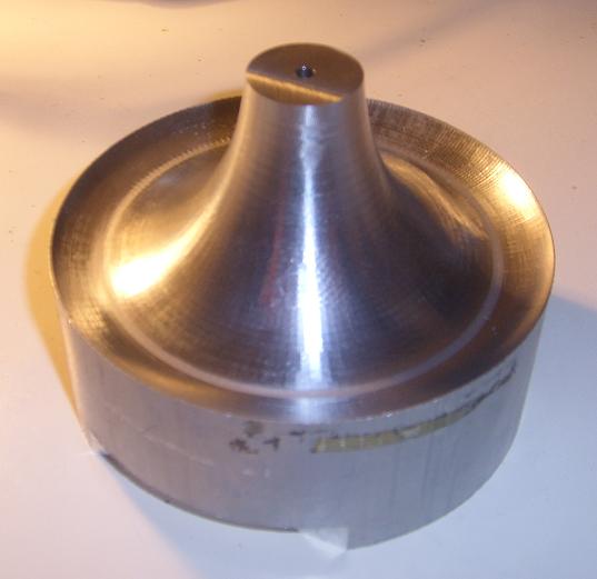

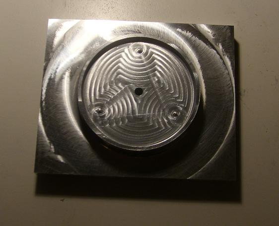

I guess everything can be done with enough effort and money.
The 1600Hz mold didn´t cost me a cent to make, it´s machined out of a scrap piece and my brother did it as a favour (I´ve helped him repairing some electric stuff in his workshop). The 750Hz mold will cost something like 100 dollars if I can buy the metal through the company I work for and a guy there has offered to help me with the machining (again in return for some favours, of course).
A 200Hz piece would be a MUCH bigger project, too big to think of at this stage. Maybe is I could gather enough scrap aluminium and make a sand casting which the could be smoothed in a cnc mill or lathe...

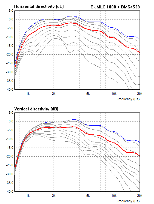

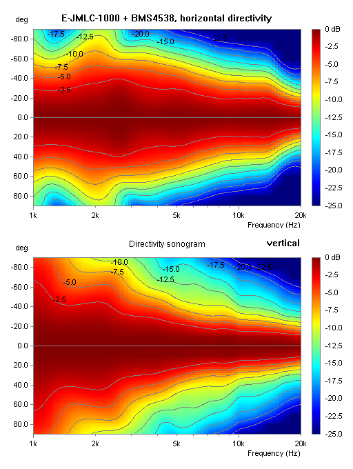

This looks very nice. I guess it's for compression drivers?E-JMLC-1000 - most beautiful small horn ever made? For sure can rival waveguides.
- Jean Michel on LeCleac'h horns
