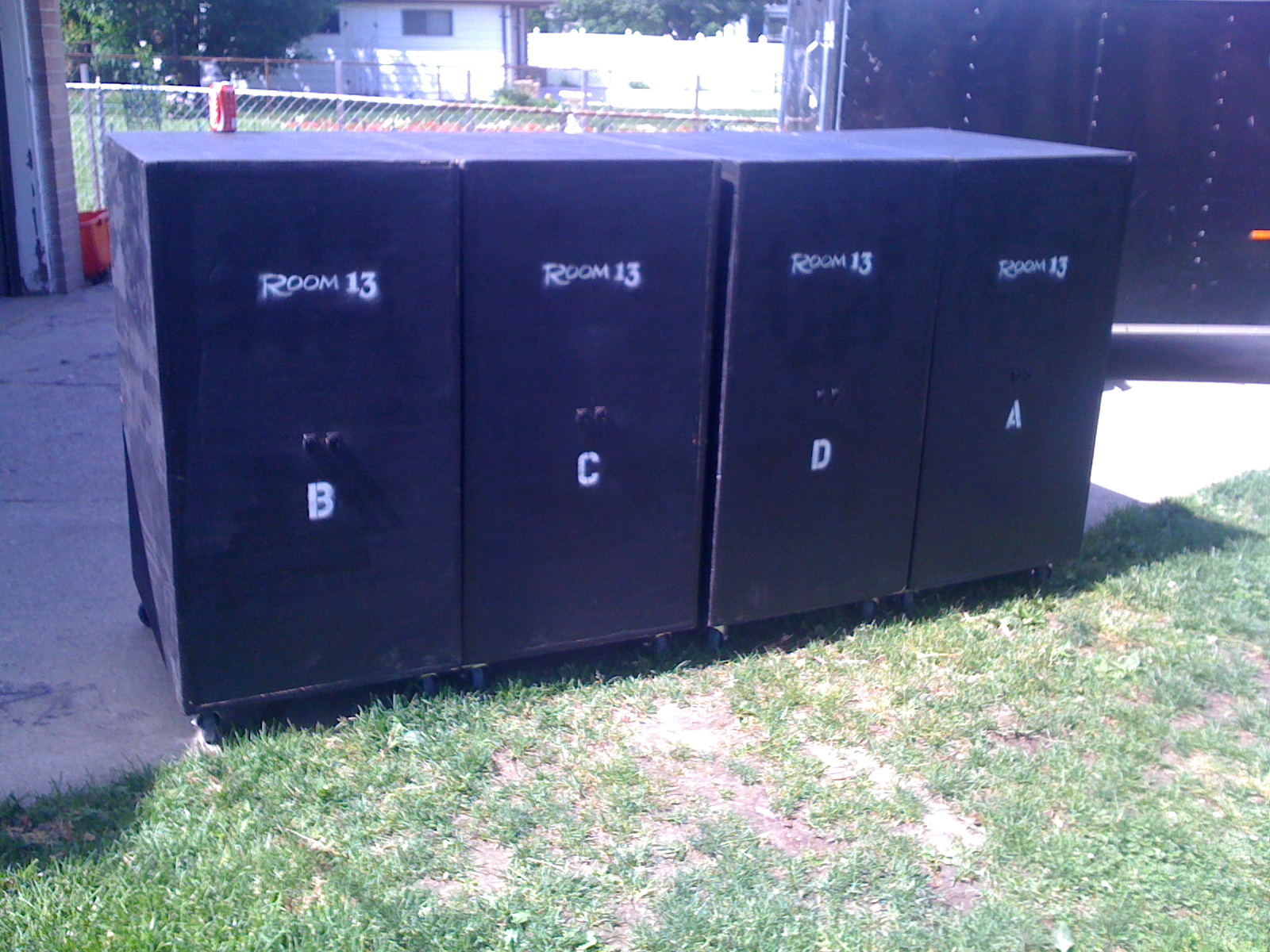

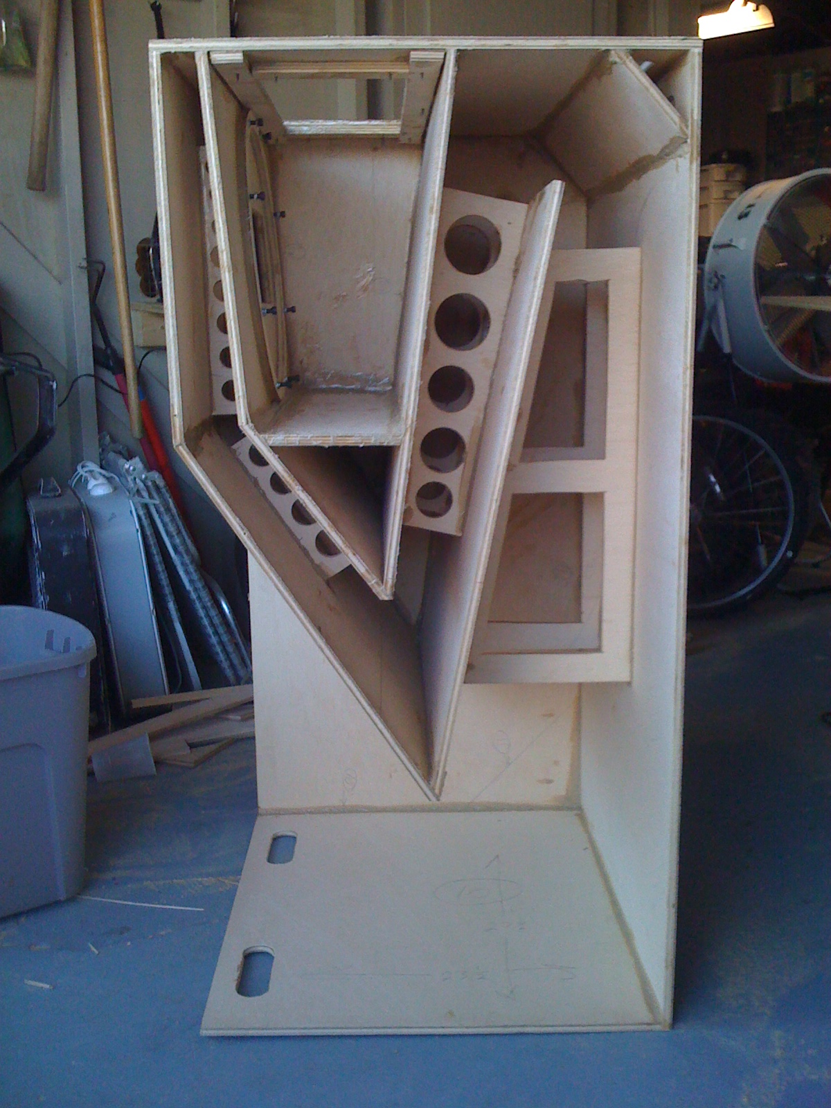

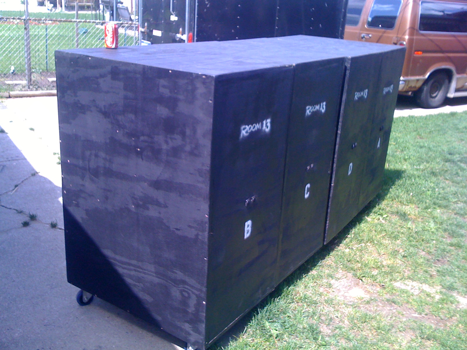

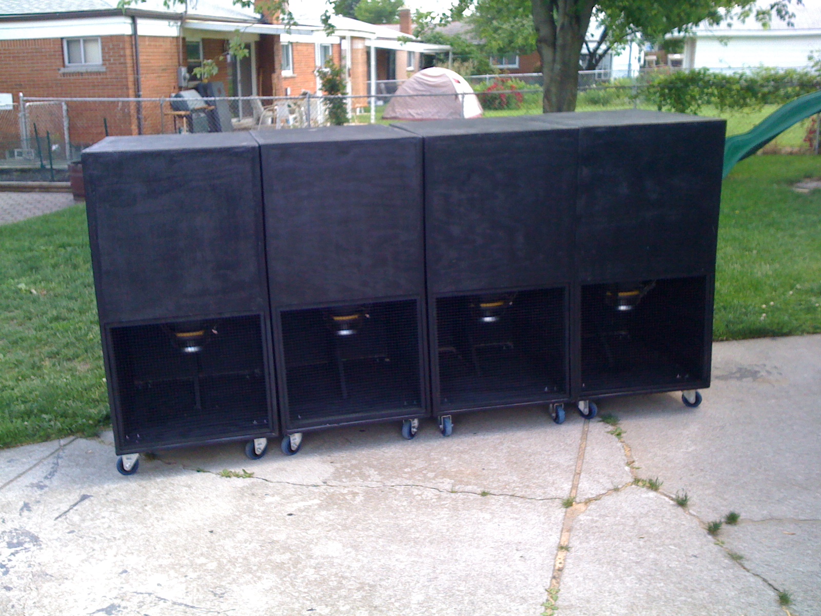

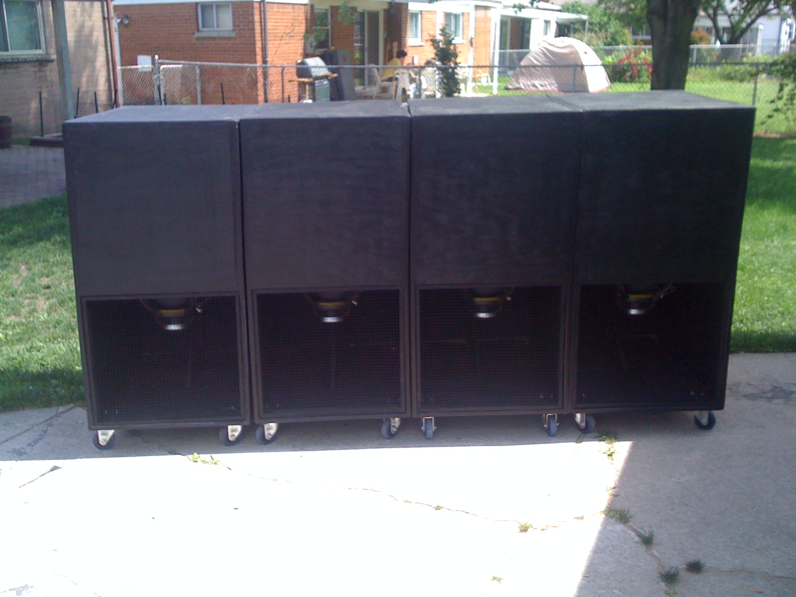

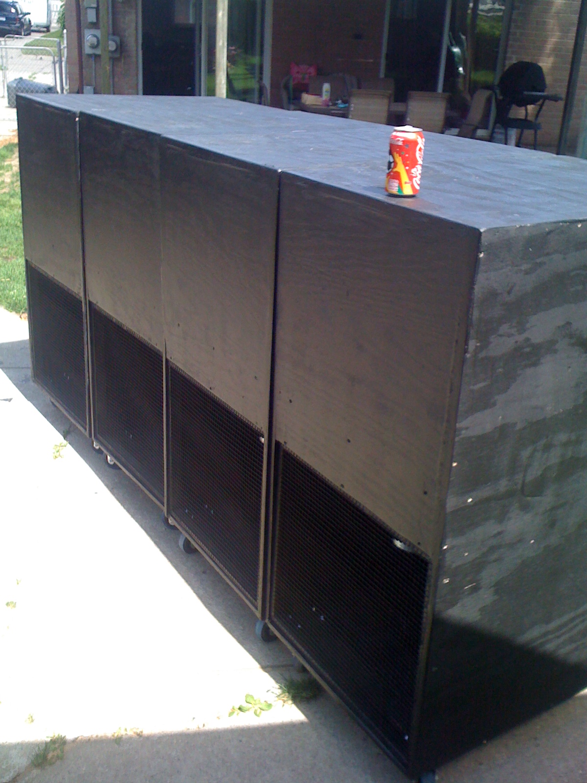

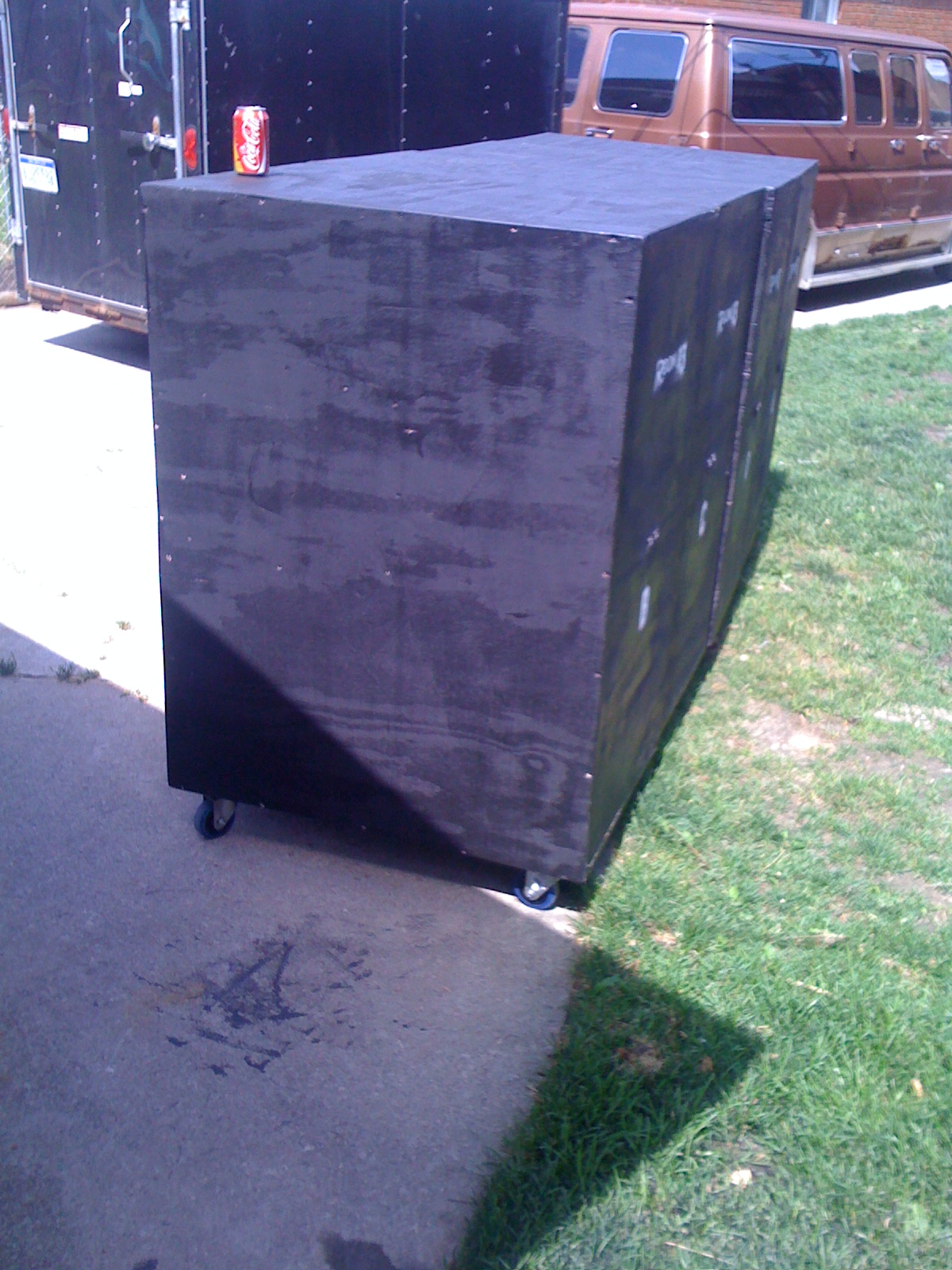

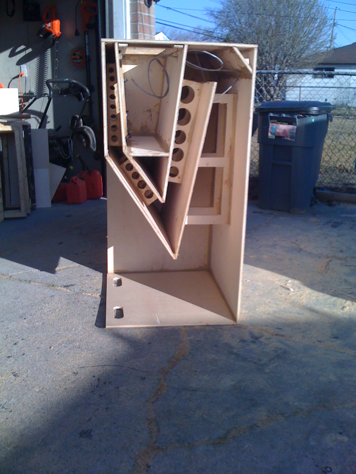

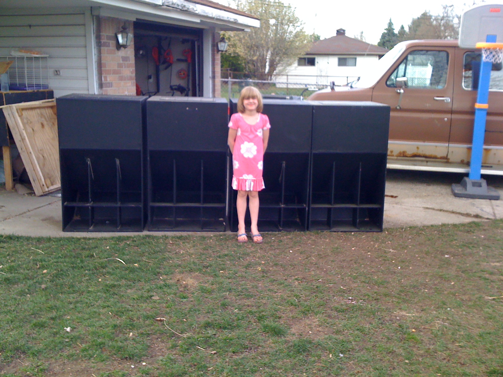

update: I did a live band sound check today with my new JBell TH subs. I am very happy:D:D:D. The kick drum is loud and clear all the way to the back of the room and then some. and yes these subs are very directional. as you walk around the cab it gets softer. and on stage behind the cabs is nice and quiet. this makes for a very controlled sound. I love it. I even tried turning the cab to see if it makes a difference and it does. I had them aimed at the plywood side wall and they were rattling the crap out of the wall. when I turned them back to the center the walls stopped rattling. if that isn't directional, I'll kiss your ***. I have the perfect sub for me now. I will be building 4 more of these in a few weeks. then on to the perfect tops. any suggestions JBell, my new best friend? LOL
Thank you so much for this great sub that you and your friends designed.

Thanks for the review, and most importantly the confirmation on the directionality. There are thousands of designs that can make bass, but very few that are directional. If you are going to 'labor' to design tops that are directional, why would you not want your subs to be as well? The unachievable holy grail of sound reproduction would be 40-15000 all at the same polar response.
As for suggestions:
First, your woodworking looks good, make it look great. Take a router with a 45 degree bit at hit all of your edges, it'll keep the plywood from splintering at some point in the future. Next buy one of these: Search results for: 'texture' and add some texture. You'll be amazed what a little texture will do for the look.
As for tops, if you have read any of my threads, you'll see I've done a ton with 'OT style' cabinets. There are a few things that I'll mention.
1. the 10" long horn gives you a bunch of 500hz boxy sound, eq that out, or change the path length.
2. The side ports are feedback creators, put them in the horn plates, to the sides/front, not deep like omni/jack.
3. compression horn bi-amp'd. selenium 220 and goldwood 500 seem to be a reasonable and cheap combo.
4. overall dimension, if you build 16 1/8" x 23 1/8" x 18 cabinet size, you can use stock 15x22 metal grills.
5. I'm lazy, cutting horn sides with 45degree angles to meet the baffle and cabinet sides makes things go easier.
6. Go with more tops, cheaper drivers, vs fewer tops with more expensive drivers. I've kinda gotten to like the beta 12a-2.
7. hornresp... The above does not necessarily give you an exact 'plan' but rather gives you some guidelines on how to design and build your 'own'
8. xti amps. You can get xti1000 refurbs with full crown warranty for $350 and have all the dsp you could ever want to bi-amp your tops. A good match for up to 4 a side.
Thanks for the tips. as far as looks I'm not that worried about. The performance is my main concern. I move this stuff every weekend. My band plays Friday and Saturday every week. The crew I have to move gear can be a little rough LOL. The equipment gets beat up alot. I just throw more paint on them and they are as good as new. but I will be using a router on the edges. I just bought one a few weeks ago.
i did notice a lot of vibration on the horn mouth. I think I will try adding a cross brace at the end of the mouth. I used glue and screws so I know they can take some abuse.
I'm using a DCX2496 I can just run 3 way with the OT type cabs and subs. I have 3 QSC PLX3602's should be enough to do whatever I need. Thanks again.
and thank you Syd for helping me and for directing me to this forum.

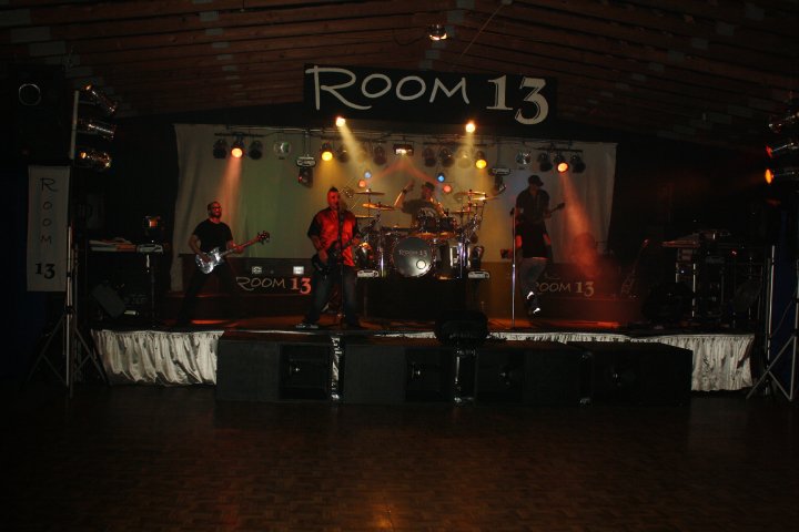

The show went great this weekend. The subs performed perfect. and they can take abuse too LOL. had lots of girls dancing on them
Here is a few more pics of my set up.

very cool, thanks for sharing.
Love your setup of your subs.
Here's a tip for you that may come in handy some day. If you are running 2 sub amp channels, you can use your dcx and delay the outside pair up to about a couple milliseconds if you need to spread your bass wide. (around 2ms got my 45 degree off axis, the same spl as head on.) If you play a 'wider than deep' area, it may come in handy.
BTW -- couldn't see your tops, what do you run today?
I'm using 4 QSC HPR152i for tops. powered 15 and a horn. we hang Room 13 banners in front of them. that why you can't see them.
thanks for the tip. I will do that at a couple of the wide club that we do.
do you think I need to delay the tops at all because of the length of the TH horn.
I used to delay for the T48s because they had 9 feet of horn and I could hear it tighten up the sound with the delay on the tops.
The TH's don't seem to have a problem with that. maybe because the driver is in the mouth and shorter horn path.
