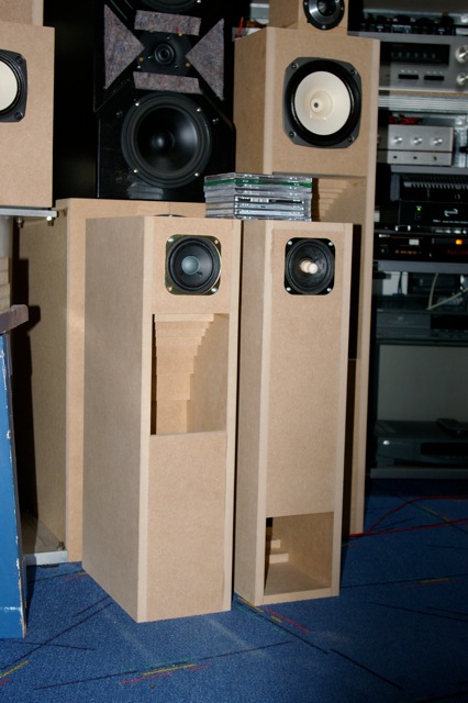

So is there no baffle step on these? I find this one quite interesting. FR88-EX should work in here w/o major work planet?
So is there no baffle step on these? FR88-EX should work in here w/o major work planet?
I expect that being skinny and likely mounted on the wall, there would be little or no BS to compnsate for. The one you linked to would be a different case.

When i see refs to “Japanese speaker plans” what stands out are the many, many creative designs by Nagaoka who tool Olson’s work to a new level.
These were designed at a time when decent modlers did not exist so were formula, design, build, test, revise.
If one found a design they like taking the folding topology and tweaking it based on modern modeling one could cone up with a better performing loudspeaker.
dave
When i was writing the last sentence in mu last post the swan was the box i was thinking of in particular.
These designs are most accessible in the series of volumes of speakers designs. Finding them might be tricky and they command a significant price.
dave
Edit: the link that provided the picture also has links to the books. Only parts of those books have made the web.
