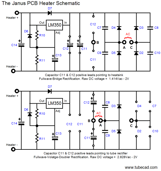

After sitting around for a while I am back to working on my Janus Shunt regulator and Aikio octal build. I was in the process of testing the heater side of the janus shunt regulator when diodes D2 and D5 gave up the ghost. I checked their orientation and they are orientated correctly. The configuration is setup as a fullwave bridge rectification with two tranformers one for the B+ and one for the heater. The B+ transformer is an Edcor XPWR163 which is a 120V, 60Hz. line to 550V (275-0-275) at 150mA center tapped, 6.3V (3.15-0-3.15) at 5A center tapped and 5V at 3A. I am not using the 6.3V tap. The heater transformer is a Hammond 167N12 which is a 12.6V CT transformer.
I measured the Hammond transformer and I am get just over 14V out of the secondaries.
The diodes are MUR410G which have a 4A rating, the secondaries on the Hammond have a 4A rating. Do I need to step up to a diode with a larger amp rating? I am trying to post a schematic but D2 and D5 make up have of the rectifier.
