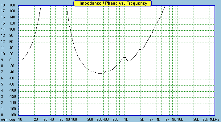

There appears in the Impedance plot a pair of peaks, circa 1K & 2K.
Are these anything to worry about?
Would there be a program of investigation leading to "treatments" to bring them under control?
I'm thinking this driver is better suited to an OB, ala Orion...

They seem to correlate well with:a pair of peaks, circa 1K & 2K

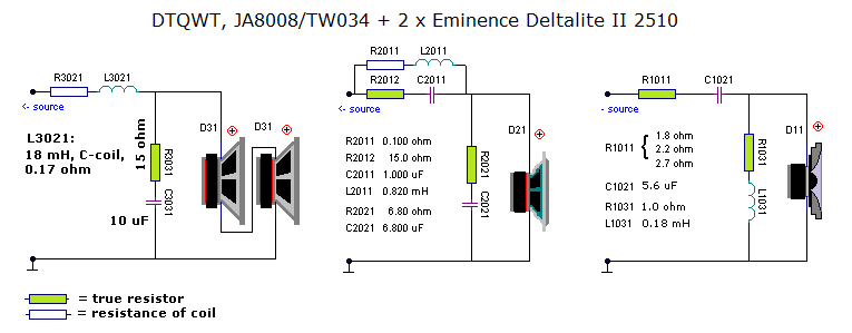

I have already received my kit DTWWTII and I chose the Audax tweteer TW034. Tweeter is originally selected by Troels, to engage the JA8008 network through appropriate junction. This is really important before changing any driver of a project.
Also, if you use the Audax HT210G2 for bass / midrange, the crossover no longer act alike.

The aluminum voice coil former is now replaced by a fiber glass voice coil former with similar properties of e.g. Kapton and titanium. The result is an huge increase in Qm, actually I measure Qm = 10 from the driver samples fitted with a center phase plug.
If the above network crossing would have worked well with the new driver, you could not tell, my knowledge about it are not very large.
But you're right in thinking that ..... I'm a little disappointed with the change of controller, it seems the best driver that Troels manufactured (said by the same) is not anymore? I believe that business is business as usual.

I think Troels just redesigned the driver AND also decided to try a new crossover. He moved to "stepped" baffle a long time ago and liked LR2. But i don't think it's because new driver required it. And personally i like older T35 first-order (electrical) crossover more. I was thinking to just replace the driver with new one without changing the crossover...You are right, it was a mistake, I meant that the new driver JA8008 HMQ the qms (factor of merit due to mechanical losses) went from 1.7 to 10, so Troels has designed a totally new crossover network.
Why you say that? I like high Qms drivers! I think the JA8008 just got better, a little. And i like that shiny bullet Otherwise they are VERY similar, the main difference is voice coil former (which result in different QMS) and phase plug plus slightly larger magnet and that's it, same driver otherwise!But you're right in thinking that ..... I'm a little disappointed with the change of controller, it seems the best driver that Troels manufactured (said by the same) is not anymore? I believe that business is business as usual.

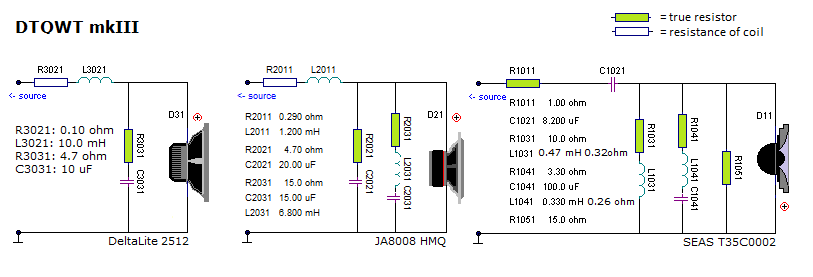

academia50, i think new JA8008 should work in place of old one. QTS is the same, response is the same, impedance is the same... What else we need? And Troels is working on new crossover for dual 10" cabinets, but it won't surprise me if he just writes one day "just plug the new driver into DTQWT MK2 and be happy"

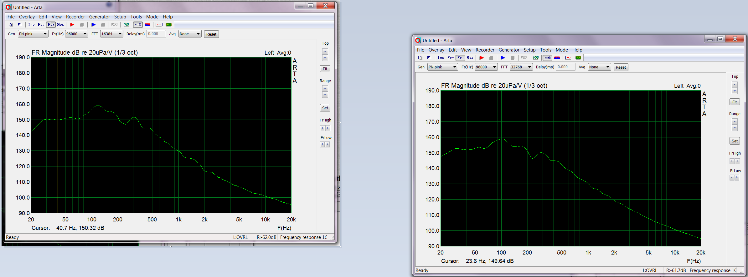

Here's measurement of how blocking about 1/2 of the port affect it's output (port output only).
I simply used large books of different sizes for experiments and put them under the speaker so they block half or more of the opening depending on book size. You can also use adjustable feet but you need to set height real low to see significant change. The idea is to reduce opening to area less than opening so that it loads the speaker.Sorry if this is off-topic, I am finishing a pair of DTQWT at present. What did you use to block the opening?

Thanks for your reply AlexanderTD. I will give this a try once the speakers are going... hopefully one week away!

Alexander, I mentioned that the Qms is very different. The magnetic flux (Gauss) of the voice coil is greater, all influences. Different damping in the new driver (compliancia) requires redesign the crossover. If you put the new driver HMQ in the old frequency divider surely measurements are not equal. Also remember that having bass drivers in the rear panel, measurements are difficult, as you said Troels. Recommends keeping the high impedance (6 ohms minimum working) DTQWTIII if used with a SET amplifier, and using 2 x 10 inch Eminence. He also mentions that the vast majority of builders use DTQWTII solid state amplifiers (SS) Maybe that's the reason for using 1 x 12 inch Eminence, we can not know exactly, but I trust the seriousness of Troels as a designer. I hope I never need to replace the old JA8008!

Yesterday i studied response and impedance plots closely and i realized that Troels is right when he says old crossover won't work without changes. The answer i think is not as much in frequency response differences but more in impedance plot - new 8008 has small "fluctuation" around 800hz which likely results in more pronounced dip/peak combo when crossover is used, hence LCR circtuit to tame it. Should be less of a problem for T35 variant though as it's crossover point is lower
T35 variant definitely has a better chance of using HMQ driver without changes to the crossover, maybe with LCR circuit. I could give it a try since i have T35 variant, but i guess it's easier to wait until Troels come up with a new crossover for dual 10" DTQWT.
academia50, QMS by itself doesn't affect how crossover works, only total QTS which is the same. The only reason new driver "won't work" with old crossover is minor differences in impedance and frequency response which will result in larger peaks/dips in crossover region making it less optimal. For non-T35 DTQWT at least. I believe i can make it work with my T35 variant, maybe with additional LCR circuit.
