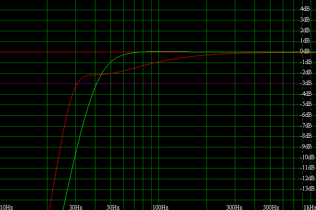

Here's an easy experiment - disconnect one of your drivers and cover it over with something that doesn't flex. Re-tune the box to 30Hz (shorter tube than what you need now BTW). The graph tells the story. The green is how you have it now of course. If you really like what you hear, pull the extra drivers out and go and buy some more wood. You know the rest.SkinnyBoy said:Each tower is 60litres.. so each "subwoofer" is effectivly getting 30 litres... tuning frequency is about 38Hz was going to be 36Hz, but it made the port TOOOO long.. hehe
no offence.. but that just doesn't add up.....
my graph doesn't look like that... and if I use the same diameter port, it ends up being 86cm long compared to my current 21cm... hmm.. lol
oops... my mistake.. lol possibly winisd's but I'll blame myself...
I like 2 drivers cos it get louder.... still low enough for the music I listen to.... it means I can make an amp and bridge it into 8ohms.. rather than whatever.. lol
what does the efficiency do for 2 drivers in series? I need to know so I can work out a temporary crossover... also.. what should I use for dampening material? I have no money.. lol

SkinnyBoy said:oops... my mistake.. lol possibly winisd's but I'll blame myself...
Hi Skinny boy, I thought I already answered that question here http://www.diyaudio.com/forums/showthread.php?postid=242430#post242430 I know it's not "your" driver but the theory will be the same regardless of what driver you use. Or is it just that you don't trust anything thats been calculated with a piece of M$ software
Or did I miss the point and you actually want to know the efficiency difference between a single driver and two in series as opposed to the efficiency difference between two drivers in parallel, compared to two in series.
As for damping material on no budget you could wait till it gets really hot, and go out and scoop up melting tar off the road and apply it the the inside of your boxes, if you apply it with gravel, the gravel may even help break up standing waves! <sarcastic grin>
Tony.
Tony.
Yes.... I need to know the actualy difference.. someone said that connecting 2 drivers in series resulted in a 3dB gain.. while connecting them in parallel resulted in a 6dB gain.... Thats all well and good, it would mean that the woofers are like 91dB 1w/1m and the tweeter is 92dB at 2.83 1metre.... so.. how does that compare.. I know the now the tweeters are quite overpowering.... so.. its more than a 1dB difference...
