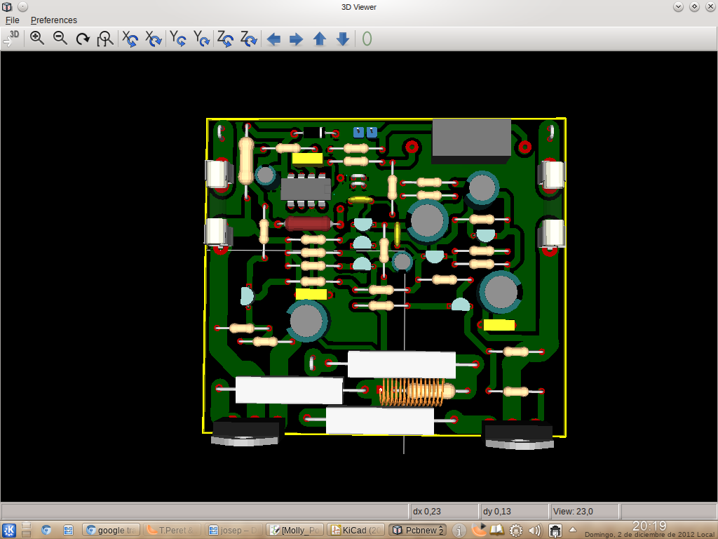

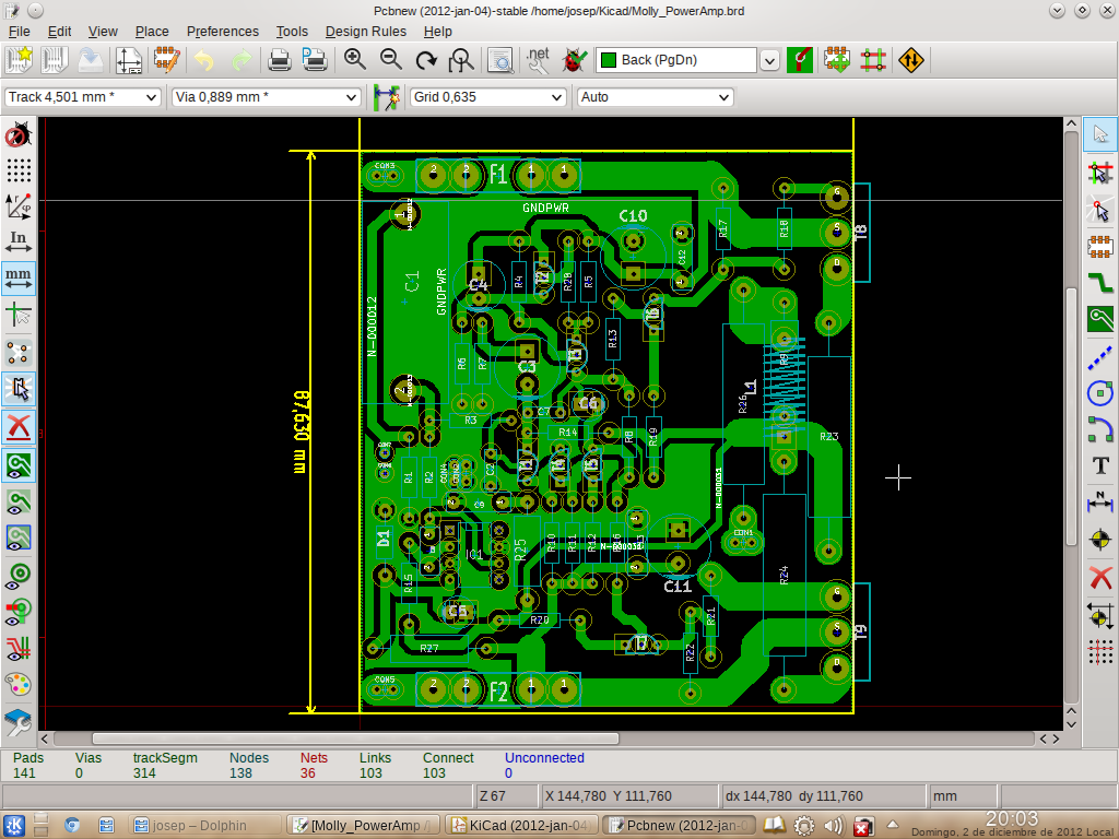

Alexs' PCB looks brilliant to me although there is one error if you look at the "top 2N5401". The base and emitter are joined :)

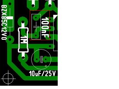

Mooly, C8 (0.1 uF) is an electrolytic condensador?

Mooly, i have updated the schema and bill of materials.
If errors are not found, i will begin the design of the pcb.
PD: I will take as a reference design Alex.

As a general rule "true" ground planes aren't really appropriate for audio. Your PCB looks OK though but I haven't checked it pad for pad.
Grounding has to be logical and safe. The mains earth must go to the chassis. The high current speaker return has to go back to the PSU. This thread explains it, post #38 but read it all.
