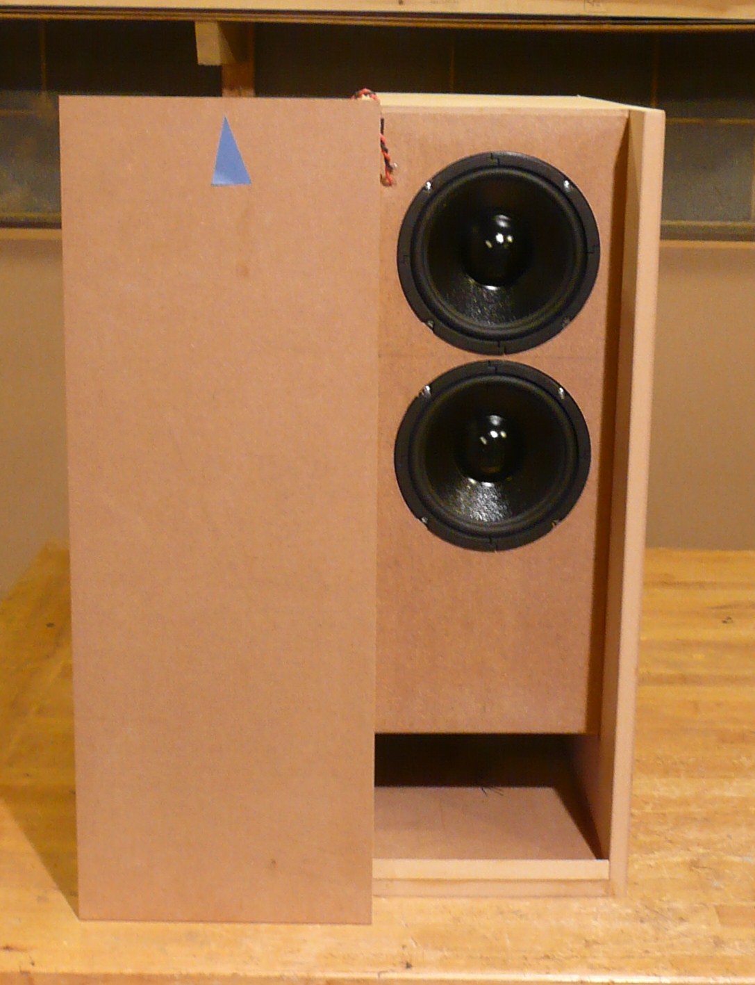

I did use 18mm on the outside on #3 (6 sides), the inside 1/2", I added to the length so the inside stays the same.

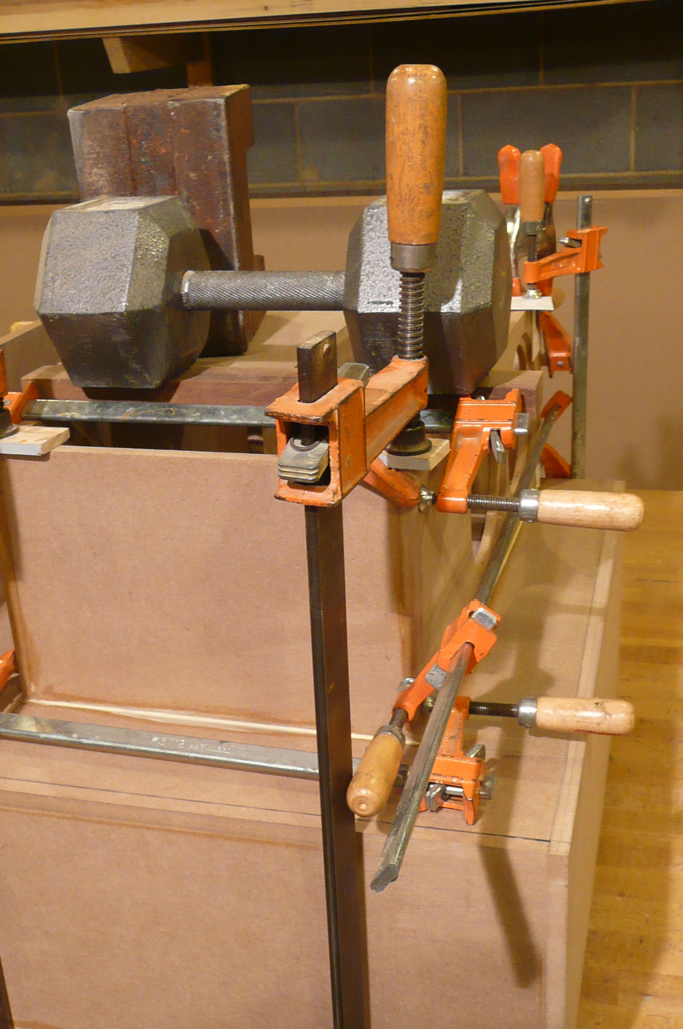

Here is a pic, if I had to do this all over again, it would be a little bit neater job, but this should turn out okay.......

The JBL 8" is good but 2 in one box is the way to go.

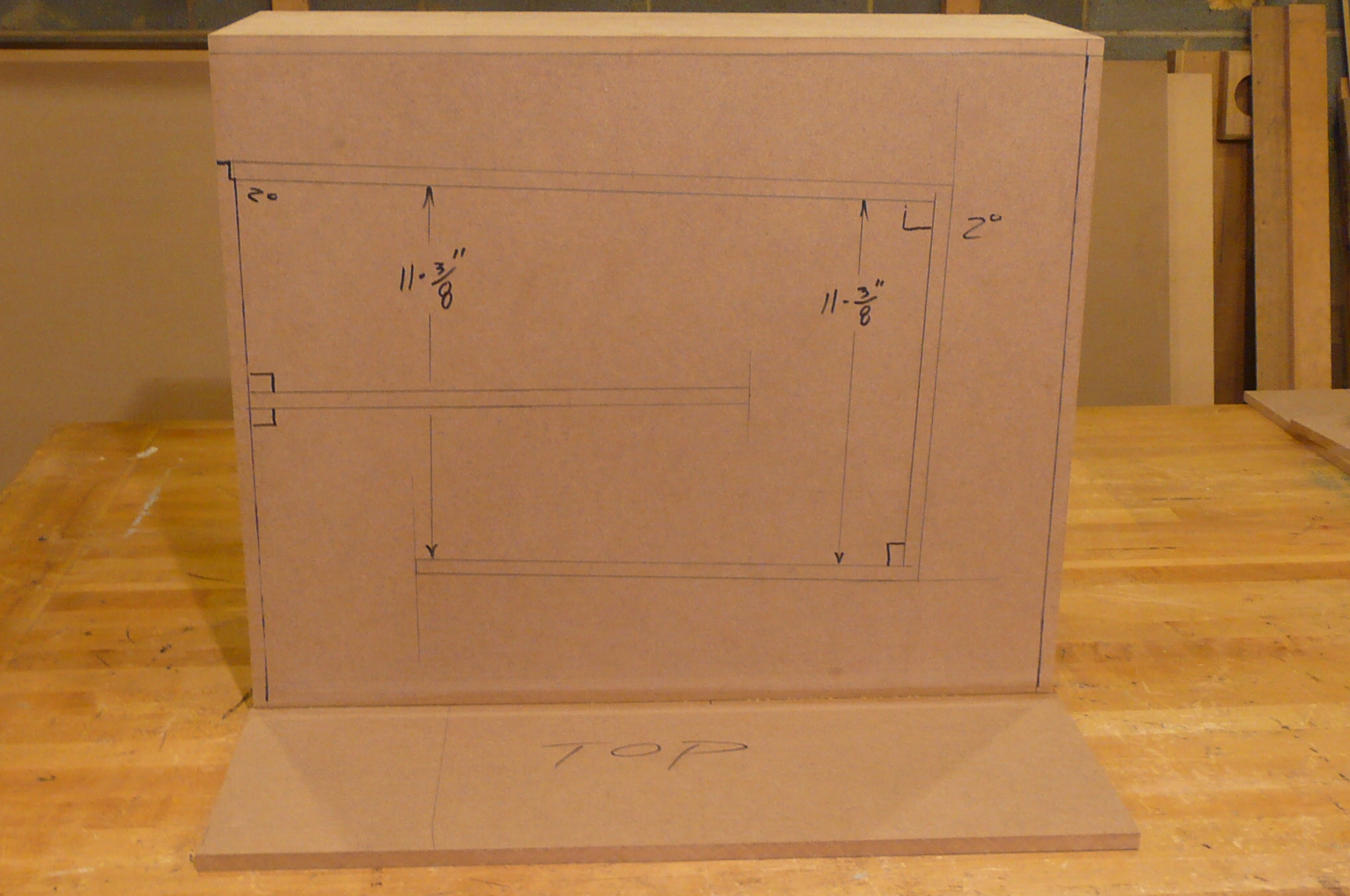

KraZy man, how are you going to handle the outer pannels - lap joints?This is 17-1/2" wide, (sharing one side).
Your 8" will work too BTW.
Neither of the 8" drivers is as efficient, but they have more x-max so they can get louder.
