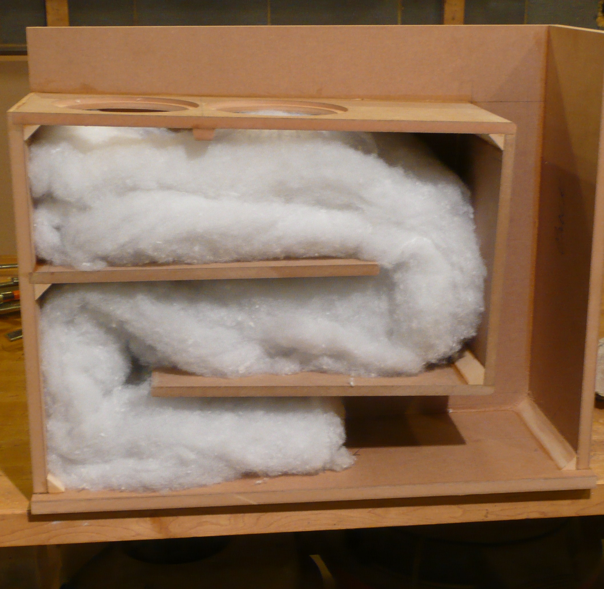

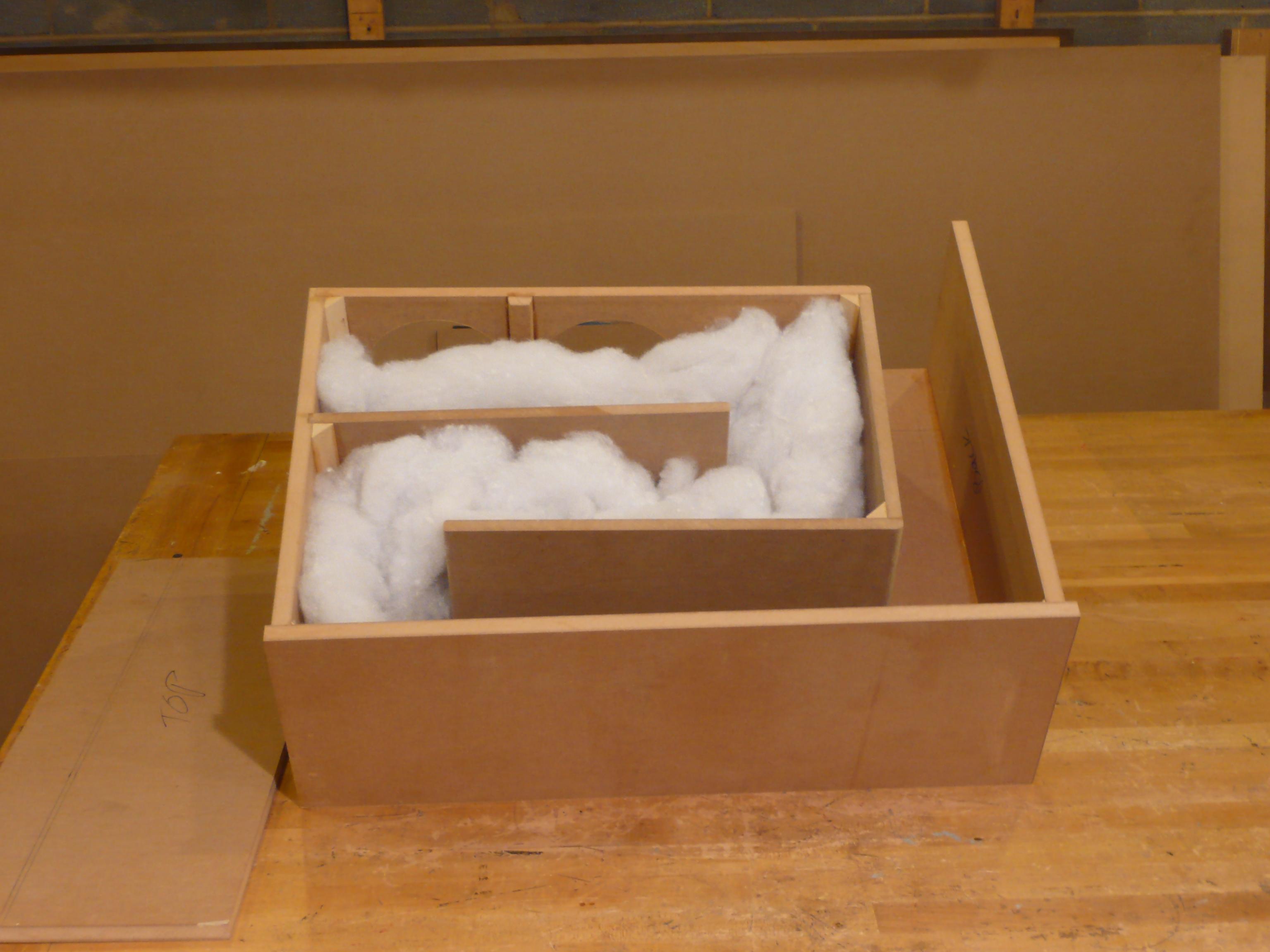

New Pic

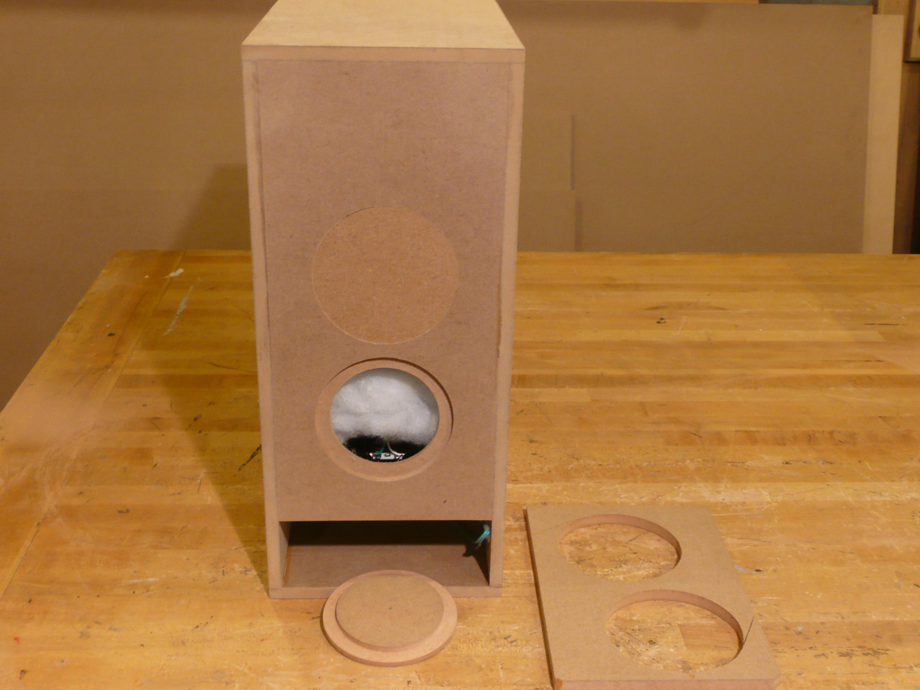

The access in the front panel idea was perfect, not hard to do and the poly fit fine. I added 10oz poly in one and it made some difference, used 20oz in the next and it sounded very, very, nice.
Even hooked it back up the stereo amp and all the mid range problems vanished. From here I can go back and add poly to the first one. I do find a piece of 1/2" foam right below the woofers makes a huge difference also. [not shown in photo]
btw, stopped by a craft store, bought Mountain Mist Polyester for $5.00 for 2 lbs. It rolled out nice, also a perfect fit, easy to do/add; no blocking needed.
Thanks to all for the plans and counsel!!

Update
I found a scale so I now I can measure fill accurately.
.46lb (7.5oz) was a little light as far as I could tell and 9.7oz was a bit much; it didn't chug as much as I though it should. Ended up with 9.0oz, that seems to work nicely.
Started a 3rd today box, going with the 9oz.
