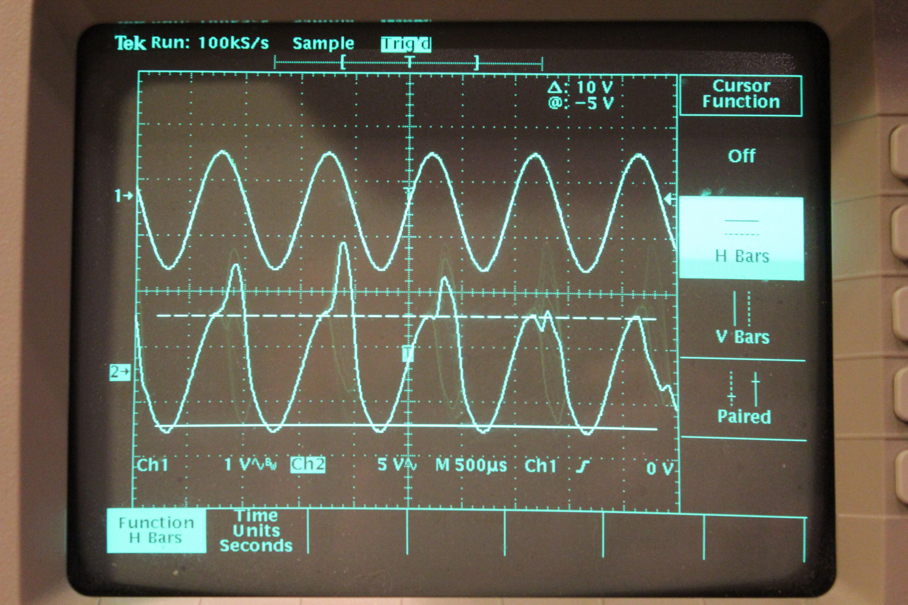

Ok. I'm on to something.
Well first I changed all the OPT Cables, anode and G2 on each tube per channel traded places and so did 0 (black) and 16 (cotton yellow/plastic yellow). Not a greater difference, still boating. But now its at it should be

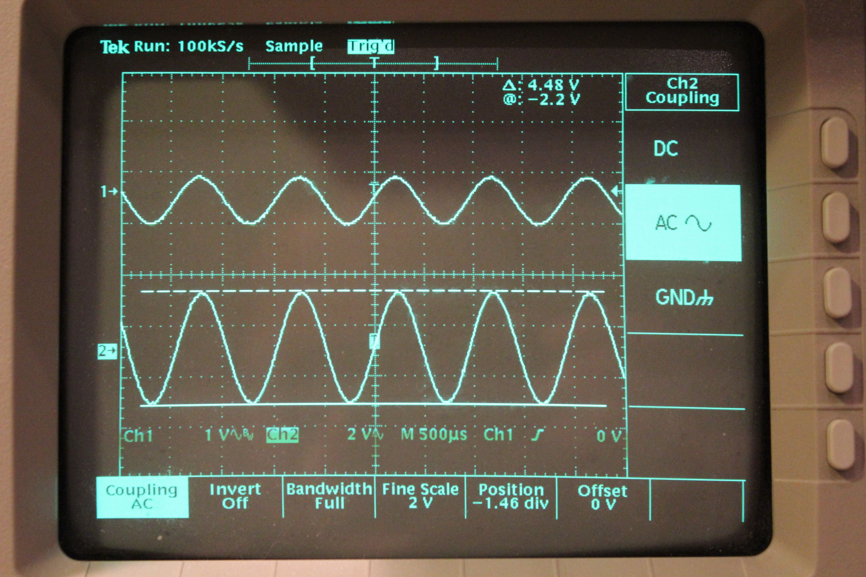

So I started to rig a 1 kHz 1 Vpp sine, put it on on one channel, probe 1 on input tubes grids and probe 2 on output tubes grids, one after another.
You can see I have smaller unbalance but... last one started jumping (boating). So now I can concentrate my search to that. First change the coupling cap maybe.

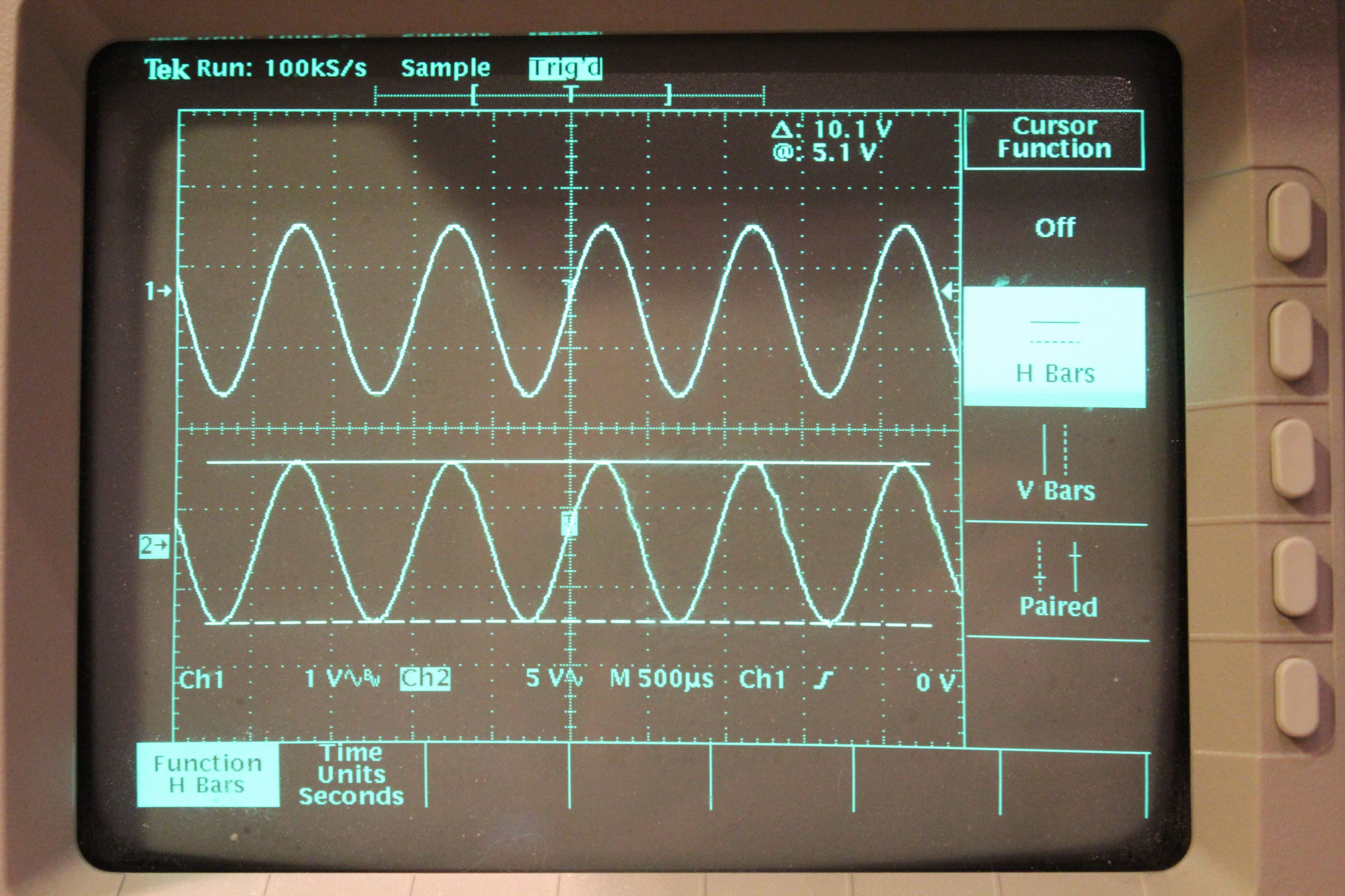

Well. Quick update. I made some proper measures on the setup without changing anything. When I measured the same EL84 grid again today there was no jumping on that one. Pic 1
Measuring its opposite partner in crime gave about the same but inverted signal. You can see values delta cursors top right in window. Pic 2

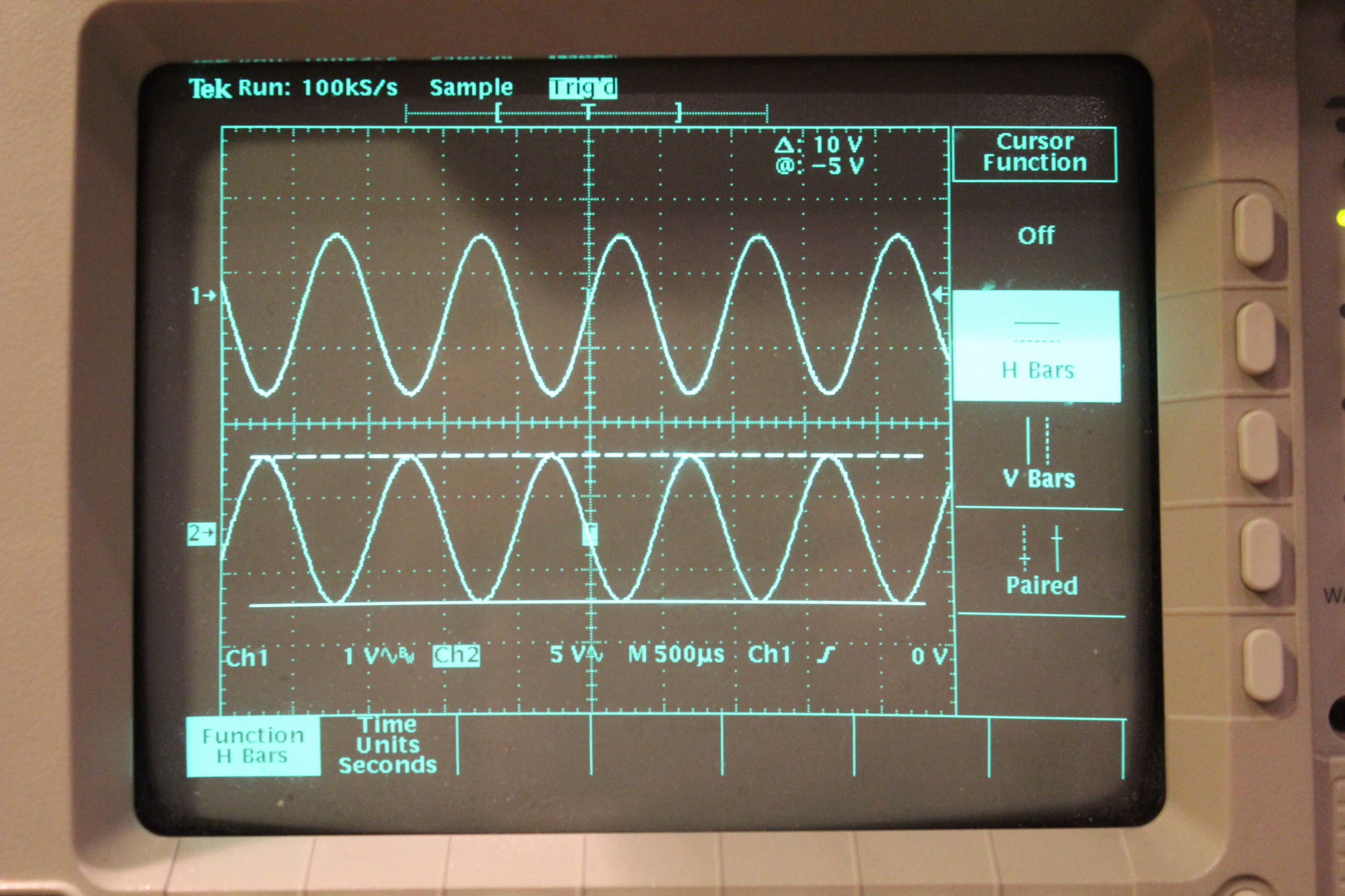

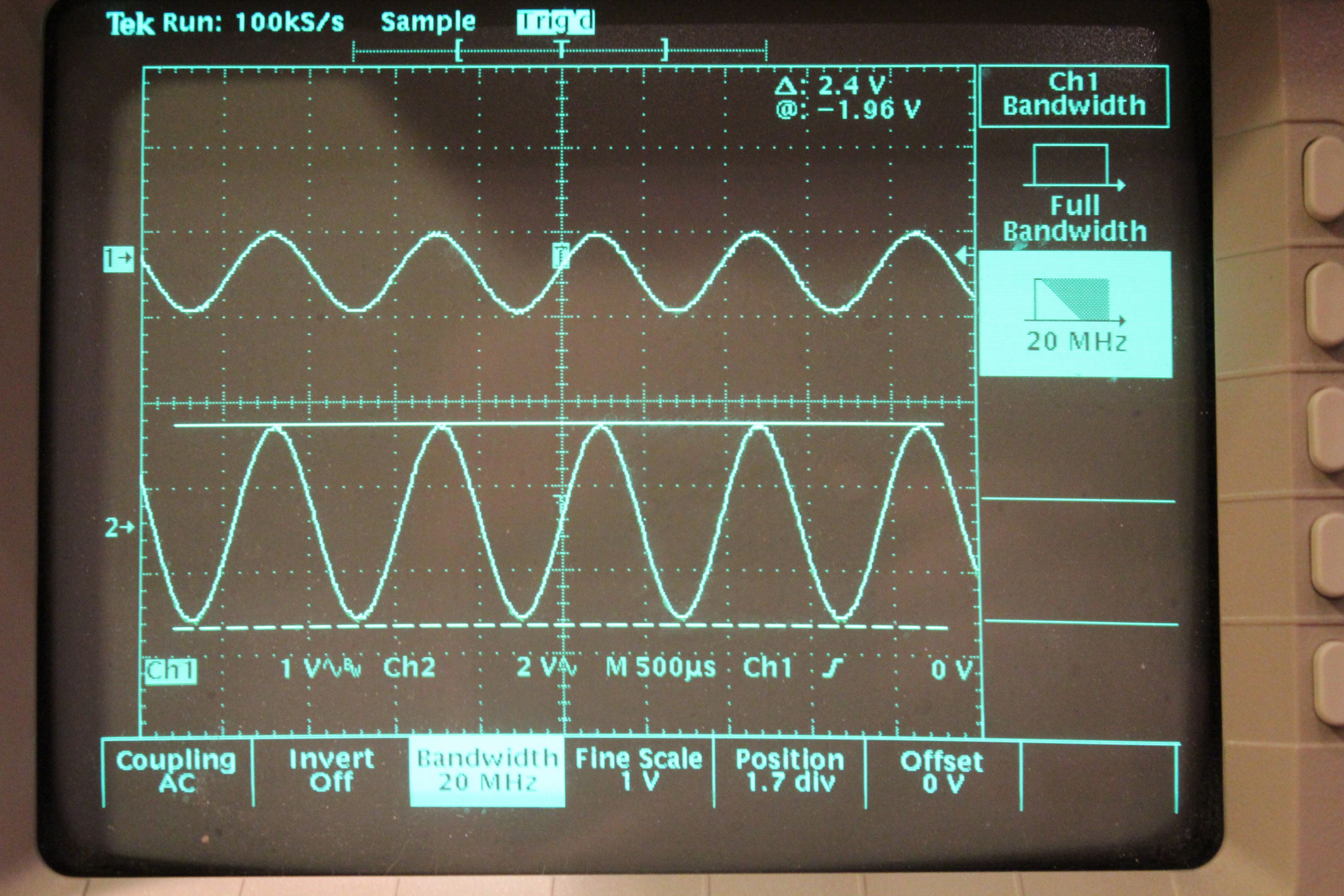

Next channel started ok on first grid, pic 3 but then I had another not yet seen strange wave on the last grid. Pic 4

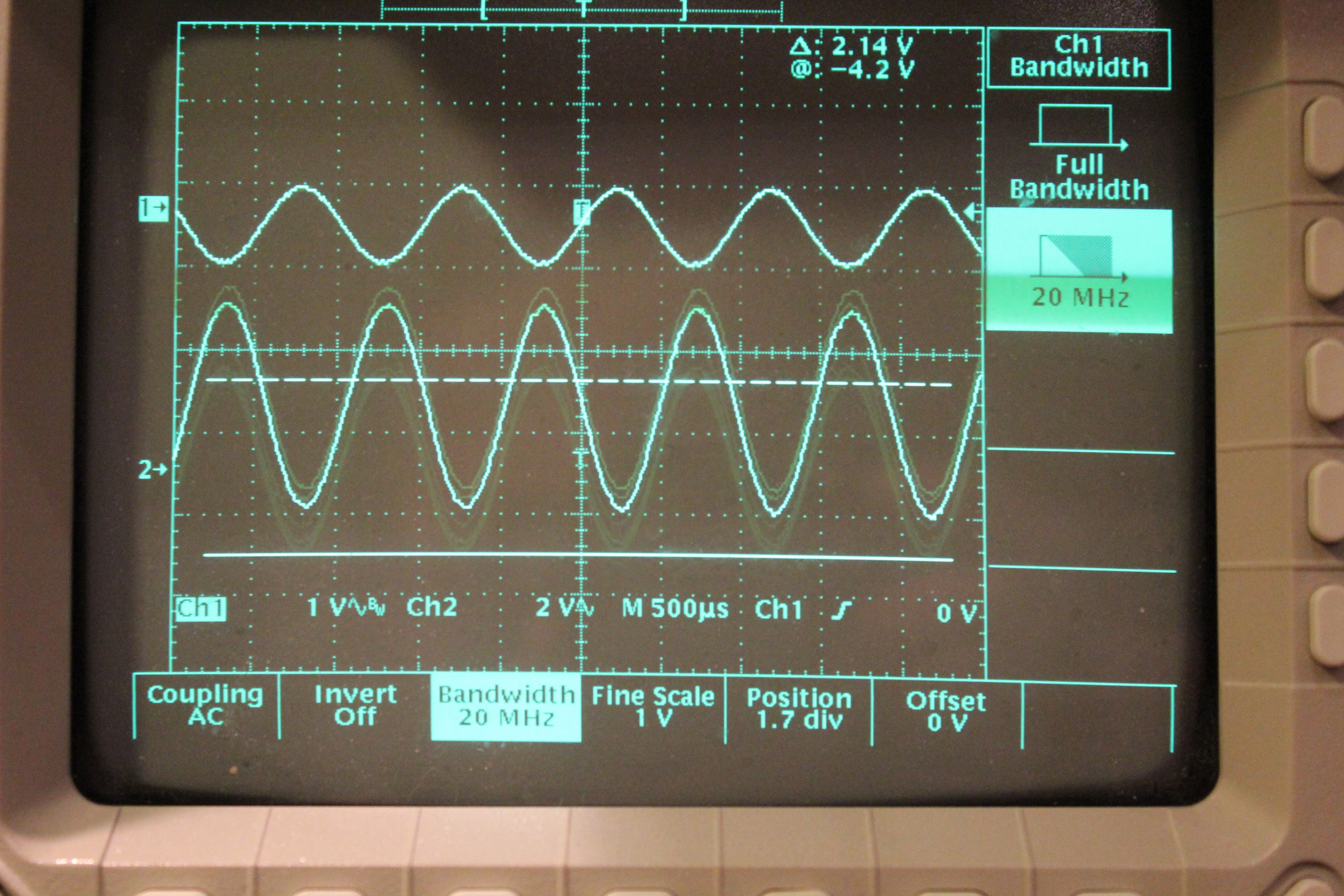

Output is around 3 watts per channel with 2,14 Vpp input signal at 1 kHz with the 1 k fb resistor on 16 ohm taps. All the EL84 grids gets around 10 Vpp.

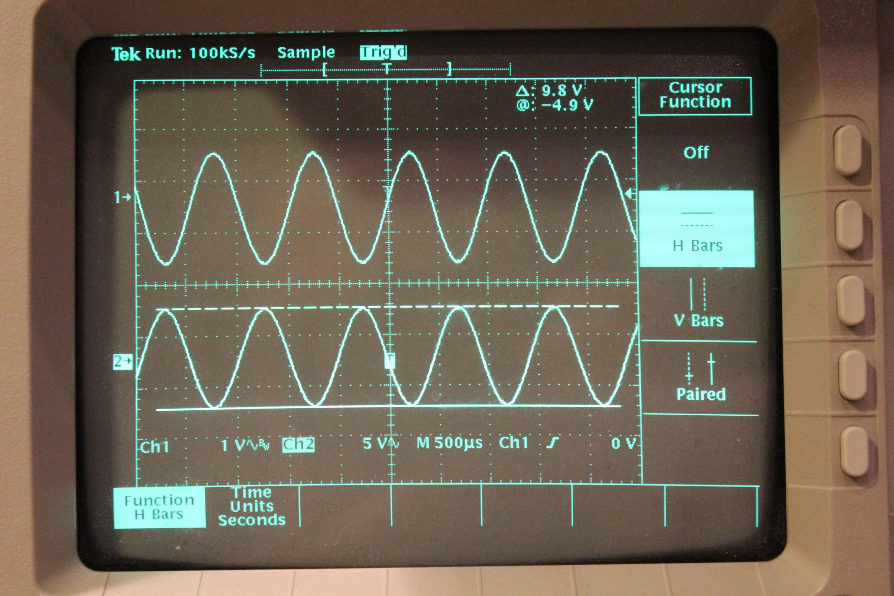

Then I measured a grid that hade a fine sine again and started changing input frequence on my signal generator. Then the that one started to pulsate. Thats clearly the motorboating, I recognised its behaviour. Pulsating around a Hz or a half maybe.
So I changed all the coupling caps to 0,18 mustard drops but that didnt change any behaviour.

And I will share with you that from my viewpoint your last scope-photo (#4) appears to have some mains-frequency in it causing the "jiggles" on the 1kHz sine wave. At least, the period of the jiggles appears to work out to be around 50-60Hz which immediately makes me think "Mains Frequency" for some reason .
It is a reach, especially since I'm not viewing the waveform real-time, but I'll bet the distortion is "walking" through your 1kHz tone - if the jiggles are NOT walking through the 1kHz wave, then the two waveforms are synchronous (locked) together which means it's probably coming from your generator.

Forgot. About the wiggles on the sine in last pic post #92 I was in to that the feedback for some reasons dont work, gets disturbed or something. You can see that the amplitude "strikes through" and gets higher. Just like on startup when the EL84rs not have biased up yet and thers no feedback, then the amplitude is way higher.
Why they get higher in just the "tops", and not the "valleys deeper". I have no idea.

I was curious about the jiggle on the EL84 screen signal so I actually set it up during breakfast this morning and when starting the amp with the first probe on 12AX7 input grid (above gridstopper) and second probe after the coupling cap its all normal. If I move the second probe (I was trying to move it to the other EL84) the jiggle starts. Then I dont seem to be able to get it away.
For me this indicates a bad soldering or socket.
