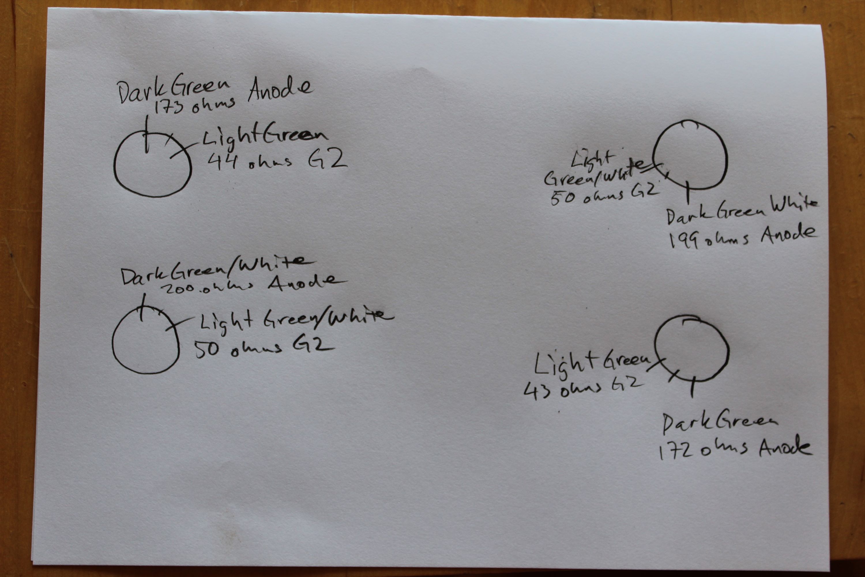

The OPTs are from some SCA-35s i guess, found them in Blommans boat
They have cotton on the primarys and if you have a very bright lamp you can differ between following colours. Dark green (200 ohmish)/lighter green (40 ohmish) seems to be one pair. Zigzag Dark green(200 ohmish) and lighter green/white zigzag (40 ohmis) seems to be the other pair.
Secondaries are worse. The common colour are black cotton, that I have as plus on both, I think 8 ohm tap. Then they have one yellowish (but different in nuance between the two) cotton to. I have that on gnd on both for now. Seemed to be when mounting.
This setup seemed right when mounting them but that was long ago and its been playing nice, exept for when the boating started. Other then that one has an orange plastic and the other is yellow plastic. Those I took as 16 ohmers when mounting them and have had them loose since now.

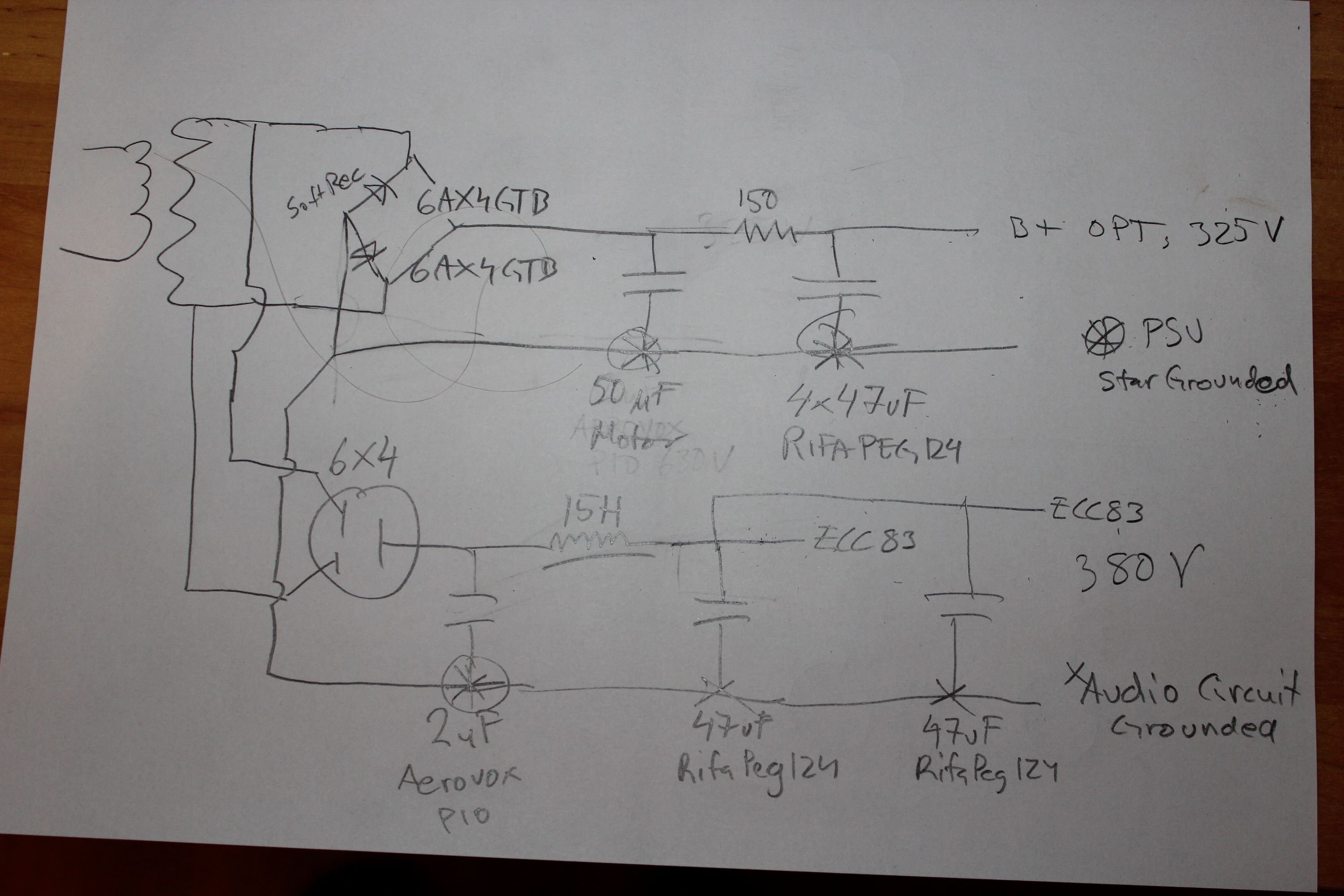

Ground: All audiogrounds stars in one leadstand. Its the one between RCAs and the Circuit. From there a 2 mm copper goes to a stand where all filtercaps grounds connect, plus the graetz return. The exeption is the ECC83s last 47 u:s that returns to audioground (mixed star/follow signal concept).

Other then that I gave it some time a year ago or so when I took it as a grounding problem. I tested various concepts on grounding but it didnt seem to differ. I left it by having the input tubbies with a single 6X5 and the output tubbies have dual 6AX4GTBs (dual diodes). Before that all shared a C-R-C with a GZ34. It made no greater differance, but it was a trial on separating the splitter tubes from the output tubes regarding feeding (RLD inspiration).

Thanks M Gregg. Sorry again fore loosing my temper. I have started to maesure things. Before disconnecting GNF attatched is my config regarding OPT primarys and output tubbies.
I will now disconnect GNF and put 1 k to ground.

Stajo,
If you are not sure about the OP winding..
Test to see which connections give the highest resistance readings..this "Should" be each end of the secondary (OP to speaker)...then you can see what colours you have as the start and end of the winding...

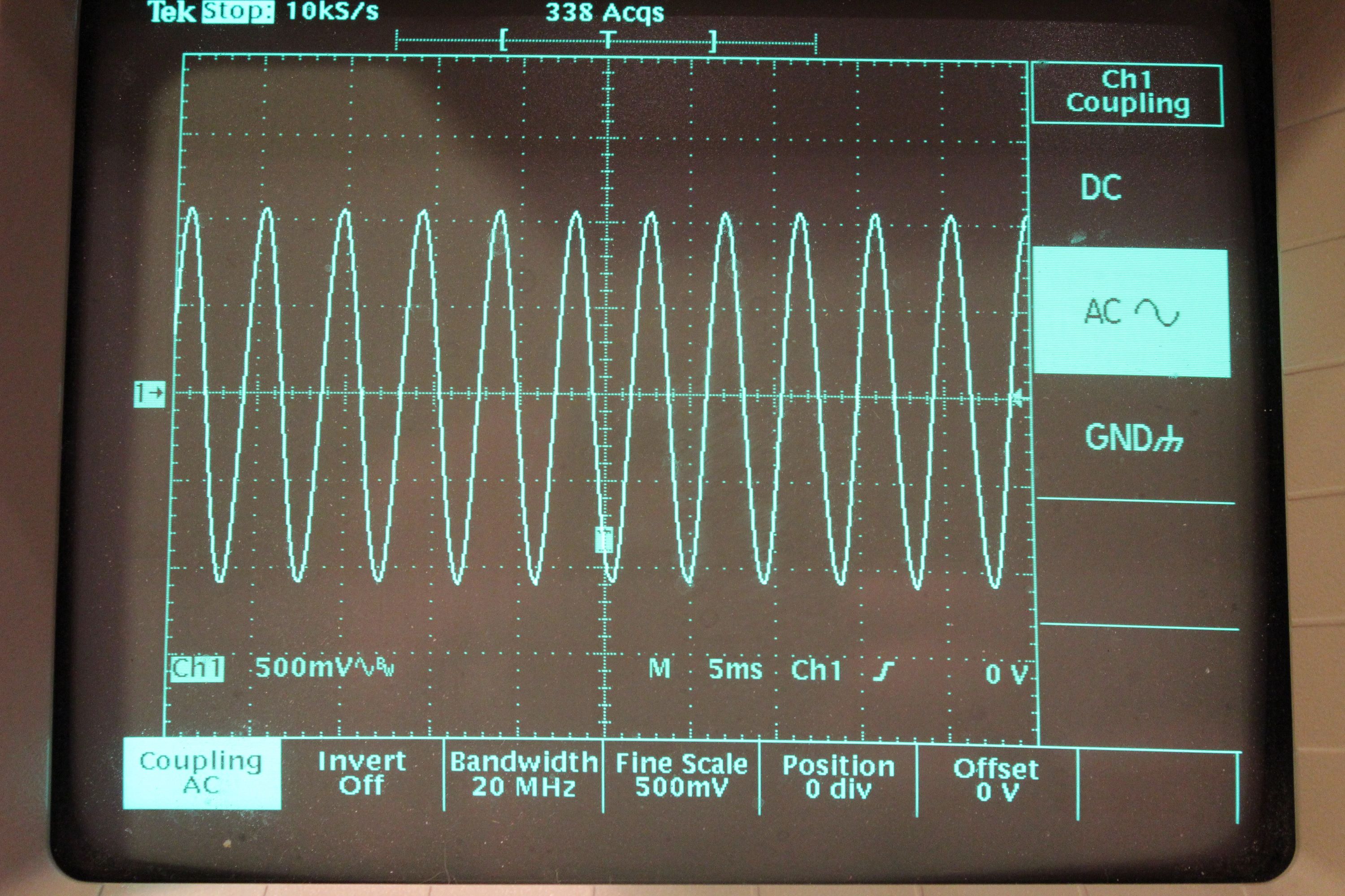

Ok, think my sanity is coming back slowly. Heres a signal from that to the scope. Is it a starter or should I change some params?
The 1 k is now back in line and the returns from that now goes to gnd instead of from the OPTs.

Stajo,
Is the amp stable now?
The next question what about the hum?

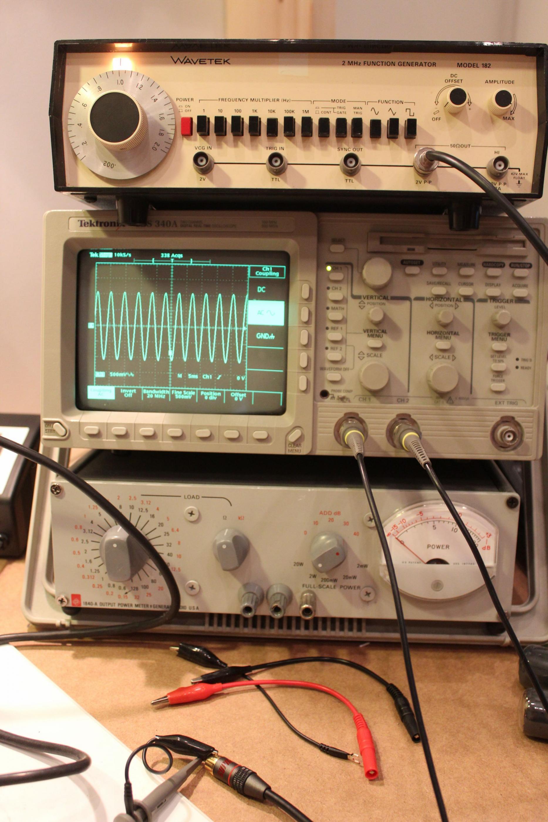

You guys enjoy movies? Heres Wavetek on 100 Hz 2 VPP and the grid on Tex. If I turn on the amp it makes strange noices. I hear the signal w/o speakers

Stajo,
Don't run the amp without speakers you will damage the OP Tx or have a dummy load resistor in place of them

Heaters by two 100 ohm resistors to gnd I beleave atm. Heres http://www.youtube.com/watch?v=22TqAsDRYZQ&feature=youtu.be with some dummy speakers and a PSU scetch reengineerd by yours truly. I Think it matches and hope it makes sence.

A lot of parts makes excellent transducers just hook up a foil cap to an amp if you on´t believe it.
A couple of load resistors is a must when testing.
Or the powermeter set to 8ohm load.
Running an amp unloaded on idle is not recomemded.... but full tilt can cause voltage buildup and arcover in the OPT and then it´s end of story.
Check for phase between input/output.
