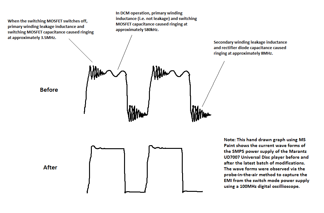

OK, I finally got all the parts yesterday after 3.5 week wait for one part from the U.S. Now I finished the SMPS mod. This last batch of mod put on 17 new passive components onto the existing SMPS circuit, with 5 new components soldered on top of the board and the other 12 beneath the board.
Attached is the result.
Two months ago, when I got the schematic of the SMPS power supply I thought “what the hell was this…”, as I had never seen a SMPS power supply schematic. Now I have got the switching noise of a flyback SMPS down to the minimum, better than all text book examples / datasheets I have seen, while previously the noise was worse than all text book examples I have seen.
The damping of the 3.5MHz ringing can still be a bit better, and that is merely to increase the snubber cap from 100pF to 150pF up to 220pF without taking out the SMPS board. It will be a 1 minute job for me. For that particular snubber, I calculated the capacitor value to be about 500pF for a Q=0.5. However, this is the snubber across the switching MOSFET which means it has voltage swing in excess of 500V. I would much prefer to start from a small capacitance value as not to risk burning the resistor, therefore the initial 100pF was chosen. I am using 6W rated resistance (2 x 3W metal oxide resistors) there. I am confident that by increasing this capacitor value it will completely smooth out the ringing.
Even though all the ringings have now been removed or substantially reduced, I still don’t like the idea of SMPS in audio, especially in line level equipment. Last night I also did some brief direct measurements on the voltages for +/-12V at the outputs of the rectifier diodes. I still saw ripples with over 1V magnitude at the switching frequency of 100kHz. They used to ring for at least half a dozen cycles before dying down, and now it is only one and a half wave. Even so, I imagine with the very quick rise and fall time at 100kHz intervals at the magnitude of 1V the proceeding regulator stages will still have a very hard time removing the ripples completely. I could not measure this because there are no test points on the analogue board for me to do so.
But now with the 580kHz, 3.5MHz and 8MHz ringings all disappeared I suspect that the whole circuit ground is much cleaner than it used to be, with much reduced EMI radiation as well.
