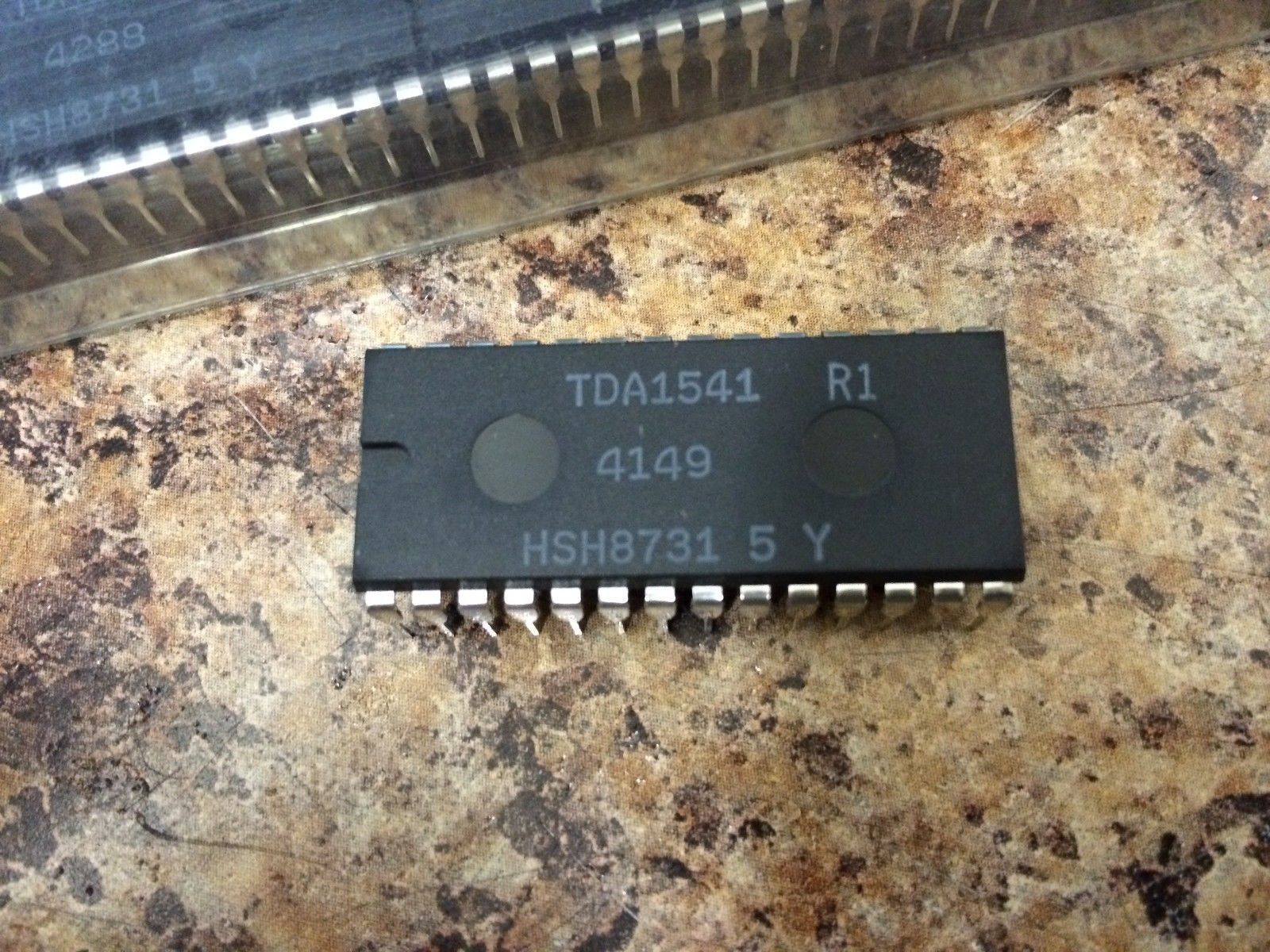

If you want to see a fake one this chip screams fake!
Maybe fake but he's sold 16 so far !!!!!!!

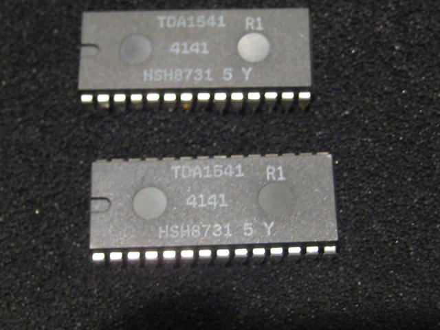

That is a tda1541 non A chip. I have two that I bought about 15 years ago and apart from the date code, they look identical to the one in your picture.
The Made in Taiwan tda1541a in your other post is probably a good sounding chip. Pedja Rogic has mentioned that apart from the S2 version, the 1998 Made in Taiwan tda is the best sounding chip and also chips made in the late 90s often perform better than older chips.
