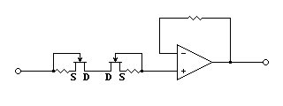

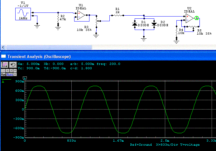

Is this a good way to simulate the sound of tubes??

Simple circuits like those seen above will never sound like a tube amp - unless one replace the solid state devices with tubes.
