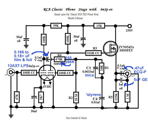

Then build the tweaked RCA setup. :yes: It has the correct 47 Kohm I/P impedance modern cartridges require and the MOSFET buffer deals with driving loads.
This one has a mosfet, and for this project i'm against it. I do have a pacificateur fet preamp that i like and i know fets can do good things. But now i want stricktly tubes, except in the psu where i will use a diode bridge rectifier.
IMO, the FET is superior to a triode, for the buffering role. However, there is no legitimate reason why a DC coupled cathode follower can't be used as the O/P buffer.

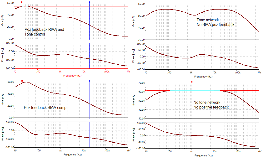

positive feedback for RIAA compensation has been around since the 1950's. hold your breath, they easily become unstable. i built a similar circuit from an AudioXpress article (Titschler, commercial product here: Tritschler Precision Audio Devices, a/k/a TPAD! Brought to you by DoctorCrazyJoe.com and Tritschler Precision Engineering!)
I think the design needs some work, the result from the circuit presented in the first post differs significantly from correct compensation, here are some bode plots with the circuit dissected:

i would like confirmation that it's worth building it as first tube project.
With their good suggestions and also some analysis of the circuit, the knowledgable people responding to this thread are gently telling you that the circuit probably is not a good candidate for a first time build.
My reservations are simple - the output is taken off the plate of the 2nd stage, in addition to a feedback circuit, and the AX7 will be completely taxed in current and will have an extremely hard time driving any cable, a pot and a gain stage after that. Those poor driver characteristics, the possibility of instability due to the positive feedback configuration, and the poor RIAA conformity makes many other circuits a much better choice.
At the minimum, you'll need to add a cathode follower on the output.
My advice is to build the circuit Eli Duttman suggested - it's stable, accurate, known to work, has a large about of builders on the site who can help if you get stuck or need assistance, and I've never read anything other than wonderful success and sound from those who have built it. The Mosfet follower, because it's a follower, is sonically invisible, and will help the circuit integrate into whatever system you choose, as it can drive anything.

I'm going back to the original RCA RIAA scheme i think, and skip the mosfet and replace it with a tube. I found the original scheme, and that looks very good. It's also a proven scheme with lots of info about the technical side. So on that level i follow you. But i want no mosfet or other semiconductor that is not a tube in the scheme. That is not going to change because many like it here. I've red all your discussions about it and i understand why you want it, but it's not what i want as explained above.

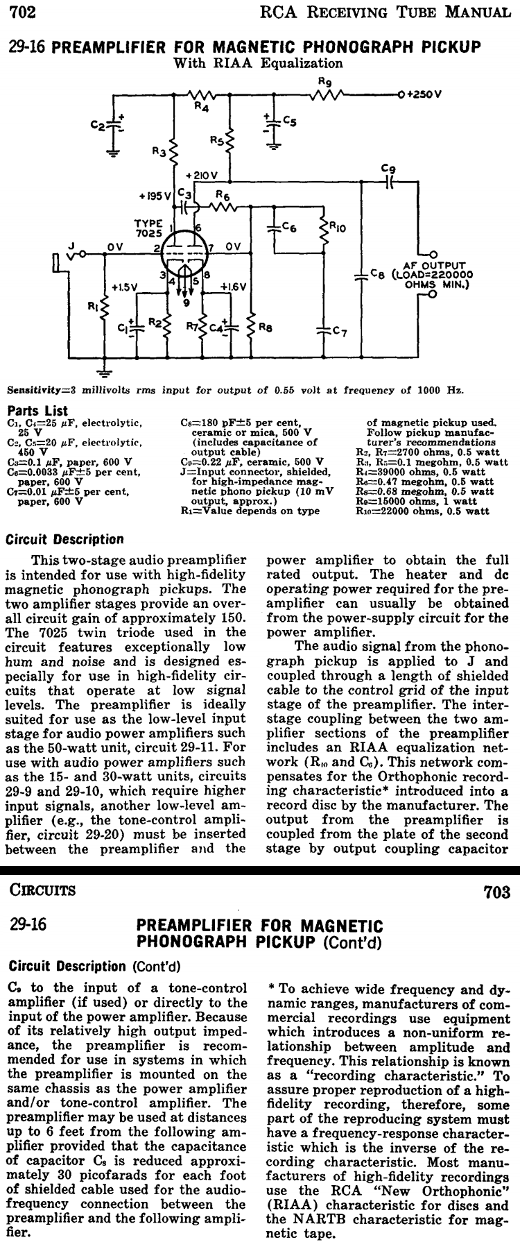

Wel, this is what i found somewhere (diyaudioprojects). I'm still studying the scheme to see if it's right... But i rather want to use a MM cartridge so i need to find out how to lower the gain i suppose... Maybe with replacing the second 12AX7 stage by an ECC82/12AU7 like suggested above.
This phono is made for a MM. Don't spoil a good design !
Have you seen the 150x gain ? With 5mV from the cartrige the output is only ¾volts , what do you mean, lowering the gain ? :confused:
And on an output "minimum load 200000ohm" :(.
