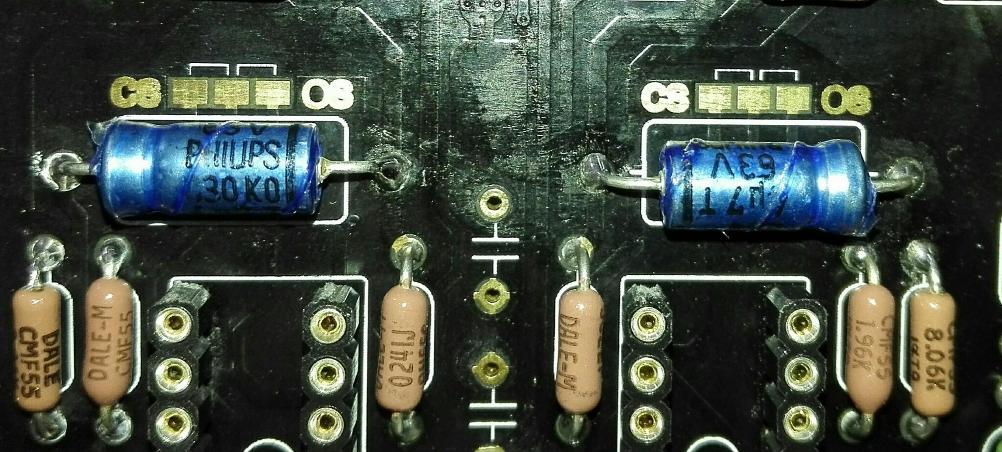

Having recieved this (original post link), I can now say there are four opamps on the board;
2x OP07 (top two)
2x NE5534 (bottom two)

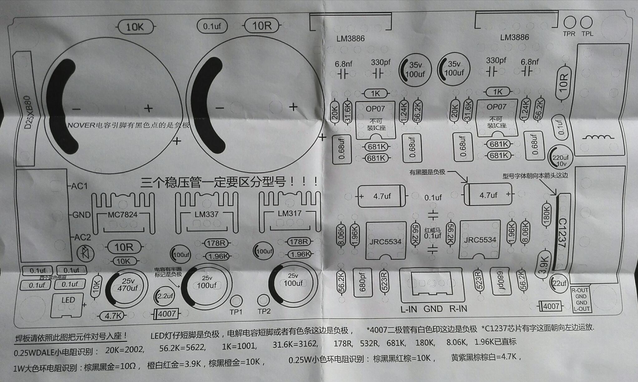

There's no schematic for the kit, only a stuffing guide.
They don't give you much.
I'll guess:

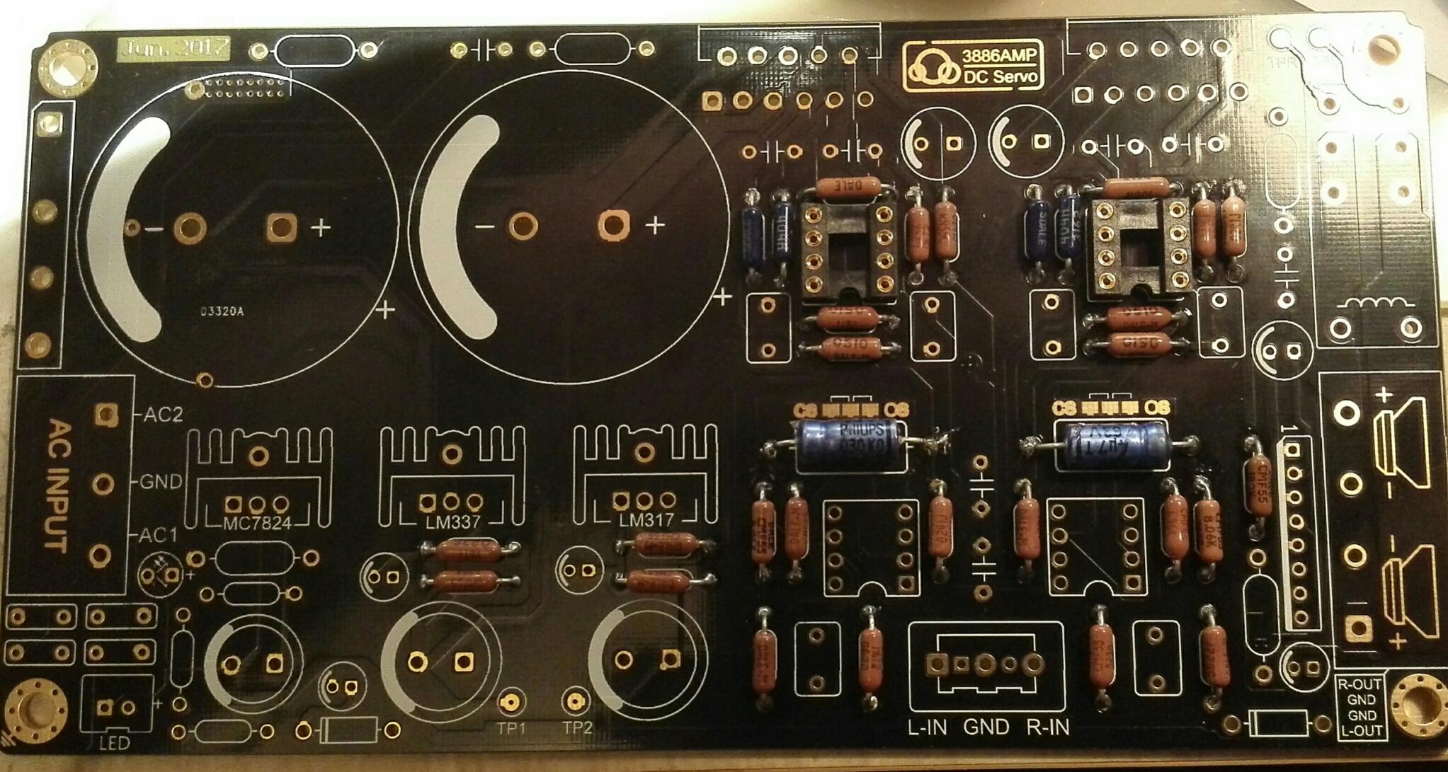

the two op07 have 0.68uF and 681k twice for each opamp. That indicates you may have a non-inverting DC servo for each channel.
Trace out the PCB traces and try to reverse engineer that part of the circuit.
The two jrc5534 have 680pF and 523r. These could be input filters to attenuate RF interference. The 4u7F polarised caps could be DC blockers between the stages. reverse engineer this section.
The components along the right hand edge are associated with detecting faults and protecting the chipamps.
The 317 & 337 have 178r + 1k96. These look like voltage settings for the regulators giving ~ +-14Vdc.
find out where the 24Vdc from the mc7824 is going. reverse engineer this part.
The four 0.1uF look like caps across the rectifier. If so then you do not fit them. Reverse engineer this part.
