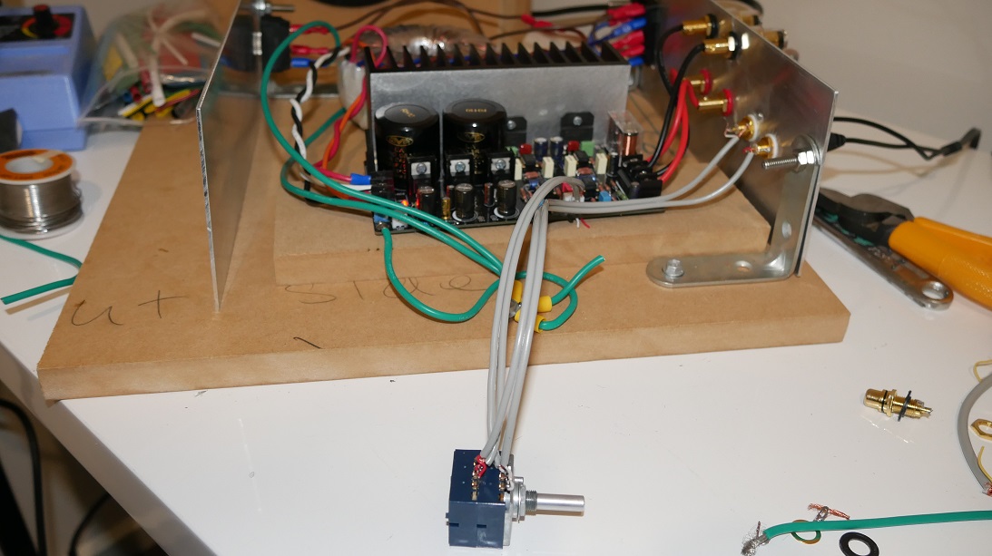

Maverick, back to correctly installing your amp. Near the fan connector on the amp board, you can see a chassis/ground symbol for the mounting hole. This is where the amp should be connected to the chassis. Connect the mains PE to the chassis and if available the transformer shield should also be connected to the chassis. All the other chassis connections are wrong and should be removed.

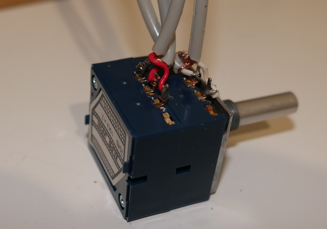

Ok thanks I will give it look tonight. I like the idea of extending the pot, but it will take some engineering.
I patched in the 10k ALPS Pot as per picture, thanks.
I used single core shielded wire.
Its a rough solder job but it works. Is there some special connections or something that will look neater for connecting the pot also the 3 pin (L-G-R) input onto the board where can i find a plug like this?
The his has gone and no issues at all. I will now revisit my grounding points now.

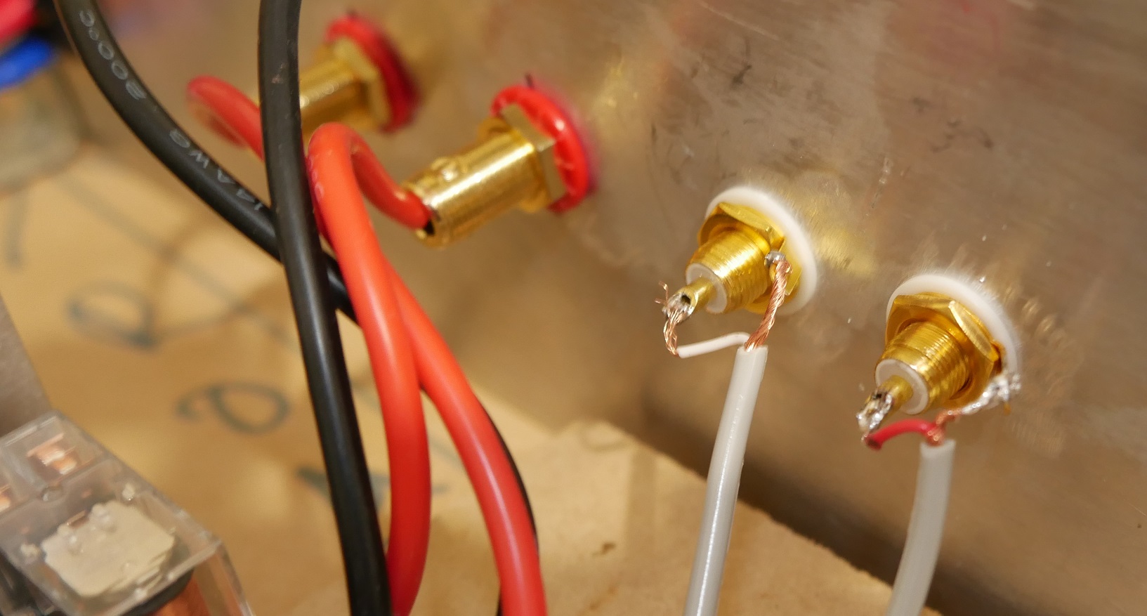

Maverick,
the core of the screened cable is exposed where you have stripped back the screen/shield.
This termination has a big loop area.
You can improve this a lot.
Strip off a bit more outer insulation and screen to make a longer pigtail.
Shorten the core to leave the minimum sticking out from the screen.
Attach that core on to the Hot terminal. Add some insulation around that terminal.
Now run the pigtail along side the hot terminal almost touching the core&terminal.
Solder the pigtail to the end of the threaded shield. If you pre-solder that end it will be easier to attach the pigtail. Make the LOOP AREA between the very short core and the shield wiring as small as possible.
This minimises interference.
Repeat this low loop area termination at every two wire signal connection, even speakers and PSU need this to minimise EMI.

Im confused, do you have photos? Thanks

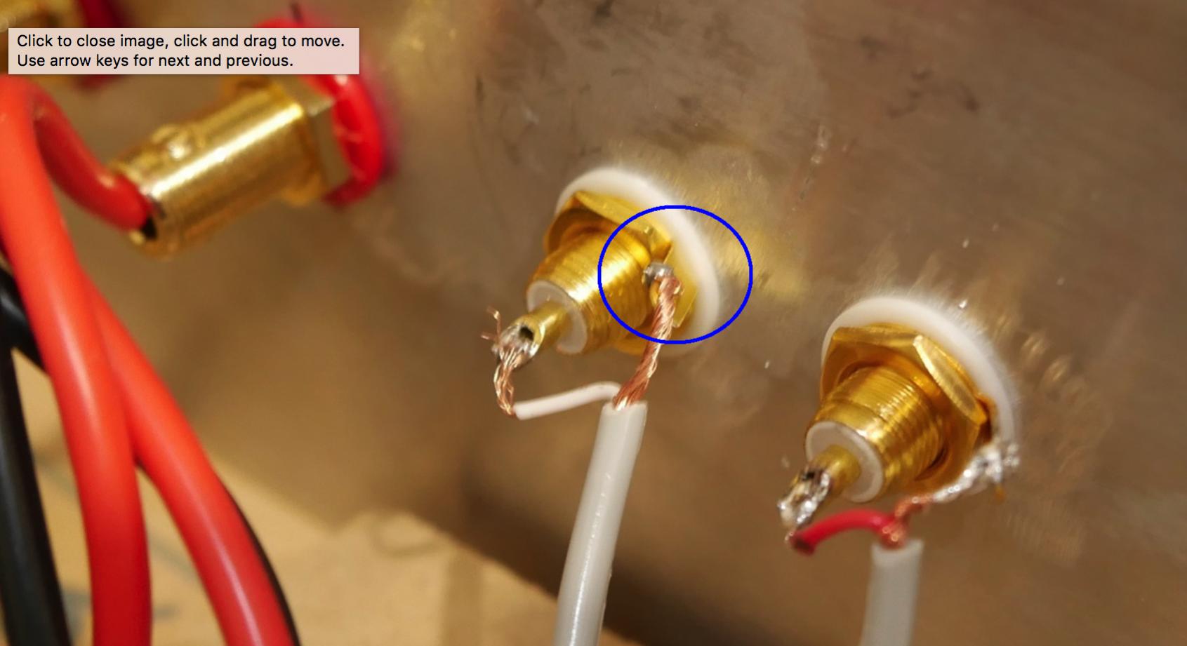

I dunno Andrew. It's hard to get it much tighter than what Maverick's done. You might be able to reduce the loop a bit by letting the centre conductor exit straight from the cable jacket and bringing the shield to the solder lug as close to the centre conductor as possible (insulate with heat shrink tubing). I'm pretty sure any improvement that's obtained there is firmly below the 0 dBGF reference level. That's dB relative to one imperial Gnat Fart. :)
The shield on the white RCA connection is barely hanging onto the solder lug, though. That's a bigger issue. If that lets go, the amp could do nasty things to the speaker. I'd fix that. Get some heat into that solder lug.

I was referring to the wiring around the RCA jack being about as tight (tidy, short, neat) as can be. Not the nut on the RCA jack.
The solder joint to the grounding lug on the white side is my concern.
Tom

So should i feed the shield earth through and twist then solder? Then have enough wire expose to loop around to the rca pin?
Whats the best way to connect the pot with wires? Im thinking if using a blank universal pcb and cut it down.

Here's my procedure:
1) Start by draping a piece (20 mm) of heat shrink tubing over the coax cable.
2) Strip the coax cable so you have about 25 mm of shield showing. Unbraid the shield and twist the strands together.
3) Drape a small (5-6 mm) piece of heat shrink tubing over the shield and shrink it using a heat gun.
4) Cut off about 12 mm of the centre conductor.
5) Strip the centre conductor so you have 4-5 mm of the copper strands showing. Twist the strands together and tin them.
6) Feed the shield through the hole in the grounding lug and solder the centre conductor to the centre of the RCA connector. Then solder the shield.
7) Slide the heat shrink tubing applied in Step 1) so it drapes over the end of the coax outer jacket. Shrink using a heat gun.
This is the best image I could find. You want the shield and centre conductor to run parallel for as long as you can with as small a gap between them (the small loop area that Andrew talked about) as you can.
Tom
My wrong use of language, sorry.
Correct: "I used two extra NUTS to bring the "cold" solder tag back to the end of the threads" (tightened between the two nuts)
This way, just a couple of millimeters separated it from the hot pin, allowing for really tight, neat and safe wiring
Interesting approach. I think that's a bit overkill, but if it makes you happy... :)
Tom
Tom,
Your approach is pretty neat, but you use a different type of RCA jack which allows it to happen.
With the ones Maverick uses, pictured in your post #70, what do you do? You bring that return contact right at the back, and bend it parallel to the hot pin. Then proceed as you described.
