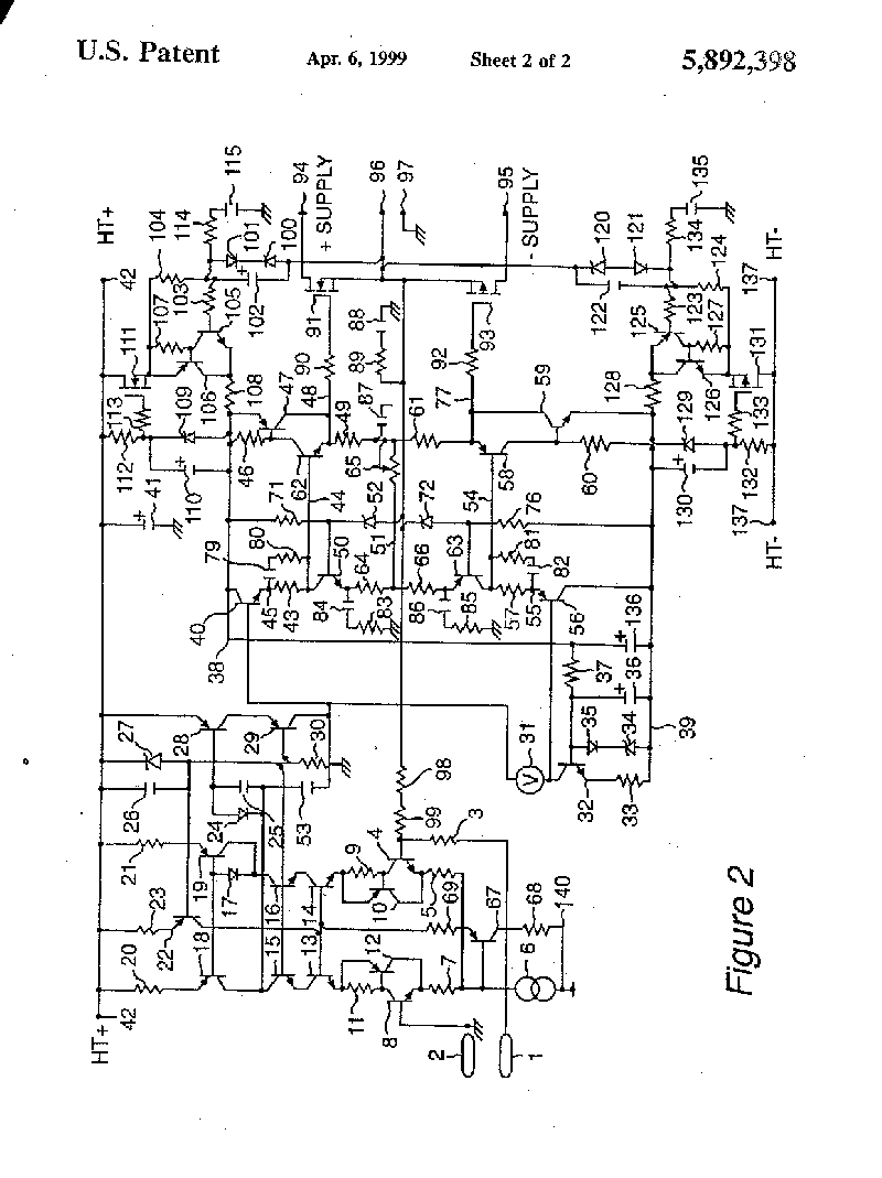

The Halcro also uses the error correction technique. I tried looking at the schematics at http://patft.uspto.gov (which I was able to do a few months back) and seemed to be having browser or site problems.
Andy,
I think I know the patent you are referring to. It's probably 5,892,398 from Candy. I have a copy, but have not yet studied it in detail. It's dated 1999!
Another similar patent is from Iwamatsu, dated 1984, number 4,476,442.
So, all are of later date than Hawksford's publication in the JAES.
If you experience trouble with http://patft.uspto.gov you can use the European patent site. E.g. the one from Iwamatsu:
http://l2.espacenet.com/espacenet/viewer?PN=US4476442&CY=gb&LG=en&DB=EPD
and the one from Candy:
http://l2.espacenet.com/espacenet/viewer?PN=US5892398&CY=gb&LG=en&DB=EPD
Don't forget to put US in front of the number for US patents if you are searching for a number and separatores are not needed (allowed?). A nice thing of this site is that you get the pages as pdf instead of tiff. Too bad it is only one page per pdf file so you end up with a lot of separate pages and need some Adobe program to stitch all pages together.

4) The error correction circuit published by Hawksford is also a feedback circuit. The loop is typically just around the output stage, so it is shorter than a "global" feedback loop, but longer than the loop of a CFP. The twist is that there is gain in the *reverse* direction of this loop. This technique was first used (to the best of my knowledge) in the early Quad solid state amp that they called the "current dumping" circuit (I forget the model number). It was also used in the "Trans Nova" circuit that Jim Strickland did for Acoustat and later Hafler. However, the Hawksford paper formalized this approach, explained it, and made it easy to adapt to existing output stages.
(By the way, Bruce Candy of Halcro lied through his teeth when he (or some representative from his company) first claimed that his amp didn't use error correction. As anyone who has looked through the patent knows, this circuit is simply an adaptation of Hawksford's error correction paper.)

Thanks for the patent reference. I will look there to see if I can find the Halcro schematics.
I wasn't trying to say that the circuit wasn't stable. In fact, I said
If I overcompensate it so it's stable with both, I get no improvement in 20 kHz harmonic distortion over the uncompensated design
I really should have said "over the non-error-corrected design", so my choice of words was not very good there.
Though I didn't look at it, I'm quite sure there would have been an improvement in low-frequency distortion with the circuit when I compensated the error-correction loop for good transient response with both resistive and reactive loads as mentioned above. However, that wasn't what I was looking for in my specific design. That design has plenty of loop gain at the lower frequencies, but it had only about 14 dB of feedback at 20 kHz though. So I was looking for the error correction to improve the distortion at 20 kHz by about 20 dB. I wasn't able to achieve this while meeting the "no overshoot or ringing with a 2 uF load" requirement (which is tough to achieve). The design does seem to be easier to tame with a small number of output devices. For the high-power case with many parallel output devices, it got pretty sensitive.
